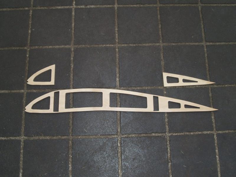

old man emu Posted March 1, 2011 Author Posted March 1, 2011 Thanks for the link to homebuilts. A handy reference. This discussion has gone off on a tangent when it discusses solid core wings etc. What I wanted to do was to cut ribs from 10-12mm thick sheets of this material. The original plans call for the ribs to be constructed from 1/8 x 1/2 sitka spruce. I was going to cut them from 1/4 hoop pine ply, then I found this stuff and was wondering if it would be lighter, but just as strong as ply. Here's a picture of a plywood rib that I had cut as a proof of concept piece. OME
Gnarly Gnu Posted March 1, 2011 Posted March 1, 2011 I reckon ply would be stronger and cheaper but then I'm not familiar with the Celuka product (which has the obvious advantage of moisture tollerance). The obvious answer is, rather than relying just on product data, knock up a handful of ribs in each material and load them, stretch them and generally tear them to bits whilst measuring the force used.

Deskpilot Posted March 2, 2011 Posted March 2, 2011 I suppose that I should have added that the main spar is 3-7/8"x 1" sitka; the rear spar is 3" x 1" sitka and that every fifth rib is a compression rib which has a solid pieces of 3/32 ply on each side. The chord length is 36". Ribs are on 12" centres. My humble opinion, I would only lighten the foam ribs by cutting circles and not go too close to the edge. A variety of sizes will take out a lot of weight and leave a good web with no 'in line' weak points. Personally I would use more ply strengthen ones as well. What you've described is one every 5 feet. That's too far apart for my liking. I would aim for 4 feet or less but as others have said, testing is the only way to prove your concept.
