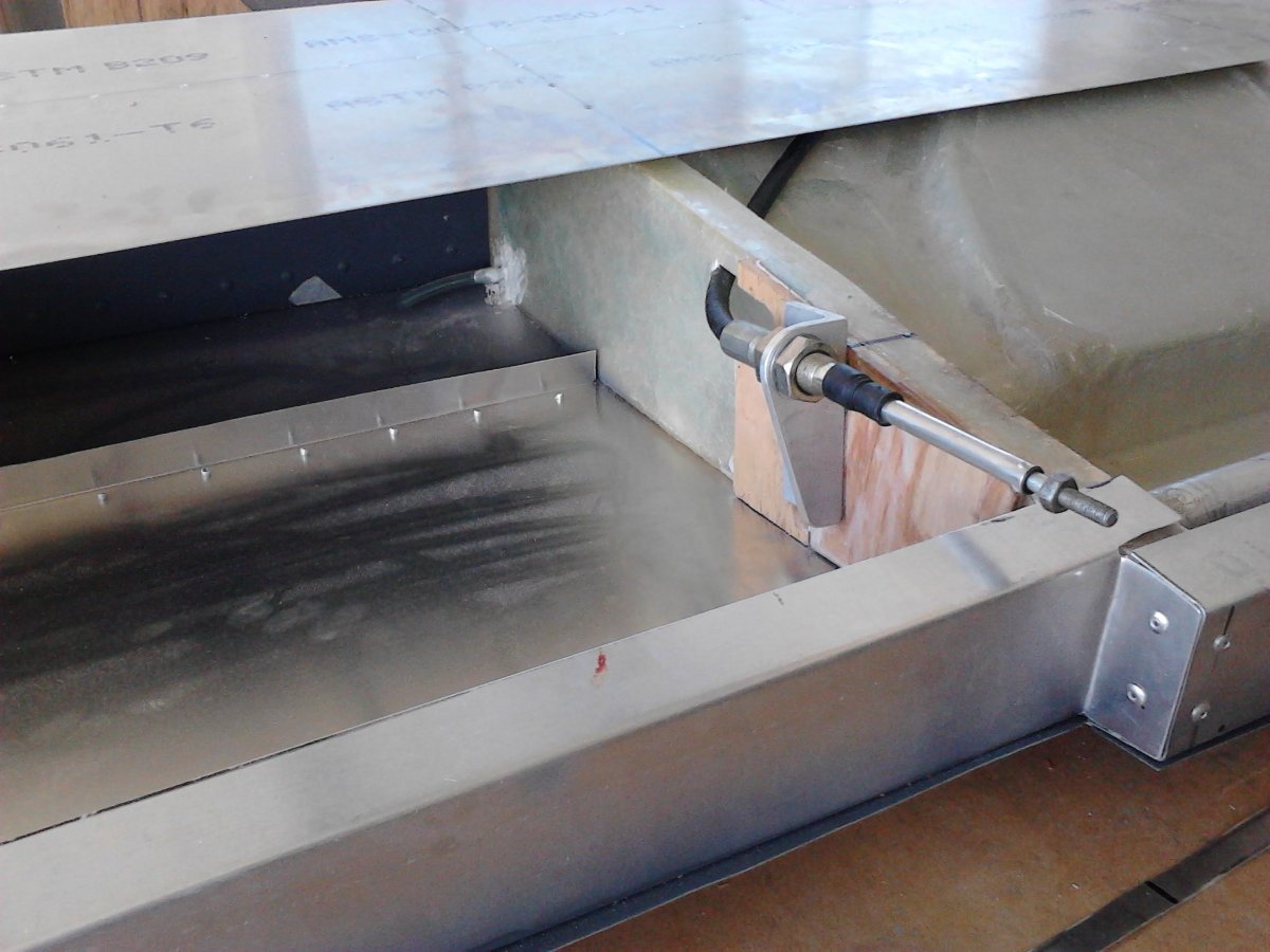

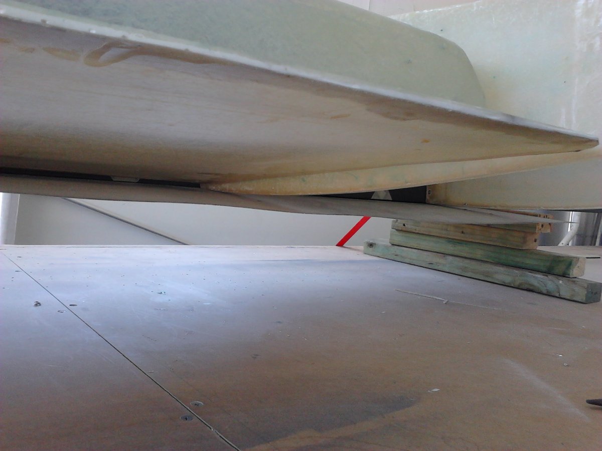

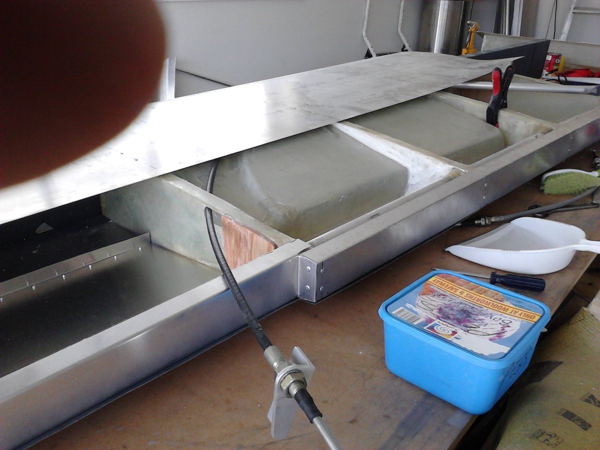

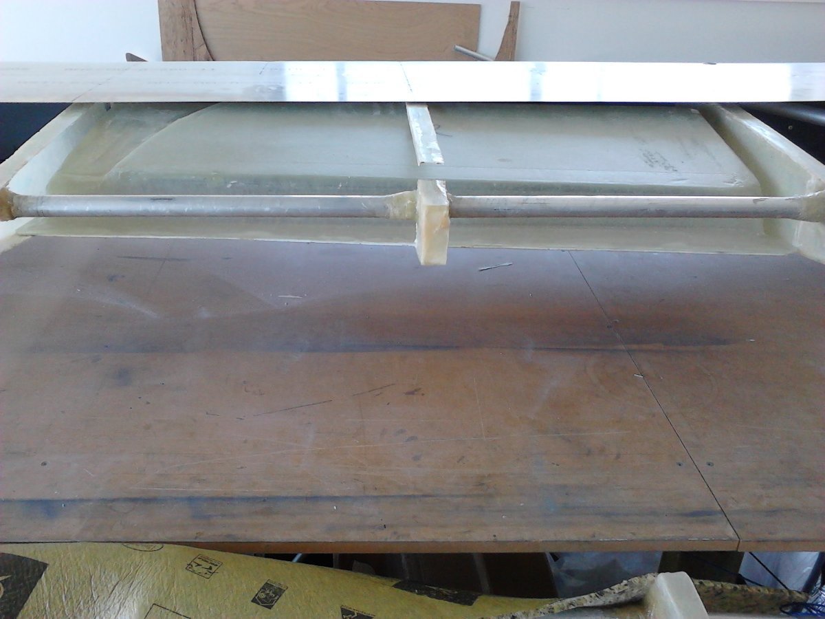

kgwilson Posted May 9, 2023 Posted May 9, 2023 I put Wing tanks in my S100. They are 35 litres per wing with 100 litres in the main so provides excellent range with the 3300a engine. Photo 1 is looking at the bottom of the tank after initial installation. Photo 2 shows the flap cable routing around tank bottom. Photo 3 shows flap acble installation complete & photo 4 is the top of the tank
