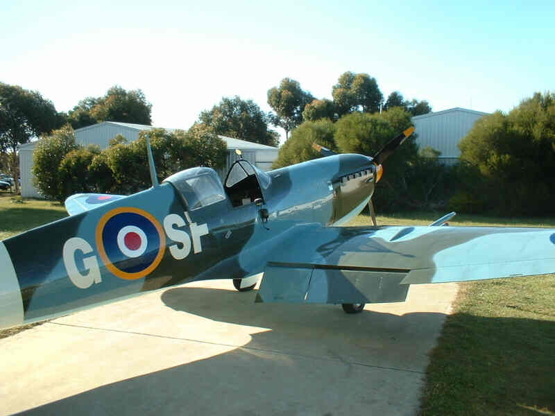

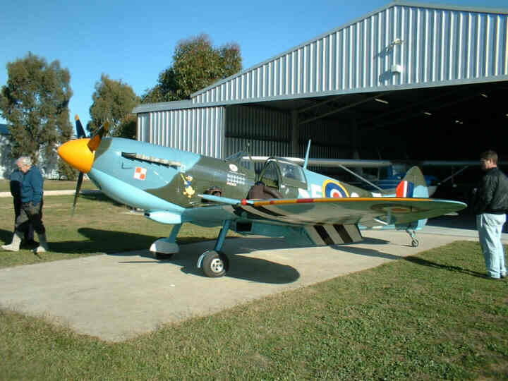

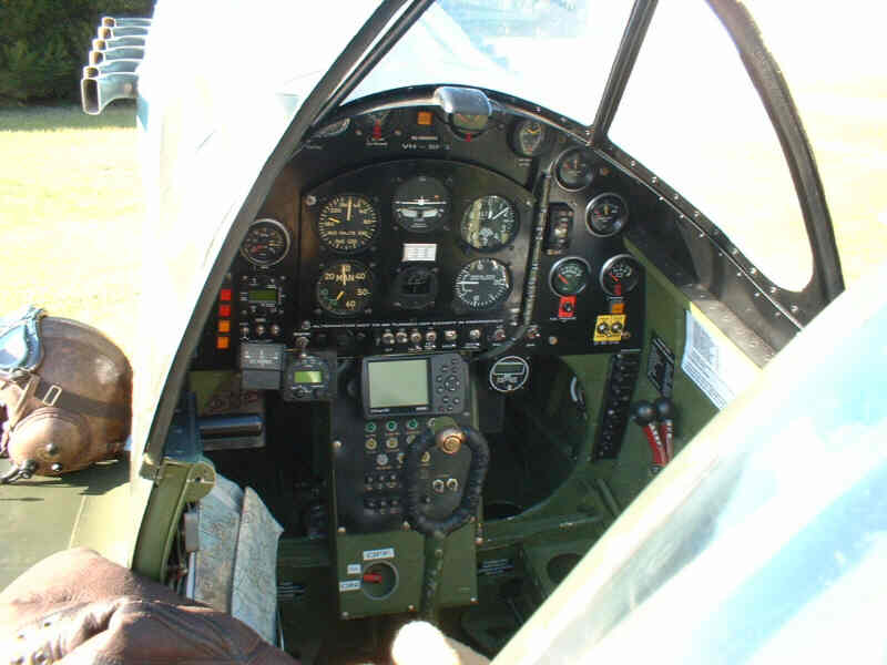

This is the one I saw at M.B,
[ATTACH]13119.vB[/ATTACH] [ATTACH]13120.vB[/ATTACH] [ATTACH]13121.vB[/ATTACH]
This is the one I saw at M.B,[ATTACH=CONFIG]20406[/ATTACH] [ATTACH=CONFIG]20407[/ATTACH] [ATTACH=CONFIG]20408[/ATTACH]
