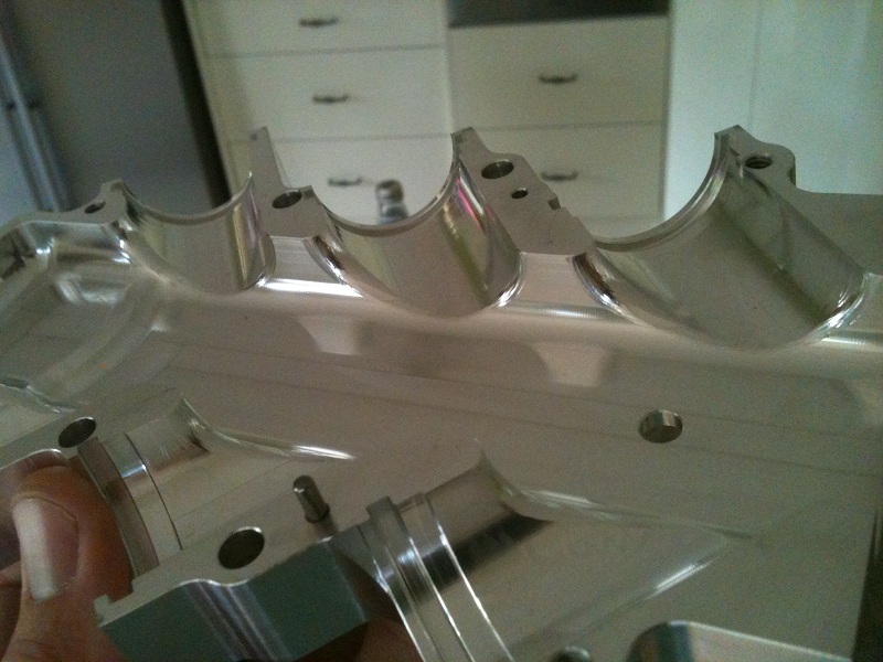

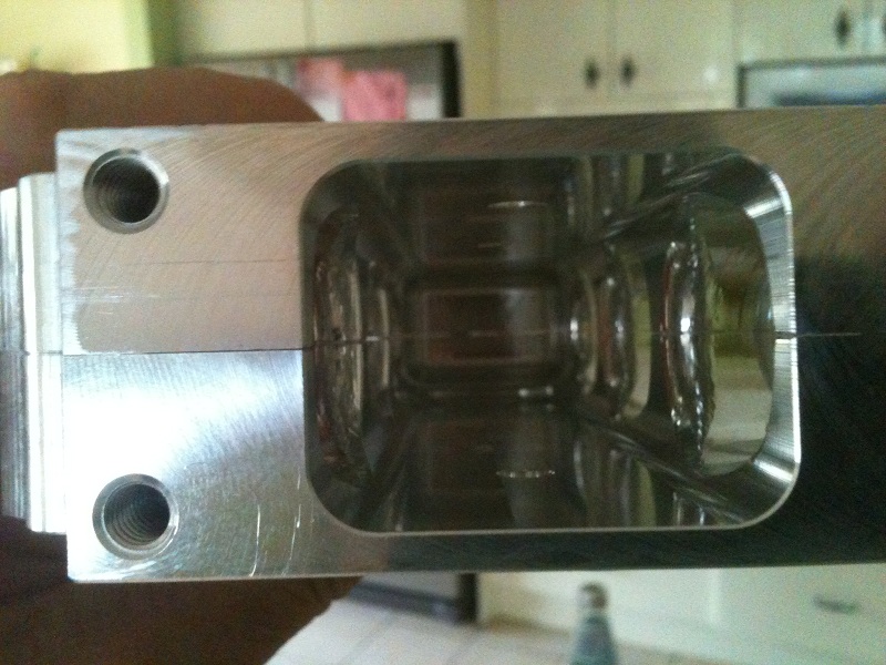

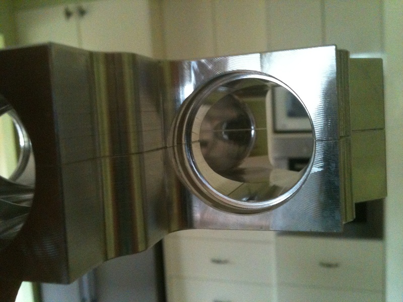

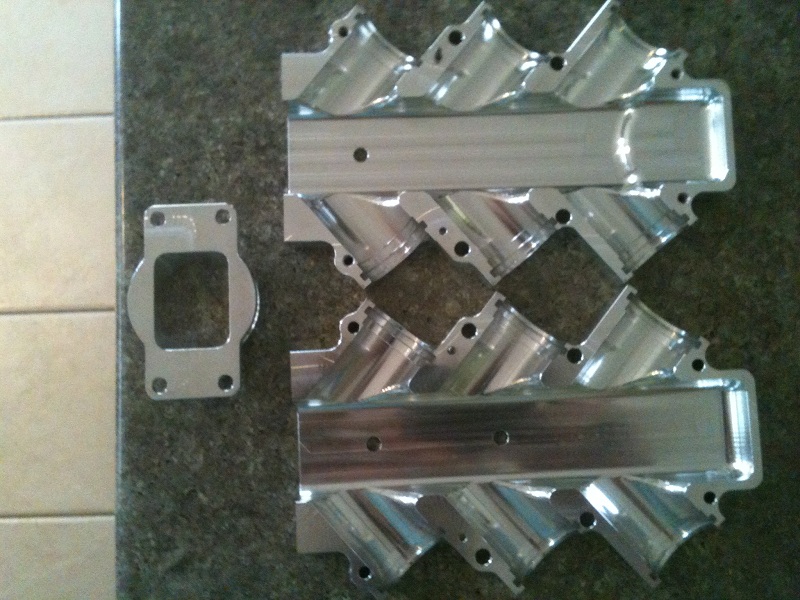

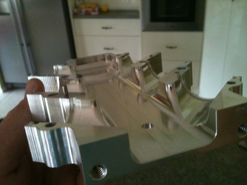

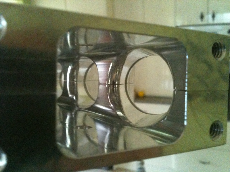

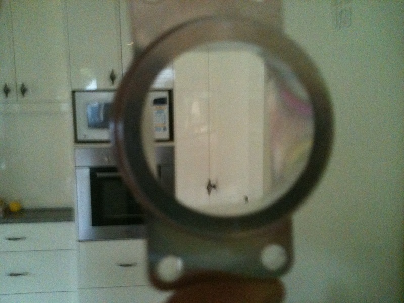

deadstick Posted March 14, 2011 Posted March 14, 2011 Has anyone seen the new 3300 manifold? I am chasing an image to see what has changed, as during a discussion the Jab rep at Avalon he stated that Rod was seeing even EGT spreads across the board and CHT's within a b's DK of each other so whats different?
JabSP6 Posted March 14, 2011 Author Posted March 14, 2011 Deadstick I haven't laid eyes on the new manifold yet mate but a good source at the factory tells me that they are still not seeing even EGT's across the board with this new manifold. This is why they have not released them yet. In fact they are now experimenting with a cross in the inlet manifold which has been documented on other jab sites to try to improve the spread in conjunction with the new manifold. They are trying different lengths and different positions to come up with a fix. We will have to wait and see i guess. Cheers SP6
jetjr Posted March 14, 2011 Posted March 14, 2011 Talking to them late last week, the cross is still the best fix they have. "It may go into production models shortly" It will be fitted in the outlet of the air cleaner housing, needs to be ~ 25mm long This has been experimented on for some time there. Theres nothing new here, even this solution is a "maybe" fix. Jab Ok to admit they havent solved the issue completely yet but this might help.

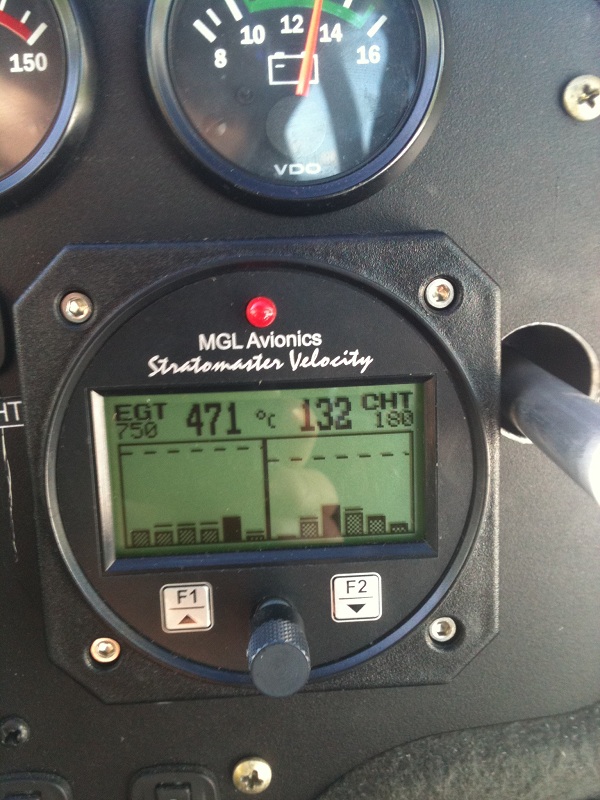

Modest Pilot Posted March 19, 2011 Posted March 19, 2011 An unexpected increase in manifold pressure turned out to be a minute crack in the tube at the take off point. It's located right under the butterfly valve. Interestingly the EGT spread narrowed to 10-15F, with a minute increase in overall temp's. Jabiru think it maybe turbulance create on the opposite side of the carb from outlet of the atomizer. It gave a constant 3" less reading accross the cruise/climb range. Jab are still working on the new manifold at this stage you will likely need new or modified inlet pipes to fit it.
facthunter Posted March 20, 2011 Posted March 20, 2011 i would suggest that they are right. Extra turbulence gives better atomisation/ evaporation, and your mixture spread reduces. Nev
Vev Posted April 10, 2011 Posted April 10, 2011 Hi Deadstick, Many thanks for posting ... I have heard good things about it and hope it delivers all that is has promised. I am curious what if anything they have done with divider aerofoil in the plenum chamber, has this been changed too? Will you be making the carby mods as well? Cheers Vev
jetjr Posted April 14, 2011 Posted April 14, 2011 I assume this needs new intake tubes too? Looks expensive, suprised they dont have flow straightener incorperated?
Modest Pilot Posted April 14, 2011 Posted April 14, 2011 Hope I'm wrong but the plenum chamber still looks on the small size. My J230 is updated as follows: 290 needle jet and new needle to match, flow straightner, and the biggee 3/16" equalizer vent and 3mm emulsion tube holes. The latter brought the EGT range down to 650-680 F at 2800 rpm 20" MP and 23lt/hr with a Senesnich 56" pitch prop. at 2000' and 23 deg OAT. T/O really gets up and goes @ 42 lt/hour F/F and even lower temps. Had to reset the idle down from a little over 1000rpm; Seems smoother from 850 rpm-3300rpm than before. Starts going rough below 800rpm. So unless the new plenum offers a huge improvement I think that wraps up my tuning efforts for a while.
facthunter Posted April 14, 2011 Posted April 14, 2011 The EGT spread will be the crucial test. I can't see the principle in the design myself. All I know is practically every engine that feeds a single carb into any simple manifold has giant trouble getting mixtures even. I wish them luck as there is obviously a lot of effort expended in producing it. Nev
