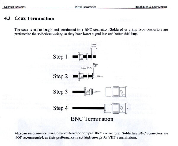

Knighty Posted February 26, 2007 Posted February 26, 2007 Hello Forum members Can anyone give me a diagram/info on the proper instalation technique of the screw in type that is used for our VHF radios. Dick Smith's supply them by the bucket loads but cant give me any information other than the price. Thanks Knighty Â

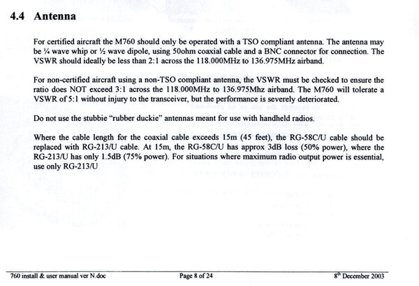

Ross Posted February 27, 2007 Posted February 27, 2007 Hi Knighty See attached jpg file. More readable as is now four files.     Â
Knighty Posted February 27, 2007 Author Posted February 27, 2007 Thanks for the info guys, I will be right from here. Ross, you have won this round as your thumbnail explains the go in plain English and Microair demonstrates the same connection as the ones DS supplied me with. Safe flying fellas. Knighty Â
