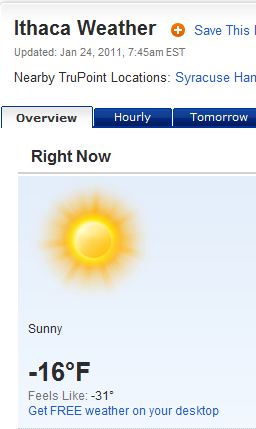

Guest markfnkl Posted January 24, 2011 Posted January 24, 2011 Thanks, FactHunter and JabSP. You both mentioned the jet size, and you may be onto something. In fact, a while back I did have the jet size decreased because I was burning more than the reported normal GPH. My fuel burn did improve significantly, but perhaps it is causing the current problem. By the way, the temperature here as I write this is . . . -26C!![ATTACH]12947.vB[/ATTACH]
facthunter Posted January 24, 2011 Posted January 24, 2011 Get rid of those lean setting jet and needle. Jabs don't like lean mixtures. If you have run them for long check leakdown (valve seating). Nev
Relfy Posted January 24, 2011 Posted January 24, 2011 the -26c is chilly but the 'feels like -31f' (-35c) listed at the bottom is downright scary! As FH said, the lean burn jets etc on the jab motor are the cause of a lot of other problems down the track.
