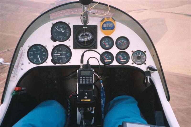

Guest Crezzi Posted January 8, 2011 Posted January 8, 2011 I did a fair bit of flying in S hemisphere in a trike from N hemisphere - even in straight flight at constant speed the compass dip is quite noticeable. Attached photo from near southern tip of Africa [ATTACH]12838.vB[/ATTACH]
