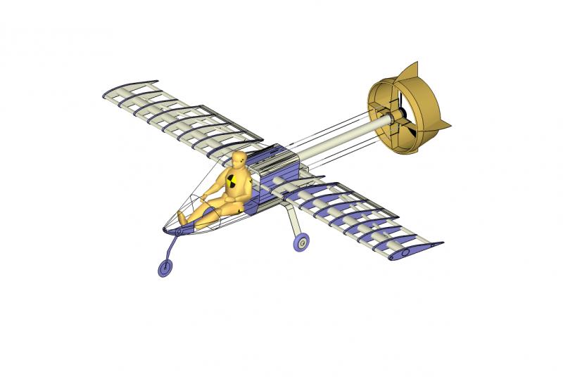

Deskpilot Posted January 3, 2011 Posted January 3, 2011 I've been following a thread called 'Ring Tail' on HBA in the states and have added my comments and design mods. Just as a point of interest, what do you think, would it work. I've modified my original DeMansfield Bolt design. If you're not sure what I'm getting at, the whole ring-tail assy pivots in 2 degree of freedom, and yes, the prop is in there, also pivoting.
facthunter Posted January 3, 2011 Posted January 3, 2011 Probably a concept thing. You would need a CV joint in the drive and there would be some "funny" gyroscopics, I imagine. Nev
Deskpilot Posted January 3, 2011 Author Posted January 3, 2011 Probably a concept thing. You would need a CV joint in the drive and there would be some "funny" gyroscopics, I imagine. Nev Yes and yes. Originally I had the CV or UJ at the mid prop position to eliminate as much gyroscopic effects as possible but later had to move it in front of the prop to facilitate a swash plate. Still, it intrigues me.
fly_tornado Posted January 3, 2011 Posted January 3, 2011 have a look @ the vector thrust RC planes. they are fixed fans and the nozzle moves on 2 axis. the problem with your design is if the CV joint fails that will leave the aircraft really unstable.
facthunter Posted January 3, 2011 Posted January 3, 2011 I see a problem with tip clearance. The efficiency would diminish significantly if the gap was excessive. Having relative motion of the prop or the "ring" would require a fair amount , would it not? Nev
Deskpilot Posted January 4, 2011 Author Posted January 4, 2011 The idea is that the prop and duct move as one assembly. Therefore there's no change in tip clearances except any from duct distortion should it be too flexible. As to the whole assembly breaking free of the aircraft and the resulting dive into the unknown, I'm working on a double, but 'hinging', connection, to be sure, to be sure as the Irish might say. It will probably end up being too heavy but the journey is keeping me off the streets. Stay tuned and remember, think outside the box.

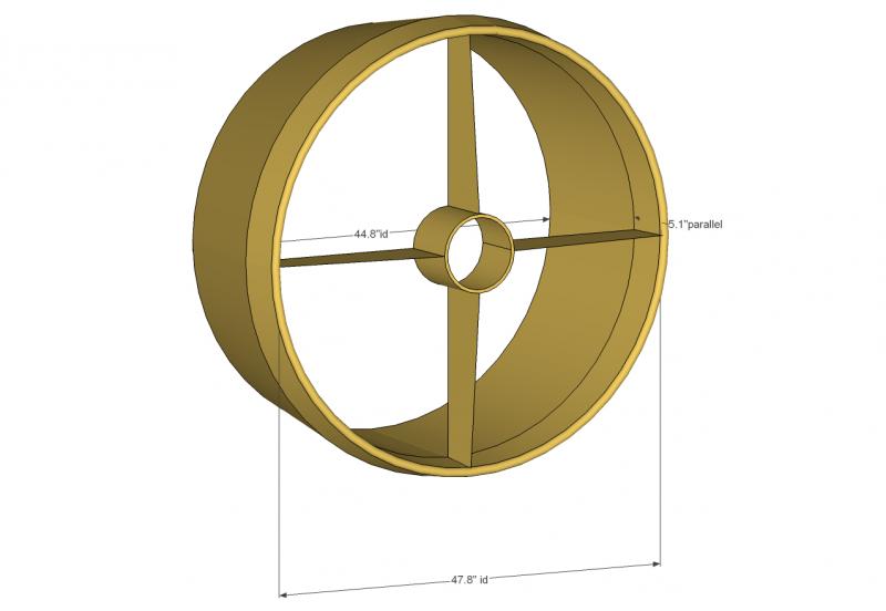

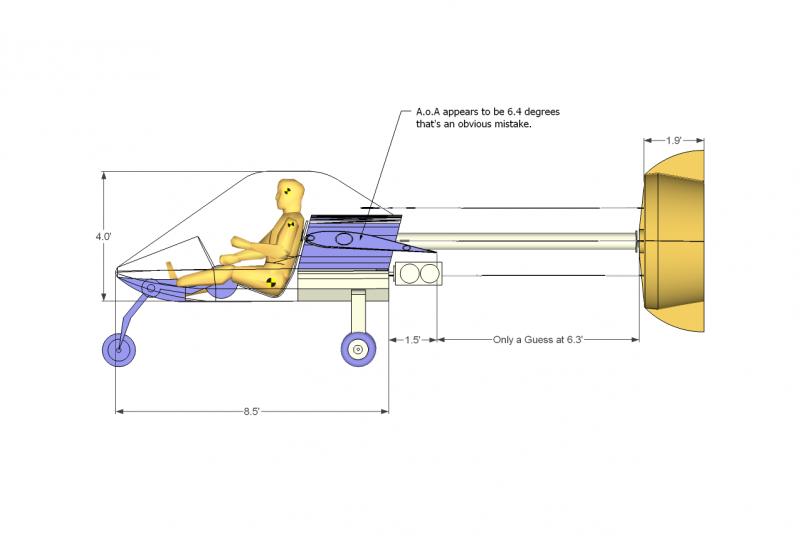

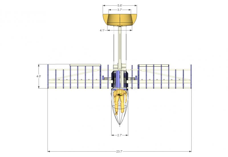

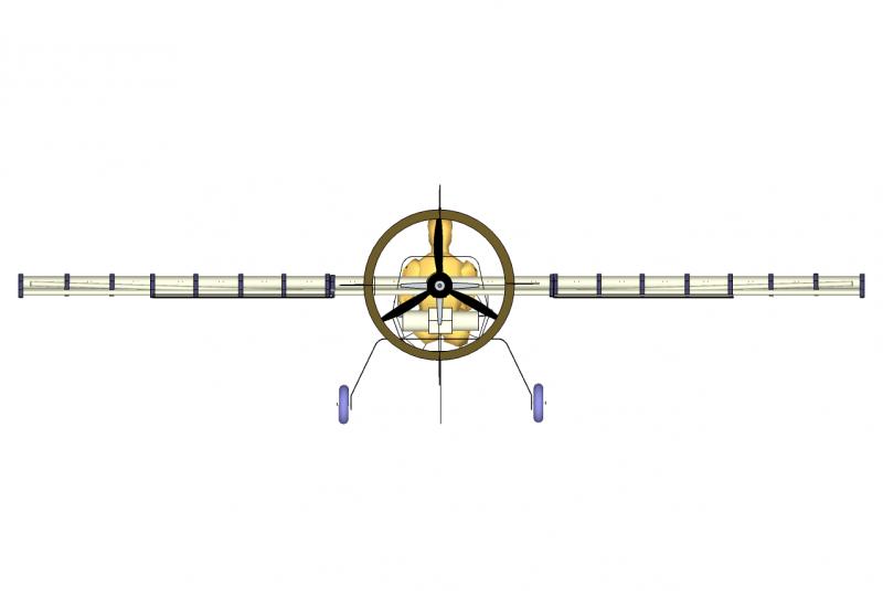

Deskpilot Posted January 9, 2011 Author Posted January 9, 2011 OK Carl, attached a a few images and dimensions that you might be able to use. The boom tube length was just a guess when I swapped the conventional tail with the VT unit. This was originally a design I put aside due to it being 'slated by the yanks' as being useless and too expensive to produce (the prop revolved around the boom just aft of the wings) Hope you can do something with this info. BTW, I've no idea as to what the airfoil section is as I stretched it somewhat. I'd go with the Clark Y at this stage.
Guest aussie carl Posted January 9, 2011 Posted January 9, 2011 Thanks. What diameter is the duct I am going to struggle with the boom on the same centerline as the wing spar, a full size job would have similar manufacturing problems. It would be much simpler to manufacture if the prop was fixed and the duct could move the desired amount for elev and rud control. the clearance on the duct would have to be increased slightly, this I see as a good thing. 1. less noise 2. less diffence in control responce between differnt power settings and motor off. Just throwing some thoughs in the air.
Deskpilot Posted January 9, 2011 Author Posted January 9, 2011 Carl, the main thing is to see if the plane is controllable without power so the actual sizing isn't all that important. That said, see attached image. Let me say that a plain ring tail is now flying successfully in the states using a tractor configuration. With this design, we have to move the prop as well so there might be gyroscopic effects as well. I fully understand that a fixed prop would easier but I want a more instant response so that we can perform the Cobra? that the ruskies do with their fighter. Remember, this is only for the fun of it.
