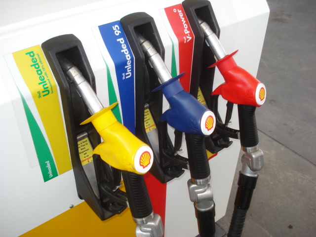

Guest ozzie Posted December 7, 2010 Posted December 7, 2010 How do you know ozzie?Pud i use Shell as i have their fuel card. pumps marked as follows yellow E10, blue 95 no ethanol, red 98 no ethanol. pumps labled to use use 95 not E10 in marine craft and garden equipment no mention of ultralights as per caltex. not sur of other major suppliers in NSW as i don't frequent them. I notice that E10 is now around 10cpl cheaper than 95. used to be 3 cents
pudestcon Posted December 7, 2010 Posted December 7, 2010 i use Shell as i have their fuel card. pumps marked as follows yellow E10, blue 95 no ethanol, red 98 no ethanol. pumps labled to use use 95 not E10 in marine craft and garden equipment no mention of ultralights as per caltex. not sur of other major suppliers in NSW as i don't frequent them. I notice that E10 is now around 10cpl cheaper than 95. used to be 3 cents Thanks ozzie, I checked out the links davidh10 posted so, with that information and no markings on pumps mentioning 'E10' or ethanol, I'll take it there is no ethanol blends in WA fuel at the moment. Can't see it lasting though. Pud
Guest ozzie Posted December 7, 2010 Posted December 7, 2010 pump labelling Shell pumps in NSW now labelled like this. I have also noticed that in some country shell servos, and most of the independants, still have straight unleaded and E10. but they are all slowly eliminating 92 straight unleaded.
