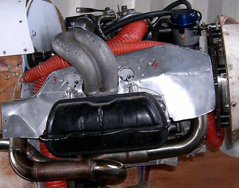

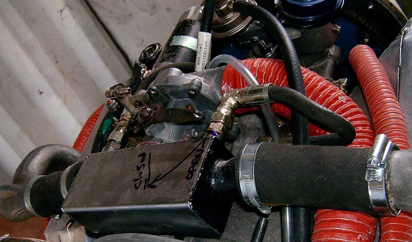

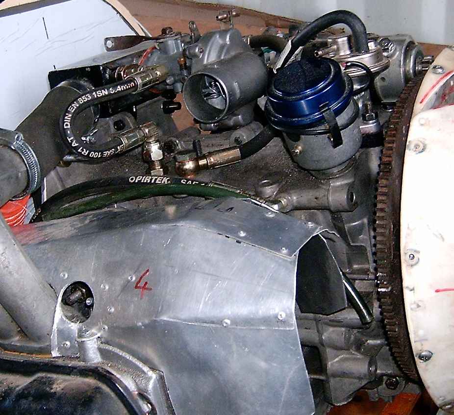

Terry Posted January 6, 2015 Posted January 6, 2015 What type of carbys are being used on VW engines?:;)5: Im using a zenith side draught but i am not happy with it. Hi there. I have a Corby Starlet which has just had major work done on the engine. Its been given new heads with SS valves, new barrels & pistons etc(from 1650 to 1835 cc), plus a new cam, amongst other things. We tried to use the old carb which was a Stromberg and probably off a Mini 1000. While this carb worked well with the 1650 engine, it is just too small for the bigger motor. We have just fitted a Bing (salvaged from a Jabaru 6 cylinder engine), and engine runs tomorrow, plus hopefully a circuit or two. I'll let you know first impressions. I dont do IT all that well, but I'll try to include a few pix of the installation
facthunter Posted January 6, 2015 Posted January 6, 2015 The Jabiru six will flow more air than your motor so the piston will not go fully up on full throttle if nothing is altered. This may mean that you don't get the rich mixture on full throttle built into the initial installation. Try to put something that will tell how far the slide opens as an indicator, or you will be in no man's land as far as tuning it to achieve a rich mixture where required. Nev

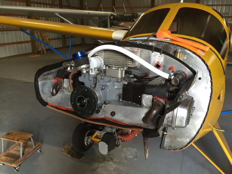

N237F Posted April 10, 2018 Posted April 10, 2018 Teenie2.Do you realise how old that engine must be. The Corby celebrated 40 years, last year.Do you have John Corby's address, if so could you let me have it. I built and have flown the Corby for 5 years and have never contacted John to tell him how happy I am with it. Zenith Carby on VWI am fitting a new 1600 VW to my Jodel D9, with the original Zenith carby and intake system from my old Stamo engine. It worked well on the old donk; very economical and no hassles. It's fairly low profile, so visibility shouldn't be impaired too much. Lyle Pix attached Zenith Carby on VWI am fitting a new 1600 VW to my Jodel D9, with the original Zenith carby and intake system from my old Stamo engine. It worked well on the old donk; very economical and no hassles. It's fairly low profile, so visibility shouldn't be impaired too much. Lyle Pix attached Very neat solution I have a Revflow updraft and I expect I have some atomization problems. I may add some heat to the upriser tube to resolve. The plan has 750+ hours but is new to me. Extremely well made winning a Lindy award at Oshkosh in the late 80's enjoys a unique one off oil filter cooler arrangement. A top mounted carb would move away from the simplicity of gravity feed which is likely already a concession made on a Jodel. I attached a picture of my Oil cooler/filter plenty of room for a top mounted solution in the existing cowl. I bet the Jodel is a delight to fly!Regards Matt
Old Koreelah Posted April 10, 2018 Posted April 10, 2018 Nice setup, Matt. Looks like you have the same low-profile ignition system I used on my VW. You've dredged up a pretty old post of mine. Lots of air past the prop since then! About a dozen years ago I replaced my second VW engine with a Jab 2.2 and its been a great success.
N237F Posted April 10, 2018 Posted April 10, 2018 Nice setup, Matt. Looks like you have the same low-profile ignition system I used on my VW.You've dredged up a pretty old post of mine. Lots of air past the prop since then! About a dozen years ago I replaced my second VW engine with a Jab 2.2 and its been a great success. The same can be said for the prototype Cygnet which has been fitted with a Jab2200. With electric start I believe it enjoys about two stones less weight which is gold in light aircraft. Viking Aircraft LLC World head quarters is in Burlington Wisconsin about 30 miles from my home field. After I get acclimated to the cygnet I plan to visit and look at the Jab 2200 install, Most run a updraft bing I believe.My VW Guru was keen on the Compufire DIS. I am please this one came with my bird! Slick MAG as a backup! Bob Hoover's Blog: 11/26/06 Best! Matt
