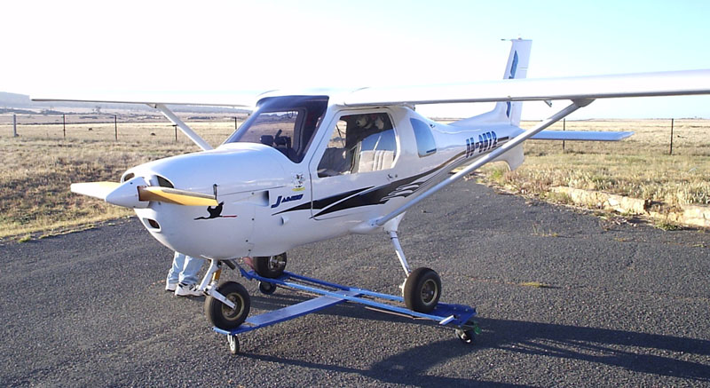

slartibartfast Posted February 4, 2007 Posted February 4, 2007 Got to agree. Don't play with it. I knew a guy who thought it would be cool to cut holes in the sail of his hang-glider to put the cross member over the leading edge to create anhedral where there used to be dihedral. Then tested it from a 900' hill. He didn't survive the out of control flight. Here's what we use dolly-wise. Great for getting it in the hangar sideways. [ATTACH]1346[/ATTACH]

Guest landman Posted February 7, 2007 Posted February 7, 2007 I put my 26 ft Savannah adv through a 23ft door. I put a skate under each wheel and push it sideways. The nose on the savannah only weighs a few pounds so I lift by the prop and push the skate under with my foot. The side wheels are pretty heavy and I use a floor jack to lift them the one inch necessary to get on the skate. It works really well. How do you get up on your sled? I would have a hell of a time trying to push my savannah up that high by myself and it only weighs 650#
