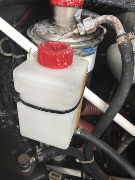

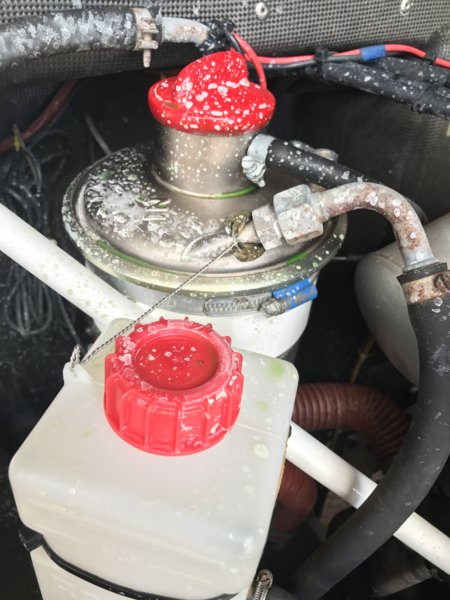

So I have this issue. Lately my 912 has started spit bits of coolant out the overflow lid. But not really on flights under 2hrs. I just completed s 3 hr flight and the overflow bottle is empty. Header tank still has coolant. And the overflow was only filled exactly to the min line.
Temps on climb up to 120 CHT AND 100-110 on cruise.
Oil 105 on climb and and around 90 on cruise.
I have a new cap coming 1.2 bar and a new radiator extra two core from Bert Flood.
Anyone else had anything like this?
Cheers

From the pix, it's certainly made a mess of the plane!

The last flight before the coolant dump :;
