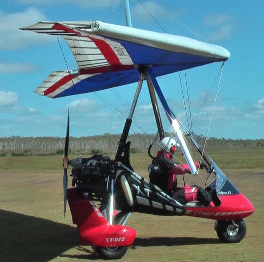

cscotthendry Posted November 12, 2010 Author Posted November 12, 2010 "Gentlemen, mount your antennas!" I now have three trikes using my mount. The antenna seems to work well in this position. So well in fact that Airborne are designing a mount. I angled mine to give a bit extra prop clearance when the bar is fully forward. Shane Duncan said that you should have at least 100mm clearance between the antenna and the prop. It wasn't clear why, but I got the impression it may have to do with regulatory issues. The other day, I was flying at Teewah, north of Noosa and I was hearing calls (5/5) out of Tyagarah. I was at 2500' AMSL at the time.
alf jessup Posted November 13, 2010 Posted November 13, 2010 I now have three trikes using my mount. The antenna seems to work well in this position. So well in fact that Airborne are designing a mount. I angled mine to give a bit extra prop clearance when the bar is fully forward. Geez Scott, Looks mighty similar to mine lol
cscotthendry Posted November 13, 2010 Author Posted November 13, 2010 Alf: That's because I got the idea from you. Credit where it's due. I used a piece of angle to mount the antenna where I think you used the Airborne bracket or similar. Also, my bracket mounts on the end of the plug where yours mounts on top. Six of one, half dozen of the other. I started out without the angle, but like you, didn't like how close to the prop the bottom was so I used the 10 degrees that you mentioned and that was good. I had a look at the antenna in flight and the bottom doesn't flex in the wind at all, so maybe the angle is not really necessary.
alf jessup Posted November 14, 2010 Posted November 14, 2010 Alf:That's because I got the idea from you. Credit where it's due. I used a piece of angle to mount the antenna where I think you used the Airborne bracket or similar. Also, my bracket mounts on the end of the plug where yours mounts on top. Six of one, half dozen of the other. I started out without the angle, but like you, didn't like how close to the prop the bottom was so I used the 10 degrees that you mentioned and that was good. I had a look at the antenna in flight and the bottom doesn't flex in the wind at all, so maybe the angle is not really necessary. Scott, It was said with tongue in cheek mate tongue in cheek. I wanted no credit mate if I can help others out with a problem i will always put my foot forward as I guess you would be the same. I had a chuckle when i wrote it. Was a pleasure to be able to give you and idea mate. Alf
cscotthendry Posted November 14, 2010 Author Posted November 14, 2010 Alf: Yep, I got the humour, but still...credit where it's due. I had been thinking about the antenna issue for some time and tried it on the base, but that wasn't much chop. Since I have a lathe and mill, your idea looked very do-able and it also works well electronically. Good on 'yer.

cscotthendry Posted November 17, 2010 Author Posted November 17, 2010 In an ideal world, the top of the kingpost really is the best place for the antenna. Sorry, but I just have to disagree with this point. It's what started this whole thread and the effort to move the antennas around. Here's why. The most common antenna supplied with Airborne trikes is a counterpoise type. Even though the counterpoise does not radiate signal, it's electrical characteristics are tuned for the antenna. If the antenna is mounted on the kingpost with the active end pointing down as supplied by Airborne, the kingpost loads and shadows the antenna radiation pattern. This also increases the VSWR which is not good for the transmitter outputs and could even be fatal. If the antenna is turned up the other way, with the active end pointing up, then the counterpoise lies alongside the kingpost. This changes the effective RF characteristics of the counterpoise and consequently the balance of the antenna. Again, not an ideal situation. I don't really know how the V rabbit type antennas work, so the top of the kingpost may be ideal for them, but it's defininately a no-go zone for the counterpoise types. Nor is it a good place for groundplane type antennas. Like Dieselten, my RF knowledge is very rusty (USAF C.1970's; NASA tracking station C. 1980's) But the good people at Mobile One (who manufacture the antennas supplied by Airborne) confirm that the kingpost mount is a no-no. BTW, This post wasn't meant to be a flame, and I hope it didn't come across like that.
Mc Guyver Posted November 18, 2010 Posted November 18, 2010 Sorry, but I just have to disagree with this point. It's what started this whole thread and the effort to move the antennas around. Here's why.The most common antenna supplied with Airborne trikes is a counterpoise type. Even though the counterpoise does not radiate signal, it's electrical characteristics are tuned for the antenna. If the antenna is mounted on the kingpost with the active end pointing down as supplied by Airborne, the kingpost loads and shadows the antenna radiation pattern. This also increases the VSWR which is not good for the transmitter outputs and could even be fatal. If the antenna is turned up the other way, with the active end pointing up, then the counterpoise lies alongside the kingpost. This changes the effective RF characteristics of the counterpoise and consequently the balance of the antenna. Again, not an ideal situation. I don't really know how the V rabbit type antennas work, so the top of the kingpost may be ideal for them, but it's defininately a no-go zone for the counterpoise types. Nor is it a good place for groundplane type antennas. Like Dieselten, my RF knowledge is very rusty (USAF C.1970's; NASA tracking station C. 1980's) But the good people at Mobile One (who manufacture the antennas supplied by Airborne) confirm that the kingpost mount is a no-no. BTW, This post wasn't meant to be a flame, and I hope it didn't come across like that. Hi Scott, The Vee Rabbit is designed to mount on the king post but below the peak. That way it does not get damaged when moving in and out the hangar. I fly an SST and I have the aerial mounted horizontally on a short keel extension so that I can get it in and out of my low hangar without causing damage. I have an extremely clear transmission and reception well over 100KMs. (do we need better in a trike?) This with a hand held Vertex I have yet to have people say I am unreadable in normal circumstances in fact people remark how clear my transmissions are:clap:
YFT Posted January 6, 2011 Posted January 6, 2011 Hi All, I am not going to buy into your debate about which is the best aerial. The one in the first post is a Dipole aerial, and in the photo it is mounted up side down. I have used that aerial for over 20 years on trikes. I also have one of the best radio responces from airservices and other aircraft. You need to have a full system, that means radio, aerial, and comms. get it right it works, get it wrong it give you a problem. If you don't believe me as David, or, Glen or anyone that has been on a Megafauna Flyaway, and they will let you know about my radio system. All the best Peter.
