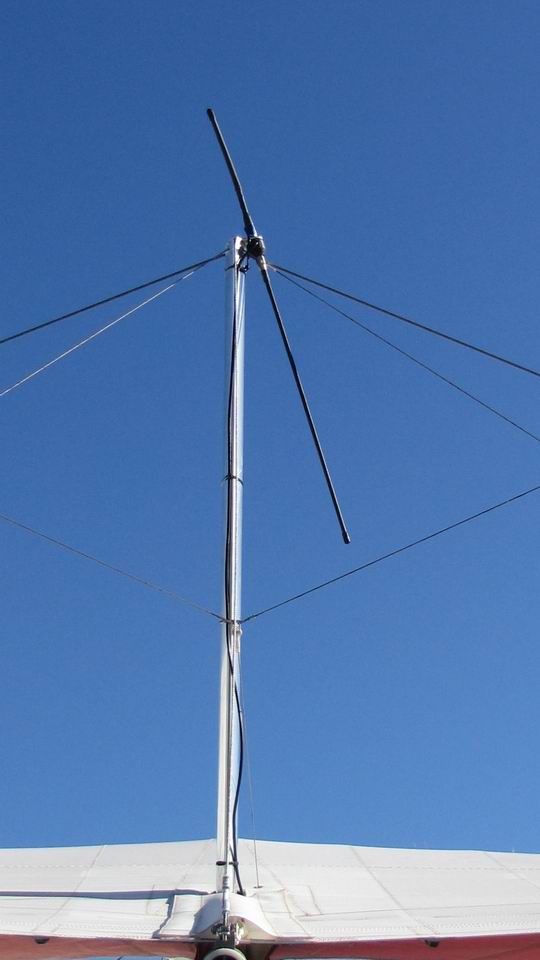

Last week crusty and I modified our aerials mounted on the king post.
Simply bending the king post top plate up to cause the aerial to sit away from the king post
instead of being parallel - shown in pic
I have noticed that on some original installations the aerial even angles in towards the king post slightly
We have had one flight together so far with no communication problems like we had experienced in the past.
Will keep you posted on our further evaluations and if this simple fix is really successful.

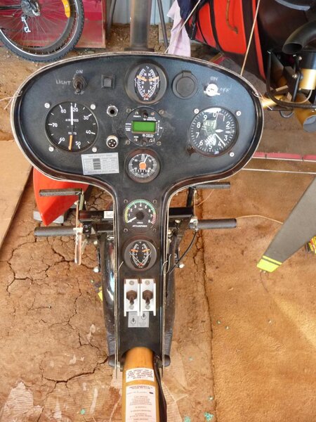

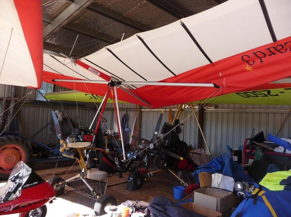

Here's a couple of shots of the Buzzard radio installation I took on the weekend. I don't think I'll be fitting much more onto the panel. There's a matchbox-sized microphone pre-amp velcroed and cable tied to the side of the radio behind the panel. and I suspect it's the source of the oscillation.
I've seen i couple of Airborne SST's with similar antenna mountings on their keel tube extensions.
Panel still looks a bit untidy as I'll be modifying the gain in the mike pre-amp as soon as I can get some more bits from Jaycar and make another visit. Then I put the trim around the edges again.

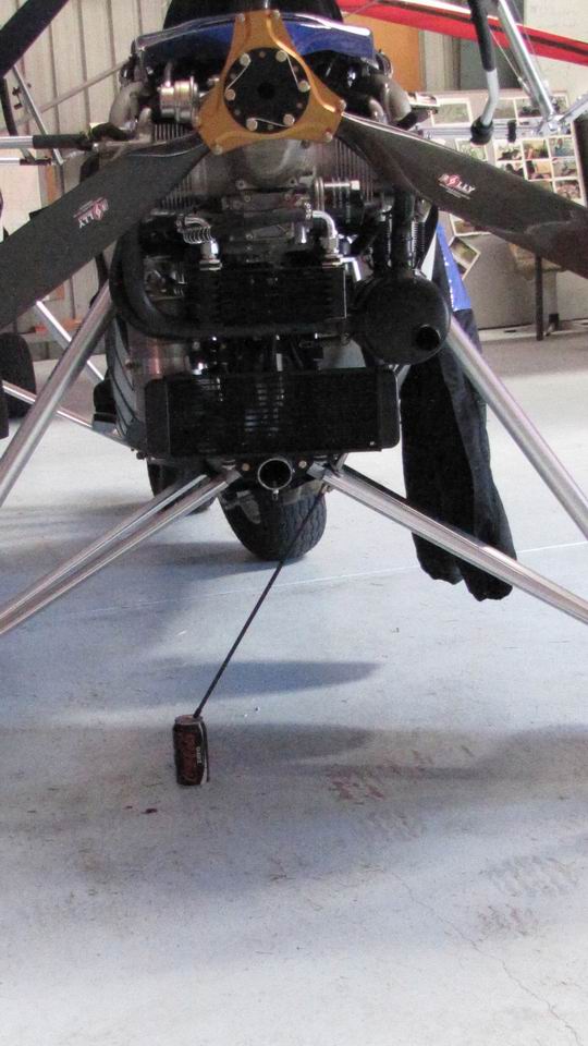

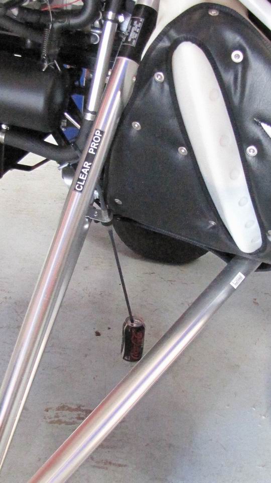

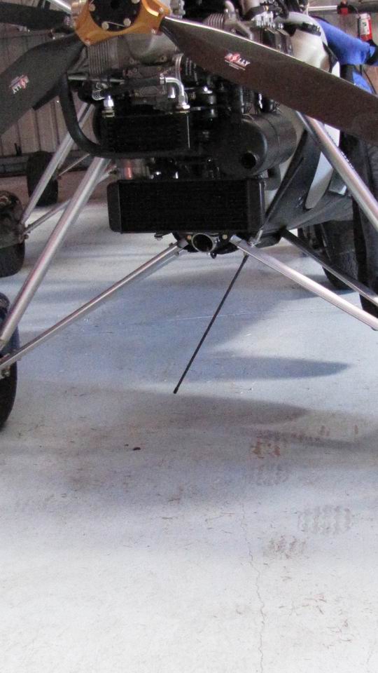

Hi Alf
You should be able to invert your aerial without it hitting the ground.
Waited until I went to the hanger to get my facts straight.
Took a few pic this morning to show how they come out of the factory on the SST's in our hanger.
Note the coke can has clearance under the aerial tip.
From memory there is a join in the cable near the steering foot peg pivot and a short piece of cable to the radio - only just enough long enough though - no extra.

We got the problem with te modulated oscillation sorted out today.
Firstly, the things which did not fix it.
1. Earthing the keel extension tube.
2. Lowering the gain of the microphone pre-amp by about 4dB.
What did work was creating some space between the radio and the microphone pre-amp (Aluminium) box. As I had velcroed and cable tied the pre-amp box onto the left side of the radio there must have been some capacitive feedback. There is now a 1/4 inch thick slab of wood with velcro either side, in between.
Subsequent airborne radio test gave 5/5.011_clap.gif.c796ec930025ef6b94efb6b089d30b16.gif
From a couple of km away in the air I had a clear conversation with another trike on the ground next to the hangar.
The panel is also now looking much tidier with the trim around the outside again gracing its edges.
