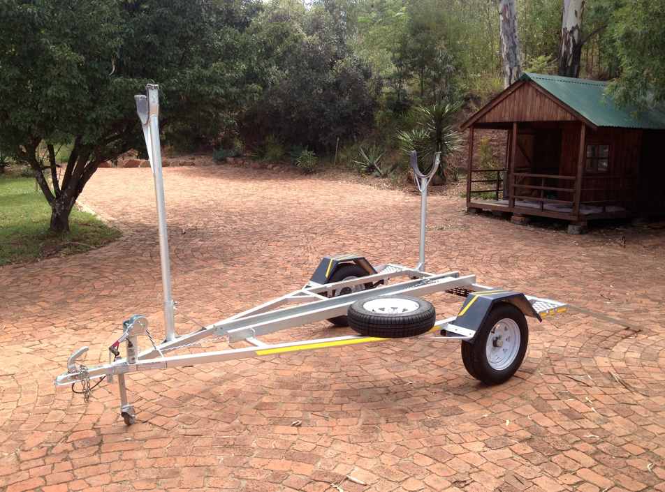

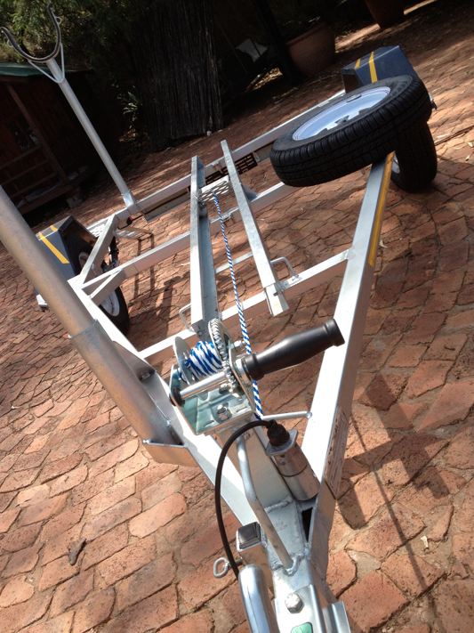

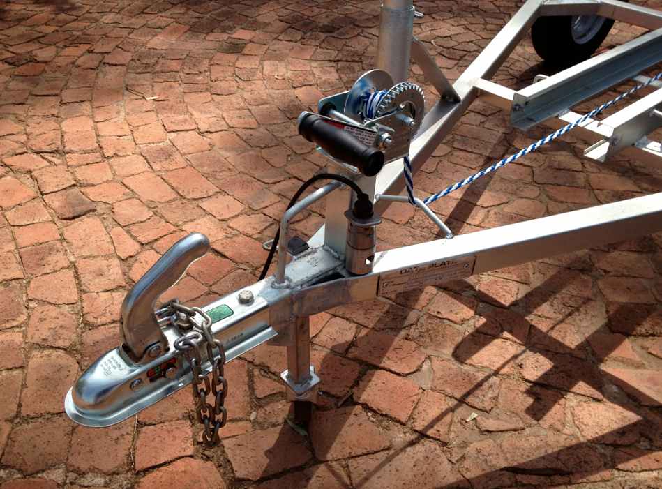

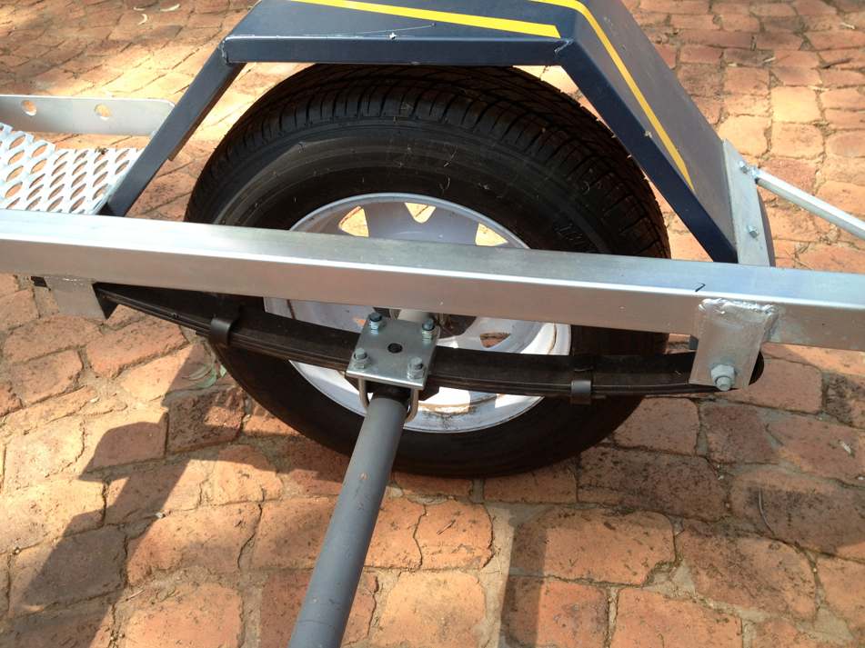

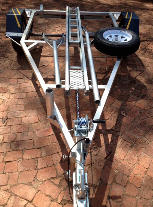

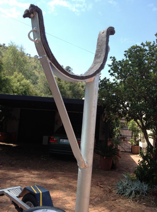

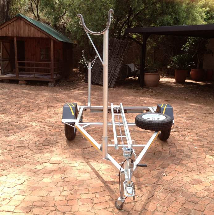

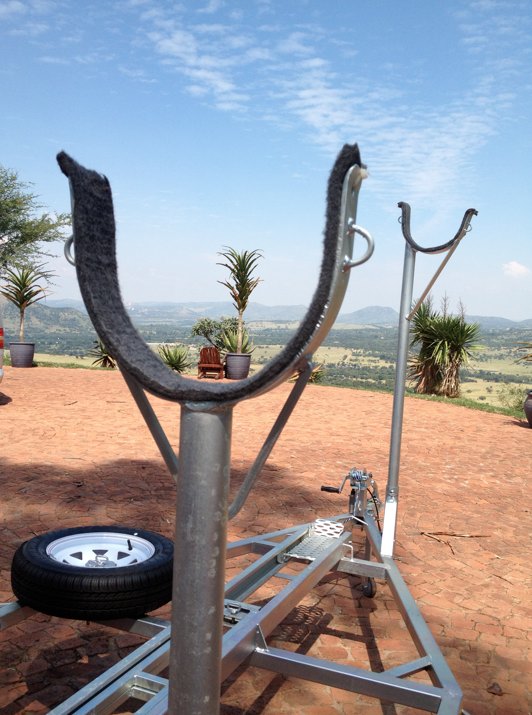

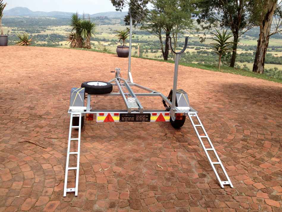

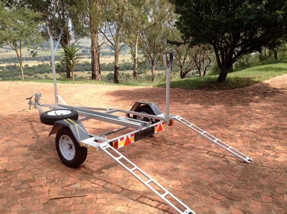

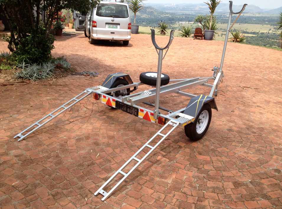

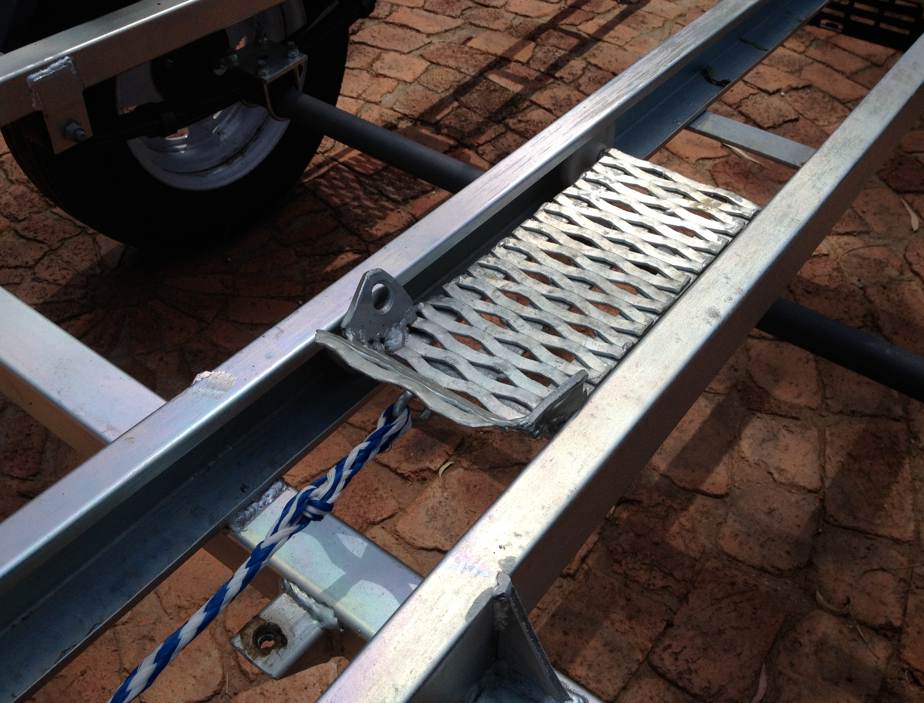

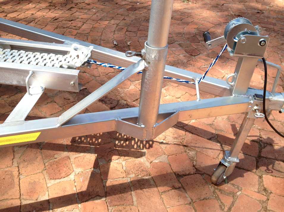

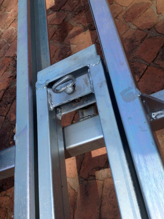

Greetings All!
This trailer has taken 10 years of development and really is fantastic!
Features include:
  1. Winch for loading
  2. Detachable ramps which bolt in the middle of the trailer when transporting
  3. Detachable wing rack supports
Most pictures are self explanatory but let me know if you have any questions.
Ciao, John

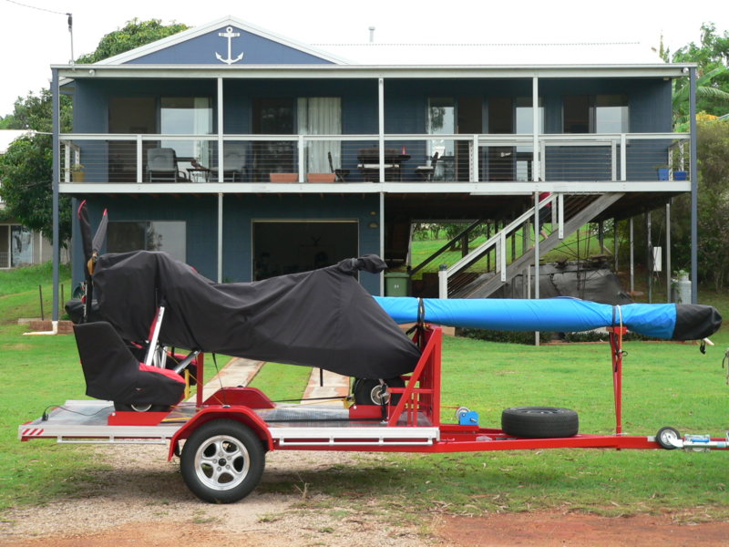

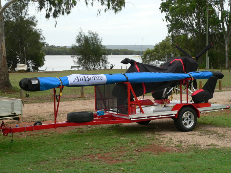

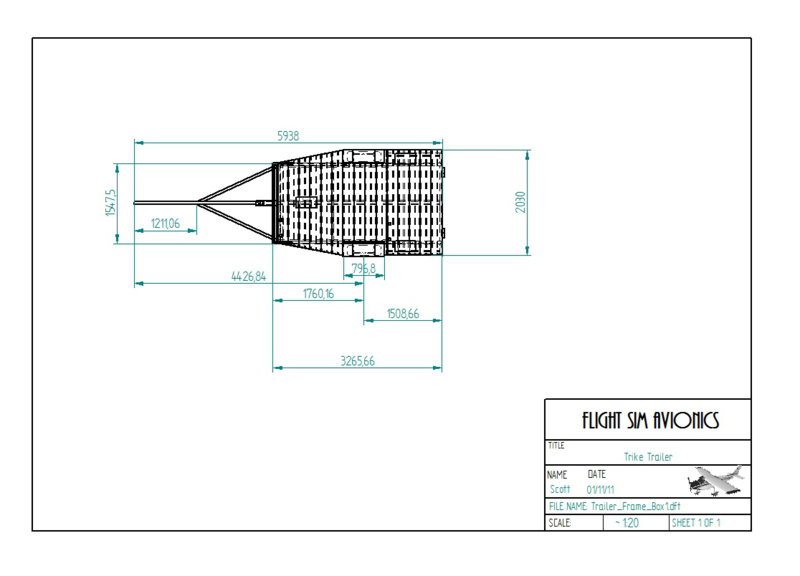

Hi All:I thought I'd start a thread for ideas for trike trailers. I'm currently having one built and got ideas from several sources. I thought this would be a good place to share your ideas on what makes a good trike trailer.
I'll start with some of my ideas.
Fisrtly, weight. The lighter the trailer, the less fuel it takes to haul and the less tyre wear.
Secondly, I decided to have a full deck on the trailer and in keeping with the first goal, I decided to have an aluminium deck of the sort that they have on tray-back utilities.
Third, Wing racks. I chose to have the wing mounted on the trailer rather than the vehicle as it makes the trike transport self contained. If I take the trike on holiday and I want to go to the shops or out to eat, I don't want to be lugging the wing with me. Also, the added cost of racking on the trailer is less than and more asthetic than the racking on the vehicle. Finally, if the wing rack was on the vehicle, I'd probably leave it on even when I'm not trailering the trike and those things are pretty ugly on a vehicle.
Fourth, Tilt. I decided to go for a tilting trailer rather than ramps. The tilt doesn't add as much weight as carrying a set of ramps and is quicker and easier for getting the trike on and off the trailer.
Fifth, Winch. I decided to have a winch to get the trike on and off the trailer. Having the winch means not having to heave the trike on and off manually. Whenever you're heaving the trike around, there's the possibility of hurting someone or the trike.
Sixth, Wheels enclosed withing the deck perimeter. My brother-in-law says that he occasionally drags his trailer mudguards against things and suggested this solution. Also given that my trailer is 6 metres long and has a big turning circle, this is even more likely to happen.
Seventh, The trailer extends past the prop in the back. This might save a busted prop if I back into something.
Eighth, Stone deflector at the front. This is a simple and useful addition to protect my investment from rocks and stones thrown up by the towing vehicle.
Ninth, Open top. I decided not to go for an enclosed trailer for a couple of reasons; weight and ease of access. Also an enclosed trailer would require the wing to be carried much higher than I plan to carry it.
Tenth, Construction simplicity. The chassis design of my trailer is a very simple rectangular shape. The decking is just planks cut to length and bolted to the chassis. This helps to keep the cost and weight down.
Eleventh, Trike contained within trailer outlines. If I drag the trailer against something, I would prefer that the trailer cop the hit rather than the trike, so the trike sits completely within the boundaries of the trailer.
Here's some pics of my trailer chassis and the design model that I drew. I have this as a Solid Edge V19 file if anyone wants a copy, just PM me.

I like it
Glen:Yes, well spotted about the red. Did you notice that my trike is red too? No one will be able to keep up with me in the air or on the ground ;)
I plan to carry the wing kind of nestled between the fins of the spats and the body of the aircraft and slightly angled towards the center going forward. I want to carry the wing as low as possible, but not on the deck of the trailer. This will get the wing behind the towing vehicle and keep the C of G a bit lower. Because my trailer is fairly light (< 350Kg all up) keeping the C of G low will be an issue as the motor of the trike sits pretty high above the axles of the trailer.
I do have travel covers for my trike, but a bit of extra protection never goes astray. Oh, I forgot to mention that the stone deflector will be a steel frame with some heavy square fence mesh welded in and covered with something like shadecloth for the least wind resistance.
And my towing vehicle will be a V6 Rav4 (when I get it), so no power probs for the tow.
An extra waterproof cover for the wing sounds like a good idea, and maybe some covers for the struts.
Thanks for the input

Here's the drawing I used to guide my trailer maker. The plans are not a cookbook solution and should be tailored to your trike. I've also included a pic of the wing rack setup. The positioning of the racks was done 'on-the'fly' having the trike on the trailer for positioning and setting the positions so that the wing didn't extend beyond the width of the trailer in the back, nor beyond the length of the prop extents. The plug on the back of the trailer with the wire connected to it, powers a second set of tail lights on a board that I hung on the prop for extra safety.
Edit: The stone guard on the front of the trailer is a necessity. If you look closely at the pics, you'll notice that the shadecloth screen doesn't go all the way to the bottom of the guard. I used to regularly find little pebbles on the deck of the trailer that no doubt would have hit the trike, without the guard.
