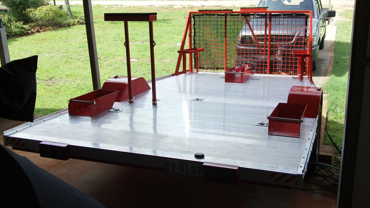

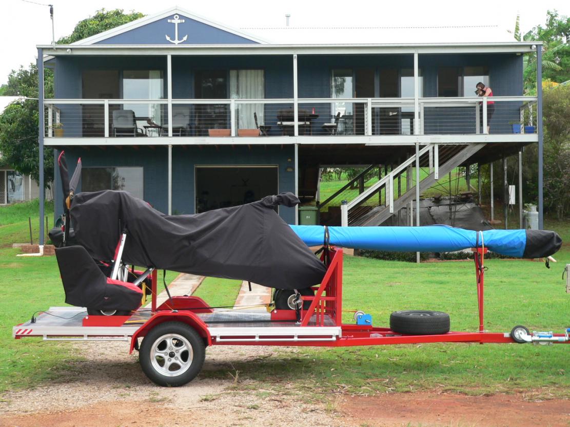

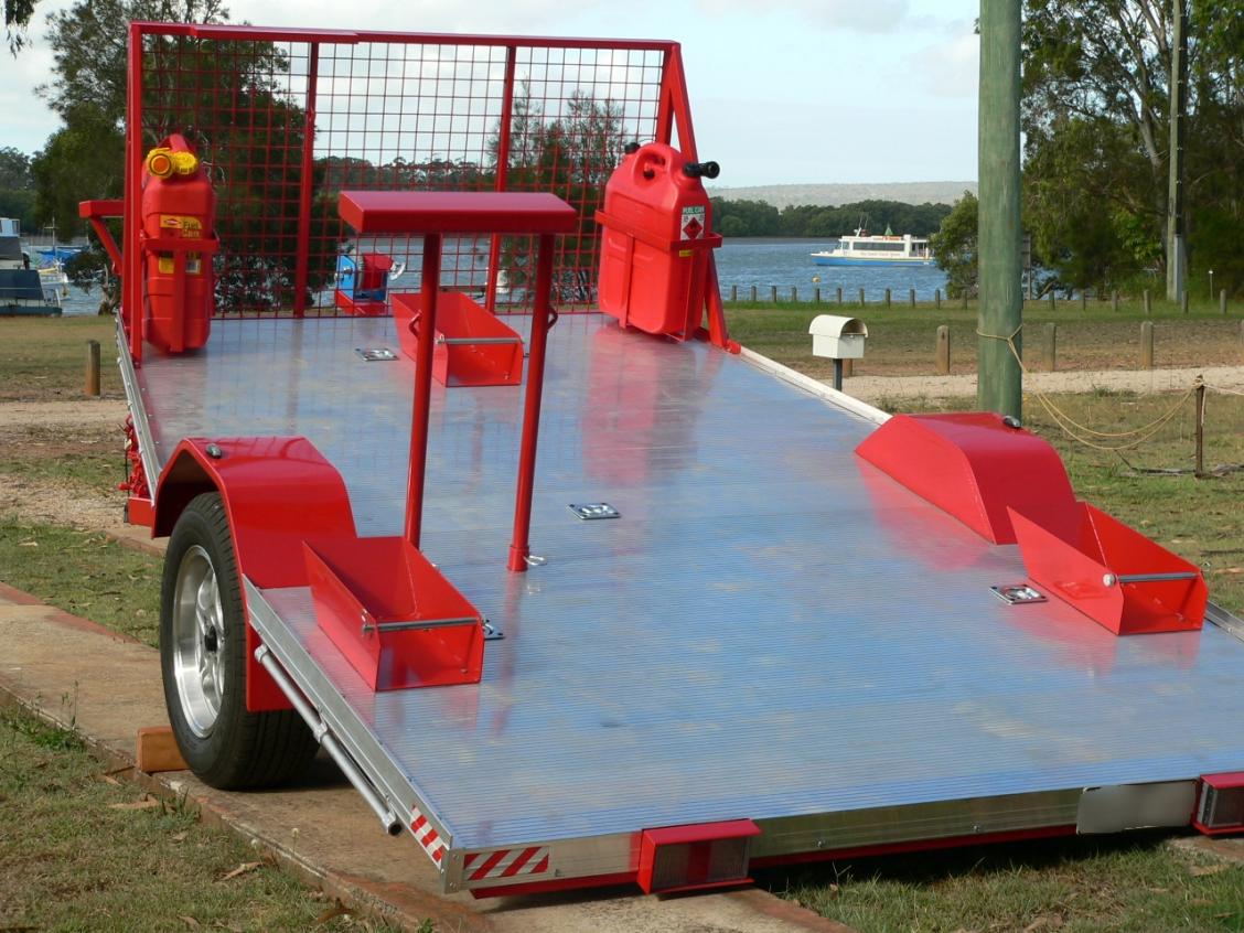

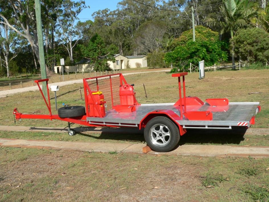

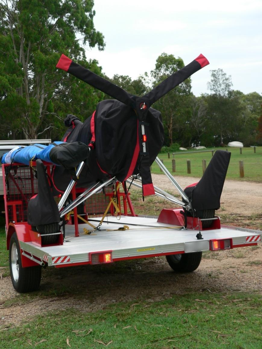

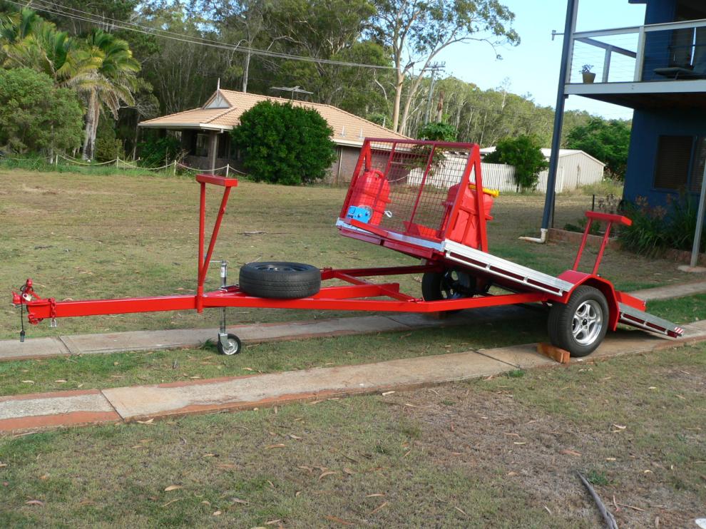

Thanks Ray. I just had a test run at loading the trike onto the trailer and tying it down. I'm pretty happy with how that went. The winch allowed me to haul the trike up and let it down in a nice controlled manner, single handed. The balance on the trailer without the wing is pretty well even. That is, it's easy to tilt the trailer back and then the tray stays there. It also stays in the un-tilted position if you put it there.
Overall, the trailer will still be forward weighted because of the spare wheel, the wing, the fuel drums and a possible equipment box in front of the axle. The forward balance is probably not as much as I would have liked, but still roadworthy. A shorter trailer balanced as this one is might have been a bit squirrely, but because of the length, it will still be a stable tow.

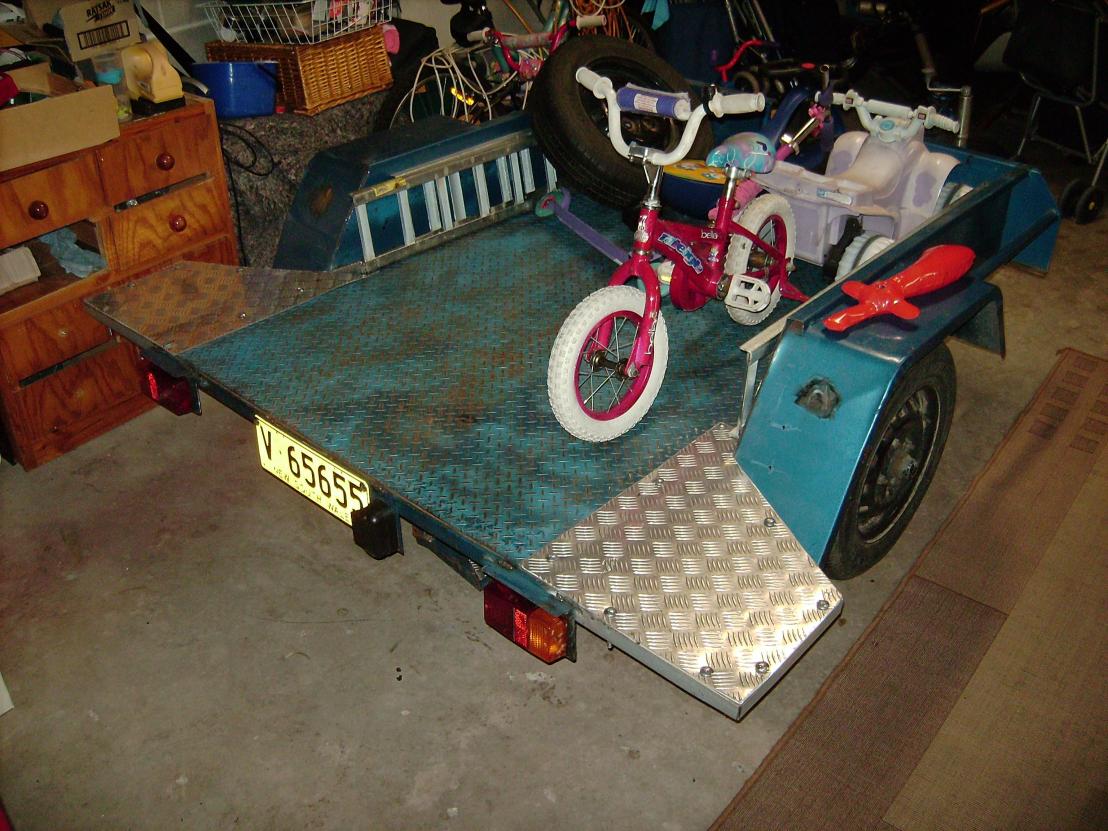

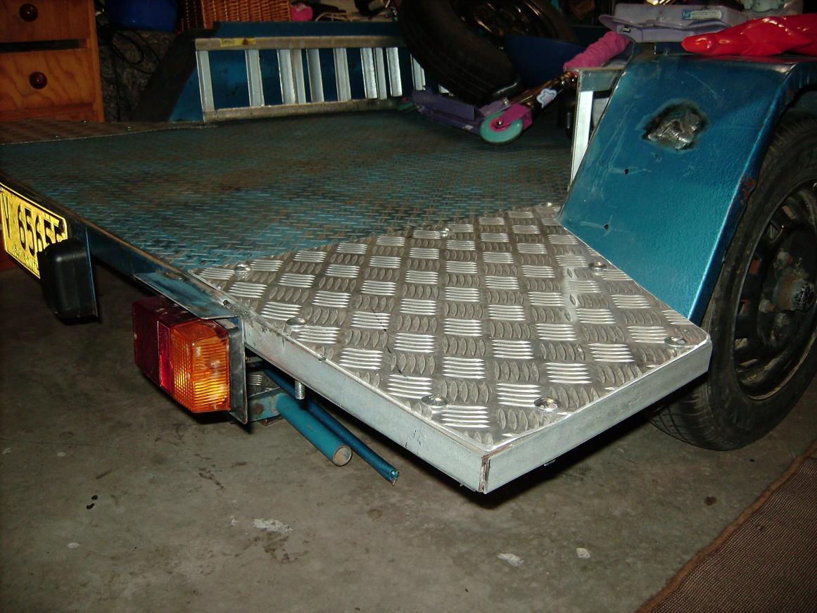

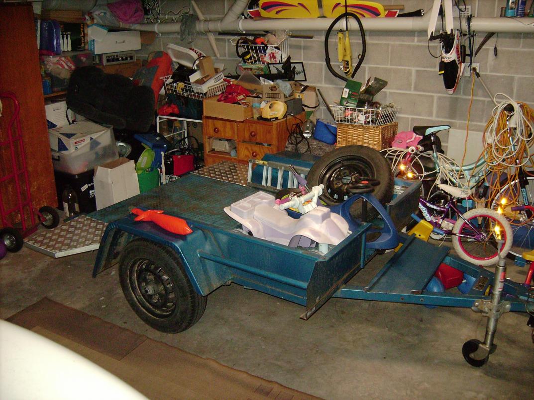

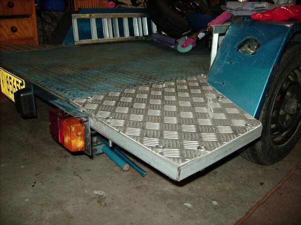

Thought I might show some of my photos to give others ideas on converting a box trailer to fit a trike.
Looked at various options with regard to buying new or possibly converting a different type of model but went ahead with cutting the back end off my old and reliable trailer. I still have a few jobs to do to finish it off i.e anchor points, prime/paint, stowage rack for ramps under floor and fit hand winch to front of trailer.
I have tried to re-use as much of the cut off materials as possible and found it a great way to become quite comfortable with the welder and grinder - without annoying the neighbors too much.
Some questions I have though are when pulling the trike up the ramps where is the best attachment point on the trike. I tried using two clips, one on the left and right axle and found the steering to move more then what i would have liked. Additionally when tying down the trike on the trailer again where is the best attachment points on the trike.
Anyway any help would be much appreciated.
Regards Jon K.

Congrats on a very neat conversion job!
As for winching the trike on board, here's what I do: I'm assuming your trike is an Airborne trike. If not this may not work.
The rear suspension has two plates, I'll call the inner and outer plate. Between them are two round posts that connect the plates. I use those tie-down straps that have the steel hooks at both ends and the buckle for tightening. I hook one end of a strap to each of the two sides of the rear suspension (two straps) on the round posts at the front of the suspension and then hook the other two hooks together in front of the front wheel. Then I hook my winch to those front hooks. That way, you're pulling from where the weight is concentrated rather than the front fork via the base tube etc. I've found that doing it this way the front wheel doesn't tend to turn, and also that it's free so that I can make minor adjustments to the tracking as I winch the trike on. This works with an XT912, although I believe some trikes may have a tendency to topple backwards if the angle of attack is too great.
I think you will find the Airborne manual has a section on tying down to a trailer
- XT anyway.
If you have rear breaks - watch the break lines don't get involved
The tie down points on the airborne trailer design ( Plan on their web site) seem to work very well ( assuming its the same as their factory trailer), with about 3 different locations around each back wheel for choice and one either side and forward of the front wheel from memory.
Check if you need to move the trailer lights further to the edges -
RTA(NSW) have specs on their web site for building (modifying) small ( <4.5t) trailers
with plenty of detail.

Great looking trailer. Just a little concerned that the wing is supported directly on what appears to be steel sections at 3 points. Could be potential for damage to wing spars & or sail due to vibration & rubbing when on anything other than perfectly smooth bitumen. I used to suspend my wing with wide webbing straps with no damage caused even on fairly rough tracks.
Rgards Pete
Ray:
Floats? Don't I wish!! I priced them when I was purchasing the trike,036_faint.gif.544c913aae3989c0f13fd9d3b82e4e2c.gif but they were a bit out of my league.
Pete:
I thought about some kind of sling arrangement and I may still try to do something like that. Like you, I'm not overly fond of the current setup, but I needed to do something. In the short term I may do what Slartibartfast suggested and use some soft foam padding. That's what my instructor does on the racks on his truck. In his case the wing is only supported in two places.

Jon,
Like the look of your converted box trailer in post #35 of this thread. What size box trailer was it? Was it a 6ftx4ft? If so I'm thinking of doing something similar to my 6x4 box trailer but maybe in a way that it can still be used as a box trailer . . .

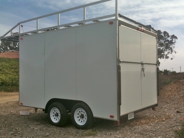

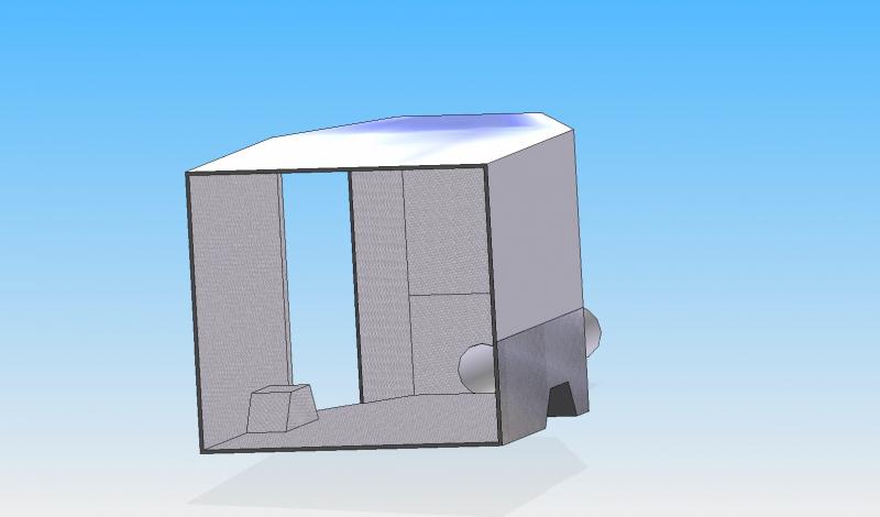

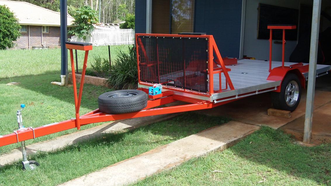

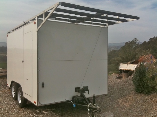

Here I go again:

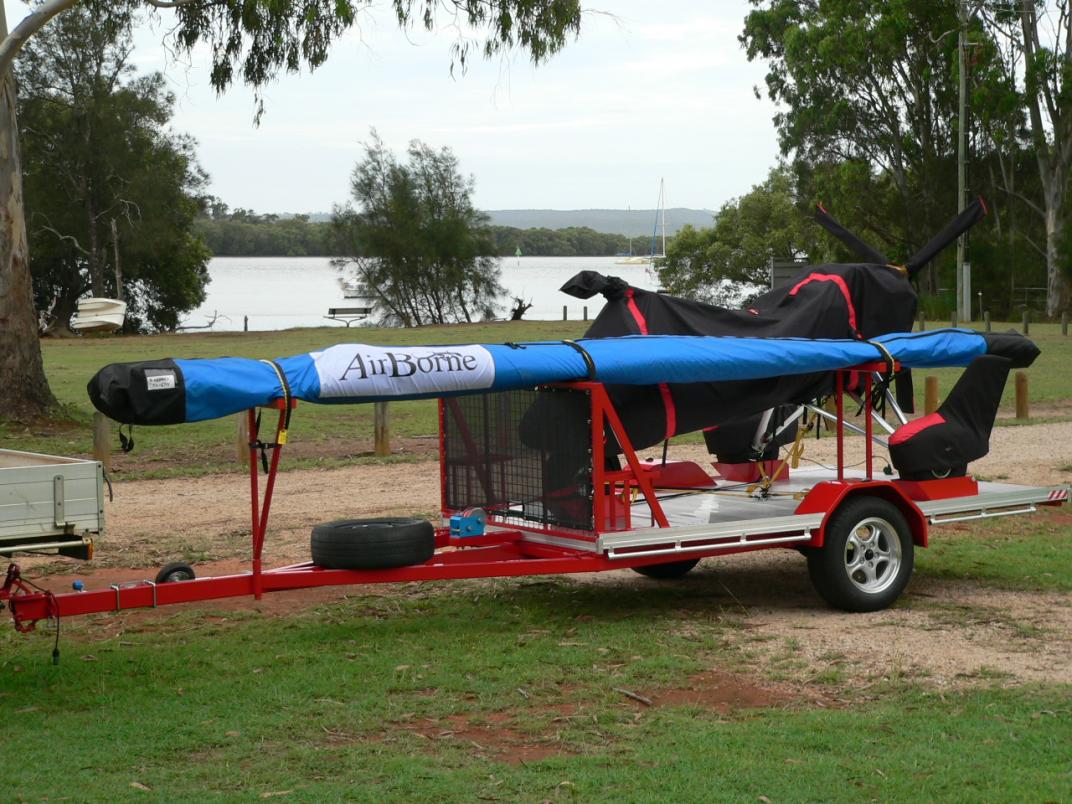

It looks like I might have sold my flatbed trailer and now have the opportunity to build a covered trailer. This is what I'm considering.
As always, your suggestions are most welcome.

I noticed that others have already mentioned it but I suspect that one 100km+ trip with the wing tied down like that would almost certainly result in you needing a new wing, worst case, new skin at best. I have tradditionally used ladders as a basis of support with Carpet and then foam between the ladder and the wing to spread the load over as much contact surface area as possible, and my instructor told me that the big PVC drainage pipes that are about 35-50cms across, if cut in half lengthwise and lined with Neoprene make a fine cradle for wings as well, which would then mount just fine on those supports.
My experience towing a trike and wing long distance with a V6 VR commodore on Gas showed that fuel ecconomy towing a trike is just horrible with a required resultant speed decrease down to 90as max. The next long tow (2000km's) was done with a 4cyl 2Lt ford focus turbo diesel and what a difference that was, the focus hardly felt any difference at all with fuel ecconomy about 50% worse overall but still easily doing 110 where allowed. However that was a moving home situation and the car and boot were absolutely chockers so the trike may not have contributed the entire 50% extra.
When the focus normal ecconomy is around 6 - 7Lt's per 100k's 50% extra sounds heaps...but was still less than the commodre without the trailer..
So why all the stuff around fuel ecconomy....I wonder if a horse float would be even worse on the hip pocket at refuel time. Trikes are draggy, but I think horse floats or flat fronted trailers like your drawing shows would be even worse on a petrol puller.
