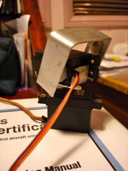

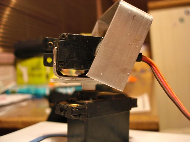

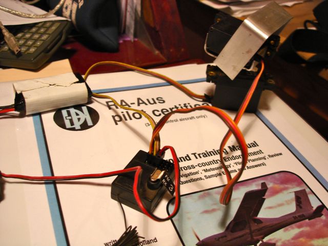

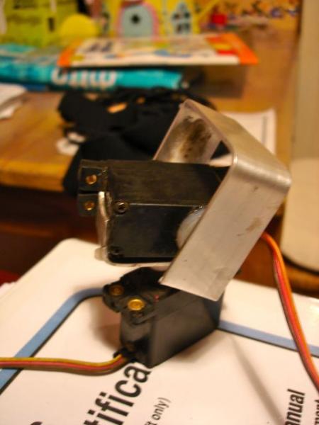

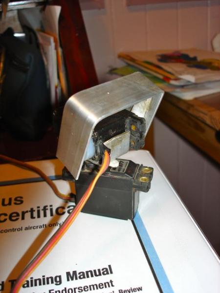

Tomo Posted September 26, 2009 Posted September 26, 2009 Quickly nocked a little swivel mechanism up this afternoon... Haven't done all the trimming touches to it yet, but it seems to work pretty good! [ATTACH]8767.vB[/ATTACH] [ATTACH]8769.vB[/ATTACH] [ATTACH]8766.vB[/ATTACH] [ATTACH]8770.vB[/ATTACH] [ATTACH]8768.vB[/ATTACH]
Guest Decca Posted September 26, 2009 Posted September 26, 2009 Hey that's pretty nifty Tom. Controlled by the RC transmitter? Decca.
Tomo Posted September 26, 2009 Posted September 26, 2009 Hey that's pretty nifty Tom. Controlled by the RC transmitter? Hey thanks Decca, Yep controlled through a RC transmitter, That's a six channel Receiver two... could hook up a camera with RC shutter and hook into it to...?? I thought it's just as easy to do it that way... that way you could put it anywhere on the aircraft and all you would have to worry about is the video screen cable running to the cockpit... You only need a really basic two channel transmitter that you could mount somewhere, and even connect to aircraft power if you so desire, would just have to put in a power jack in the side of the transmitter, pretty easily done.
Guest watto Posted September 26, 2009 Posted September 26, 2009 Looks really good, thats the type of setup that I was envisaging! Where do you think is the best spot to mount it Tomo (Belly, strut?)
Tomo Posted September 26, 2009 Posted September 26, 2009 The belly would be better I'm thinking, because if it's on the strut you wouldn't get a very good radius, due to the fuselage being in the way on one side.

techie49 Posted September 28, 2009 Posted September 28, 2009 Pan & Tilts Unless you are getting your video back to the monitor / recorder via a wireless video link transmitter, it seems a waste of a RC transmitter and receiver set up. Why not use a wired controller to the two servos. It's very easy to make a controller with a joystick or two pots to control the pan and tilt functions. Used these P&T's extensively in a past life. The servo signals are not complicated and just need a 1 - 2mS pulse repeated every 20mS or so. Paul Toone
Tomo Posted September 28, 2009 Posted September 28, 2009 Yes I agree it wouldn't be hard to do, Which I may end up doing yet, I was just using what I had at this stage.
