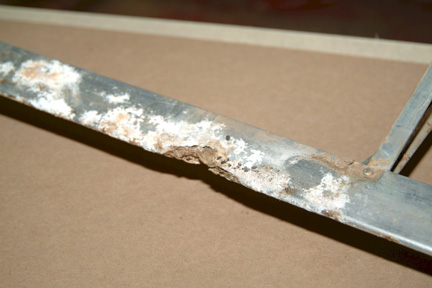

What happens under fabric. From Superflite.
Micgrace :)
ahhhh corrosion, my sworn lifelong enemy! even 5 yr old Hawks are
riddled with it! in one place its 10mm deep in a lower wing plank thats
50mm thick! not nice if your looking to get into the high G area!
but all corrosion has a cause! and what would hav caused that? water trapped under the fabric?

Corrosion is a strange beast, to repair the above, first replace the
damaged part, treat the new part in a alochrome solution, then zinc
chromate primer, and a final epoxy finish coat. should stop it
re-occuring. I dont know much about fabric construction, but can fabric
coverings be bonded over epoxy painted and treated parts??
The
sever corrosion we are finding on hawks is caused by Rubber! the rubber
seals on the overwing fairings are causing a sever corrosive reaction,
to a point of total destruction of the part within a year! yet the
metal not in contact with the rubber is in new condition! the rubber
strip is solid riveted between a metal skin and metal backing strip,
and the corrosion only occurs where the rivets press the 3 components
together. all know treatemtns have been tried and all have failed to
stop it. (yet the RAAF wont allow us to chage the rubbertype)
3 aircraft in teh fleet were test flown before being painted! and as you would expext, all 3 are showing signs of corrosion (to damaging levels) in just 5 yrs of life, where the other aircraft are relativly corrosion free.
so be sure to have your aircraft primed and finish coated before any test flying!
