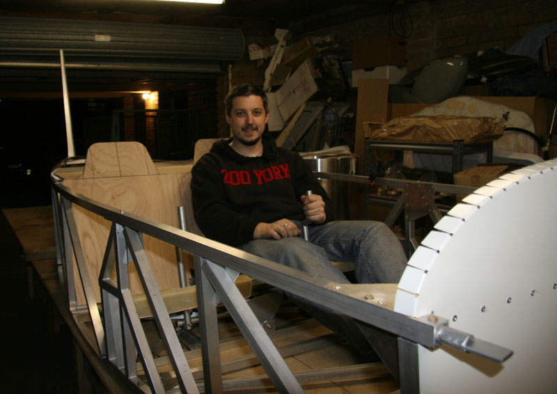

Here are a couple of sneak peeks:
[ATTACH]8606.vB[/ATTACH]
[ATTACH]8607.vB[/ATTACH]

Speaking of a lot of aeroplane, before taking the photo above of me sitting in it, we mocked up the cowel on the firewall just to see how she would look. Let me tell ya, this thing is MASSIVE in the front end...there is definately a WHOLE LOT of plane in front of you.
I can't wait to put her shoes on and see how she looks all three point like...I think this plane is going to have one mean stance, kind of like the way my Doberman looks when he's alert.
