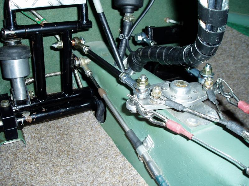

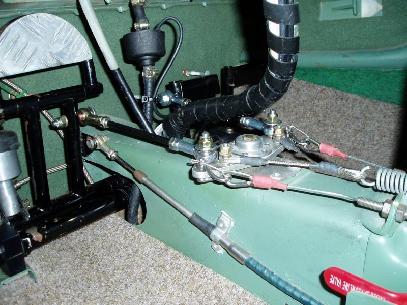

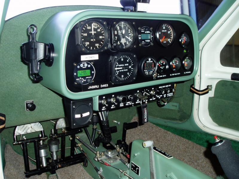

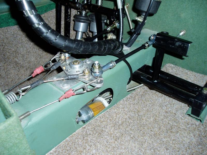

No worries, see attached. I took theses one when I made stonger push rods. I don't have any closer ones.
The biggest problem I see with a lot of toe brake installations on experimental and factory planes is mounting the bottom of the master cyliner to the floor of the aircraft so when you apply rudder, you also put im brake. I have seen a Bushcaddy and a Savage Cub like this.
