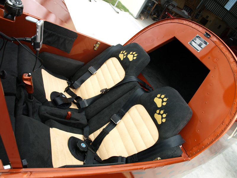

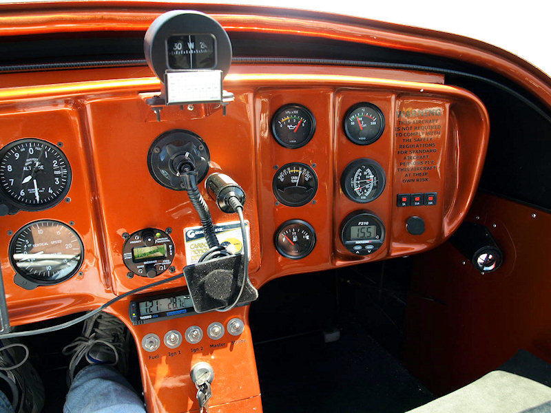

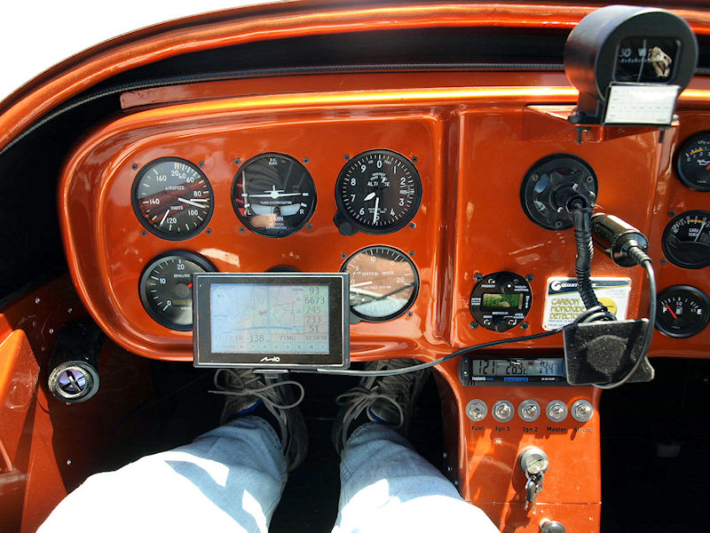

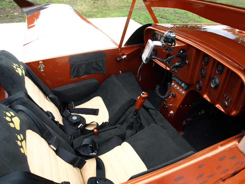

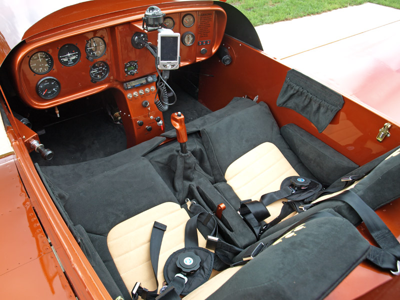

Guest Brett Campany Posted March 9, 2009 Posted March 9, 2009 Hey Ross, can we trouble you for any photos of the cockpit and other close up details photos? I'm keen to check this aircraft out. I don't think there's one in WA though.
slartibartfast Posted March 9, 2009 Author Posted March 9, 2009 Hey Ross, can we trouble you for any photos of the cockpit and other close up details photos? I'm keen to check this aircraft out. I don't think there's one in WA though. There is one flying in WA now. Can't remember where. I'll ask Garry. [ATTACH]7325.vB[/ATTACH] [ATTACH]7326.vB[/ATTACH] [ATTACH]7327.vB[/ATTACH] [ATTACH]7328.vB[/ATTACH] [ATTACH]7329.vB[/ATTACH]

slartibartfast Posted March 9, 2009 Author Posted March 9, 2009 Slarti,Please excuse my lack of knowledge but you mentioned trim with bungies? How does that work Elevator trim is achieved by the use of a bungy loop around the stick near the base and going forward to the steel sub-frame, and then another bungy working rearward against that. In the photos below, that is attached to a lever. Since then I have changed it to a friction wheel. Garry didn't intend it, but I found that I can lift the upholstery velcro and slide the forward bungy left or right to "lean" on the stick. Plenty for aileron trim. It's so effective, I would recommend removing all tension on it (at cruise altitude) when making sure the plane flies straight during initial flight testing.

Guest Brett Campany Posted March 10, 2009 Posted March 10, 2009 Cheers for that Ross, great looking cockpit mate! I'll get down to Serpentine one day and see if I can have a loom at the aircraft down there. Thanks again mate!
tvaner Posted March 11, 2009 Posted March 11, 2009 Great review Ross. I see in a couple of your cockpit shots that the nav. gear changes. ie compass, GPS setup etc. What's the story there?:)
slartibartfast Posted March 11, 2009 Author Posted March 11, 2009 Great review Ross. I see in a couple of your cockpit shots that the nav. gear changes. ie compass, GPS setup etc. What's the story there?:) Cheers Keith. There are 15 months between those shots. The original compass was a cheap temp one because I had trouble sourcing a good one for a while. The GPS broke after 4 years of faithful service, so I got a new one. Eagle eyes. Doug - I realised tonight what caused the confusion over the photos. I changed my options to order posts from newest down to oldest. So I wrote "below" because that's where previous posts are for me. Sorry 'bout that chief. I'll get the photos of the trim system on the weekend. Brett, my photo album went missing from my profile page during the site upgrade and Ian hasn't found it yet, but there are more photos you might like here.

Guest palexxxx Posted March 12, 2009 Posted March 12, 2009 Ross, are your wings on your plane of the removable type? Peter.

Guest palexxxx Posted March 13, 2009 Posted March 13, 2009 Ross, are your wings on your plane of the removable type?Peter. Ross, The reason I ask is because in photo 2 of your post #7 there appears to be a massive gap between the wing and the fuselage, if that gap is there all the time I would have thought that that would have created a major amount of drag and that may have been the cause of your inability to achieve a cruise speed similiar to other cheetahs.
slartibartfast Posted March 13, 2009 Author Posted March 13, 2009 Another bloody eagle-eyed punter. You've got to watch watch you post here ;). That set of photos was taken slightly before completion, and a number of things weren't done at the time - including the wing root lining. There is a 2 inch wide rubber strip glued in place to seal that joint. It provides a waterproof seal, while still allowing the wings to be taken off. Cheers, Ross
