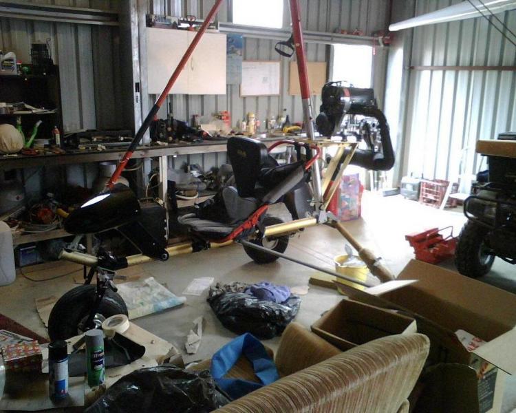

I've decided to try my hand at restoring an old Airborne Buzzard Trike Base. Ive' picked the Buzzard not just because it may (hopefully) have some parts in common with later Airborne trikes like my friend's 1995 Edge Executive trike which shares our hangar, but because it was legally a single seater trike which, as a single seater should give me the freedoms to enhance it with goodies like rear wheel disc brakes, or fit a HKS-700E motor (versus 2nd hand Rotax 503) if I'm feeling that rich further down the track.
Needless to say I'll need to find a good source of aircraft quality bolts & nyloc nuts & possibly 6061 Aluminium tubing, although the tubing I've seen on the trike frame so far all appears to be in pretty good condition in spite of it's age and I may even be looking for ways to confirm this (for example if there's corrosion on the inside surfaces I can't see), or even get the tubes re-anodised.

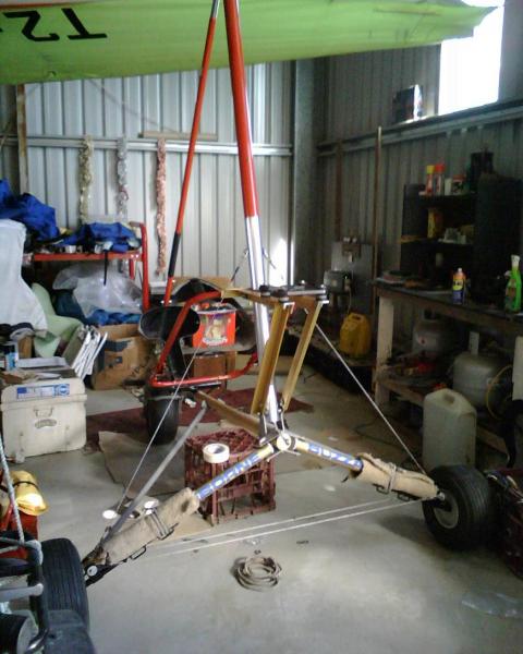

Attached (I think, 268k) photo shows its current state of (dis) assembly, which is how I bought it.
It also came with a fibreglass pod and Rotax 532. Not too sure if the 532 will ever see action again, but will see how it goes on a test bench when I get around to it.

This time I hope, have shrunk it to 126k this time . . . difficult because I have to type in the entire file path every time, starting with "c:"
Yep that is (dis) assembled allright. 006_laugh.gif.0f7b82c13a0ec29502c5fb56c616f069.gif
The seat cushion looks like a 2 seater in the pic is that right? I thought it was only a single.
Thanks for the show and tell and please keep us posted on how it's going, it will be interesting :thumb_up:

Hi Bill,
You're spot on about the seat cushion looking like a 2 seater. But I was always assured by the previous owner that Buzzards were only ever registered as single seaters. HGFA has backed this up. I have no intention of challenging this since the relative freedoms afforded to single seaters will add to the appeal of this project.
I"ve already started speaking with Punkinhead about a new single seat cushion with a luggage bag/box where the rear seat currently is.

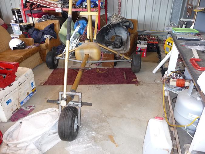

I've taken the trike frame into the hangar and put it together to see what needs replacing and whats missing.
I hope Airborne are in a good mood this week.

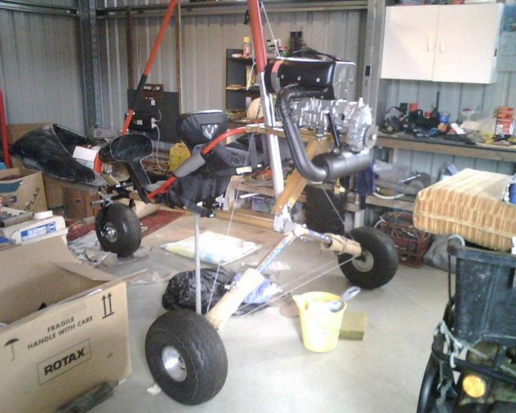

I spent all of last Friday outside the Airborne factory replacing all the bolts in the trike base. All the holes were round, which is good.
The Buzzard generated a bit of interest.
I went home with a new Rotax 503 engine package and a Redback instrument binacle, minus the instruments. (Perhaps well timed to see what can be bought at Narromine a few days from now.)
Tried the 503 on the trike base over the weekend, only to realise that the engine mounting brackets are still attached to the Buzzard's old 532 motor at a different location and some other seat frame mounting bolts had to be re-ordered at the correct length and should be arriving before the weekend.
This coming weekend I'll be checking all the seat frame parts with a dry assembly, though it will all have to come apart again for some painting. Will also mount the engine as I should have all the brackets, rubbers and bolts.
Then, planning the hand the old seat cushion to Punkinhead and agree on a new seat cushion design I hope will be ready by early May.
It was starting to look a bit like a trike base with all the shiny new bolts and the old seat cushion and shiny new intrument binacle in place.

So, I had all of today to tinker with the Buzzard.
1. Fitted the new 503 onto the engine mount, but still want to get new engine mount rubbers even though the rubbers are probably still useable but I'll be happier with new ones.
2. Re-Pitched the 3-bladed Ivo propellor, increasing the pitch by 2 shims. Previously it was set for use with a 532 with a 2.58 gearbox whereas I'll be using it with a 503 and a 3.47 gearbox. I don't want my brand-spankers-new 503 being over-revved so I'll be keeping an eagle eye on on the tacho during the run-in procedure and if it reaches 6800rpm on anything less than full throttle there are still another 2 pitch adjustment shims I can move. If my new pitch setting is too coarse there are up to 4 pitch shims I can use to reduce pitch.

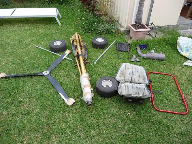

The progress continues, though there's not a lot to show for it at the moment. Have removed the motor and put it back in it's Rotax box again.
Have rubbed back and painted the rear suspension swing arms and front seat mount.

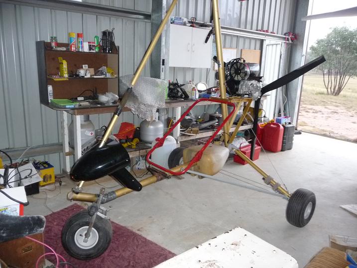

My Buzzard now sports a brand new mast and front brace tube. The FUN part was pre-stretching the internal safety cable with about 300kg of force and locking it in place with the tubular bush through which the bolt goes which connects it to the plates either side which bolt onto the base tube. It's a "Back bone connects to the Hip Bone" song kind of thing.:star:
Thanks to the rack on the quad bike, a few stray lumps of wood, a 5ft steel pipe lever, some big D-bolts and a 2nd pair of hands, the pre-stretching of the cable became possible and was uneventful.
Some basic geometry was engaged to ensure the hangpoint stayed in the same place to avoid trike type COG issues. Basically, if the 3 sides of one triangle are the same length as the 3 sides of another triangle, then you're looking at 2 identical triangles. The front brace tube needed one extra hole drilled and the old hole cannot be accessed with the seat frame locked in place.
The rear suspension swing arms were re-installed and the front seat mount was bolted back on and seat frame mounted to it.
Looks much better now with a bit of strategically placed paint.:thumb_up:
I'm a bit concerned about whether the Tundra forks will fit on the Buzzard base tube and am just awaiting a reply from someone who has restored a Buzzard before and seems to have replaced the forward section of their Base Tube with an Edge-X part.(That's right, I'm not the first)

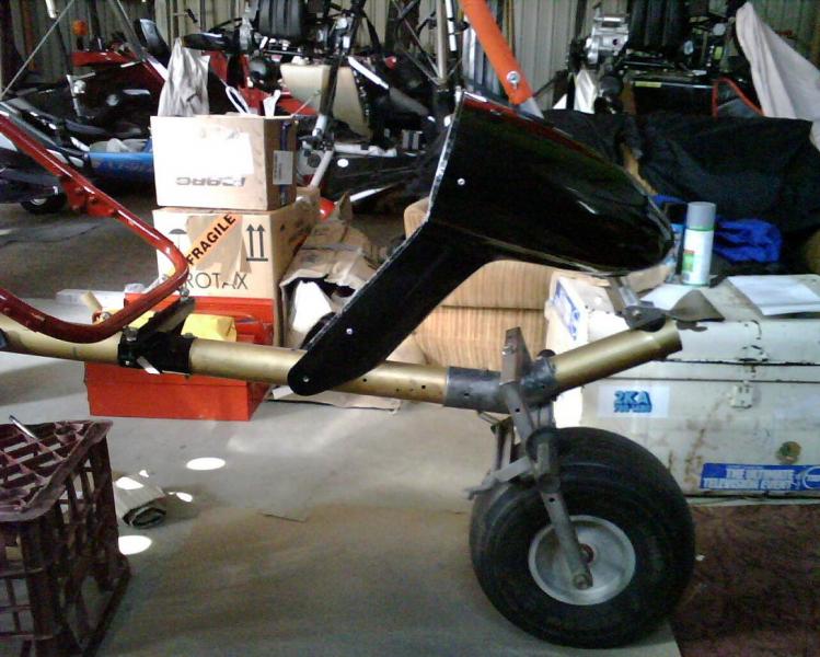

Suprisingly I made it to the farm again this weekend, even after having been up to Taree on Saturday morning. But that's because I went to Taree with my friend in his C172 and we landed back at Camden around 1pm. That's another story.
We collected the Tundra tyres and 1 rim from my friends hangar at Taree, but somehow couldn't make the Wizard wing fit in or on the C172 for the return trip.
The 2 rear wheels on the Buzzard now wear the Tundra tyres and look much better also because I gave the rims some polishing before fitting the new tyres. I'm still waiting on the Outback Tundra Forks from Airborne so the original Buzzard front tyre still lives at the pointy end. The Tundra tyre did not fit in the Original Buzzard forks. We tried . . .
Airborne seemed a bit concerned that the standard Redback exhaust would clash with the Buzzard engine mount, so some photo's were taken to demonstrate this would not occur and emailed to Airborne tonight. So they can go ahead and weld the Redback muffler mount brackets to my exhaust and send it for power coating.

Some good progress was made this weekend with plenty of bits having arrived from Airborne last week.
The Tundra Forks and front axle-wheel-brake assembly was completed and fitted to the front of the trike.
To aid this, the best method of installing new wheel bearing was discovered. ( By pre-heating the aluminium wheel to 200c in the oven and chilling the new bearings to -18c in the freezer, they simply dropped into place without any further mechanical encouragement being required).
036_faint.gif.544c913aae3989c0f13fd9d3b82e4e2c.gif:thumb_up:011_clap.gif.c796ec930025ef6b94efb6b089d30b16.gif
Gearbox oil was sourced at Supercheap according to the Rotax manual specifications and the required 120mL was put in. The gearbox plug was inserted in the top and safety wired.
The exhaust system came back powder-coated last week and was installed onto the motor with the required high temperature anti-seize carbon grease in the joints and the springs were safety wired.
Seat belt was fitted to the base tube and fed through the seat.
The Instrument binacle pod was fitted properly this time by being bolted to the base tube with all the tidy saddles and bolt caps from Airborne. Instruments have been fitted into the panel which is separate and I'm still waiting for a good altimeter which is a couple of weeks away.
