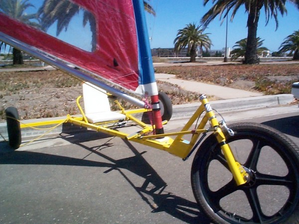

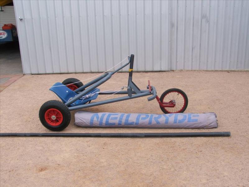

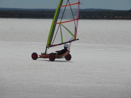

I found the below pics on the net of other homemade ones
we made a few years ago out of pranged hang gliders cut the sail in half down the keel and used off cut tubing for the frame. the only thing that took time to make was the front wheel assembly. raced them up and down the still being built foreshore road at Botany whatch out for powerelines with them. great fun on windy days.
suppose you could use an old hobie sail and rigging bits.

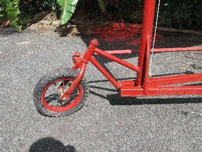

Any photos you have would be great. I have also heard the hardest part is getting the steering head and fork rake correct. So if you have any ideas I would love to know.
Cheers
Guest Evan Cameron

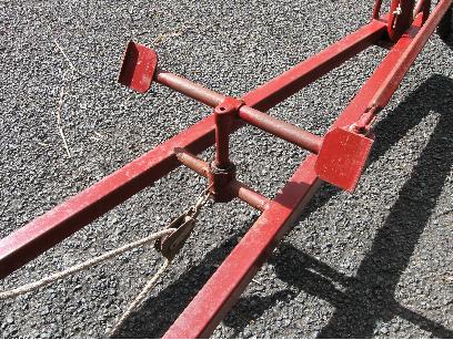

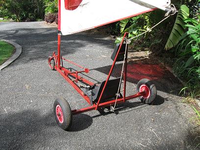

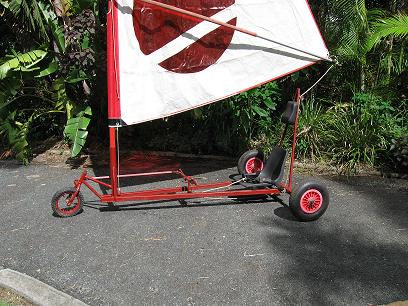

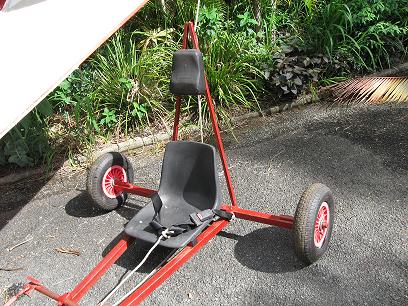

Give me a couple of days to sort out some photos and construction details. As I'm fairly new to this computer buisiness,I'll have to get my son to help. I can say that the two we built cost next to nothing, the back wheels are wheel barrow type ( new), the front wheels , forks and peddle steering etc are made out of a couple of $10 kids bikes from Vinnies, mast posts are exhaust tube,frames are box steel, seats are $2 plastic chairs from the Sallys and the masts and sails were picked up cheap from life line. I must say that I do have my own welder plus oxy /accetylene which certainly helped. My son got the plans off the net but they're not there any more.I'll draw up something with measurements and take lots of photos and get back.:thumb_up:
Guest Evan Cameron
Hope these give you an idea.The overall length is 2.4 m, width is 1.5m. Let me know when you've got it up and running and if you find a good place to sail it.
