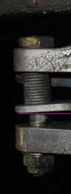

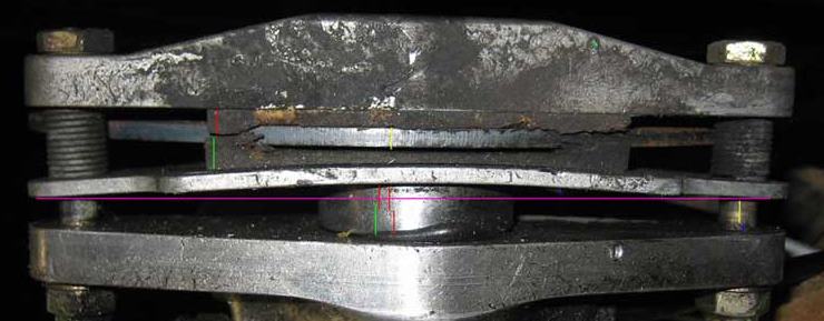

Ah...;) I think I just found his problem.... It's a moving head caliper, right... Take a close look at the springs on the bolts to make it spring apart once it's released... well the spring has closed up to it's maximum ability, which didn't allow the other side to move in (the side without the piston), so cause the piston side to go out farther to compensate which in turn bent the plate with the pad on it.....and pooped out the O-ring....
I'll attach a zoomed up pic of the spring that's closed up to it's maximum ability...
What do you all reckon....???

It's pretty simple really, the brake pads are stuffed and should have been replaced long ago. Add to that that the bolts weren't tightened as the brake pads wore out thus allowing the pistons to over extend and allow the o-rings to catch because the pitson didn't come out evenly.
The second pic from the left and the bottom left pic clearly show the rivets are flush with the pads which means they are worn too far and the rivets are scraping on the brake discs.
This highlights the importance of PROPER maintenance by someone who knows what they are doing!

Didnt pick the problem with the springs tho....
