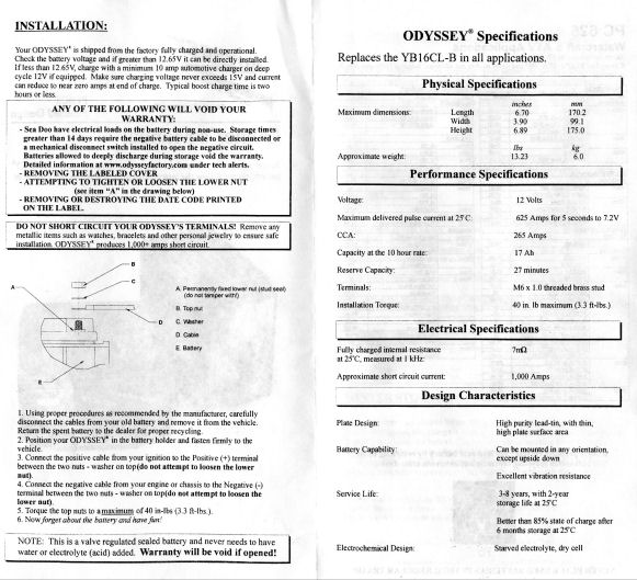

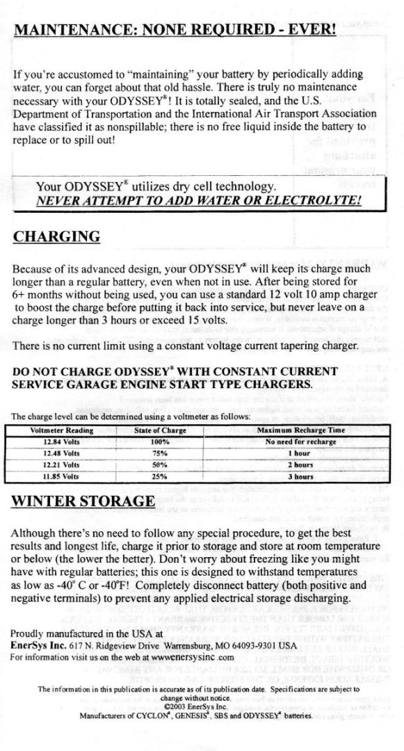

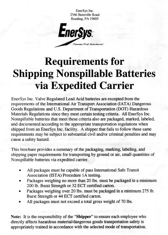

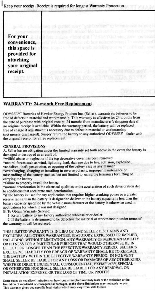

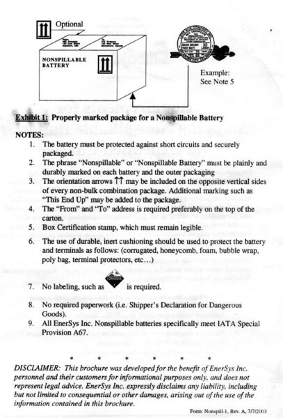

Ross Posted September 23, 2006 Posted September 23, 2006 Hi Louise Jabiru at Bundaburg, Qldsupply Odyssey batteries with the Jabiru kits. The one supplied with the Jabiru J160 is the Odyssey PC 625 see the user sheets below that come with it. Presumably they supply single batteries to anyone. Regards
