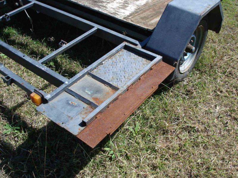

This trailer is original design for the original factory Thrusters and had the mainwheel support pads for the original track. The trailer came out in two forms – what I have designated as the ‘early’ model and then the more refined ‘later’ model (you can get original factory constructions drawings of both free from TOSG).
Try and put a later enhanced model on and they do not fit! This may be exceedingly depressing when you find out about it way beyond the Black Stump, in darkness and you need some engineering, equipment and materials to fix it. Been there and done that!
This is an image of the extension required from the factory original. Even this was not broad enough and needed to be a three inches wider for a good fit. Damn! That was a helluva night – but it worked and I got the BMW T500 Thruster home on it with no damage.

Mine measures 2200mm (no wings, on trailer)

I originally welded some squares of angle onto a 5x8 tandem trailer to pick up the aircraft when first purchased. Then I built a custom trailer to carry it.
