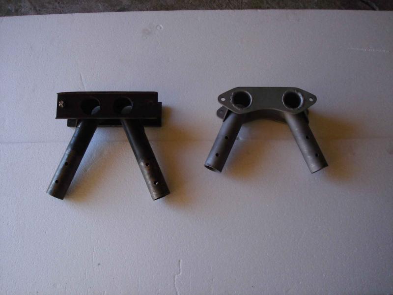

A of I Bracket.
This image shows a comparison between the original and prototype of the new bracket. The new bracket is ‘in the white’ prior to protective coating as it photographs better like this. It has considerably thicker support plates and has been estimated as at least 3 times stronger than the original – not that strength has ever been an issue with these brackets.

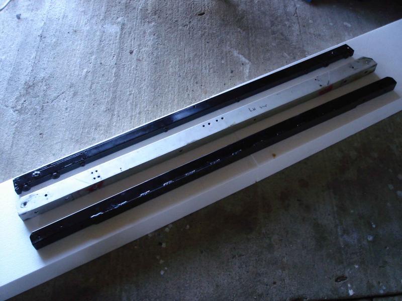

The first image shows a comparison. The original alloy outer is in the centre. Above this is the quite involved heavy duty insert. Below is the replacing beam.
[ATTACH]5984.vB[/ATTACH]

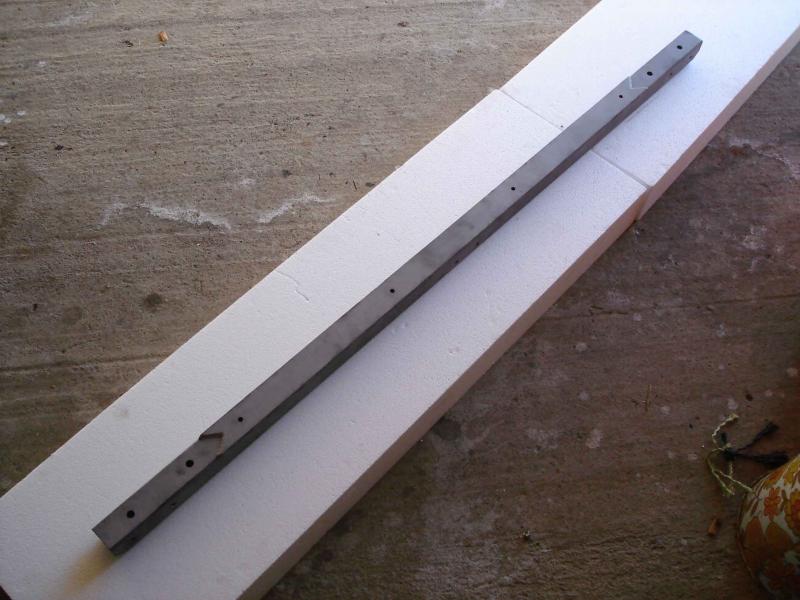

The next image is ‘in the white’ so you can see more of it. This is the undersurface, showing the reinforcing strap welded in to resist bending loads.
[ATTACH]5985.vB[/ATTACH]

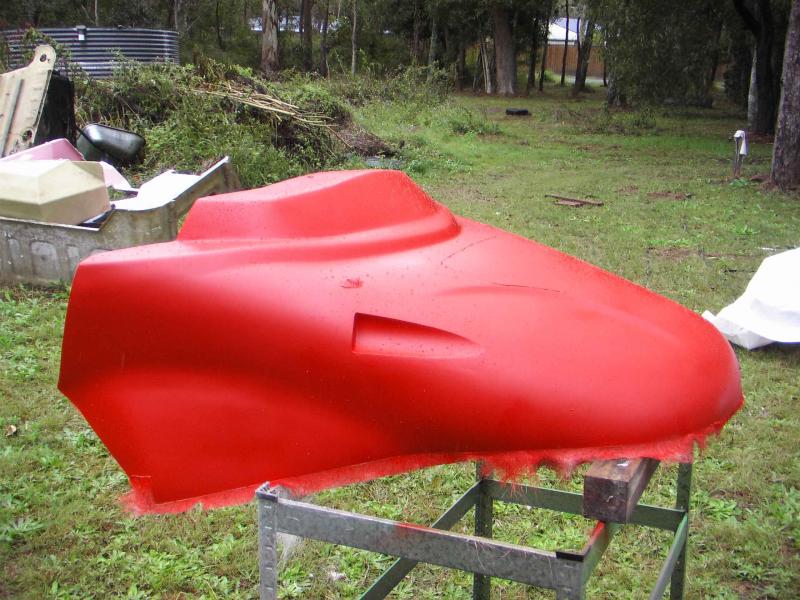

The first image shows the top half of the pod just out of the mould. The colour is cast in during moulding so you do not have to mess about with painting and you can have any colour you like at no extra cost.
Features are the nose fluting, the forward inspection hatch marked out for cutting, the top half of the side anti drag flares and one of the air intakes for the ventilation system.
[ATTACH]5986.vB[/ATTACH]

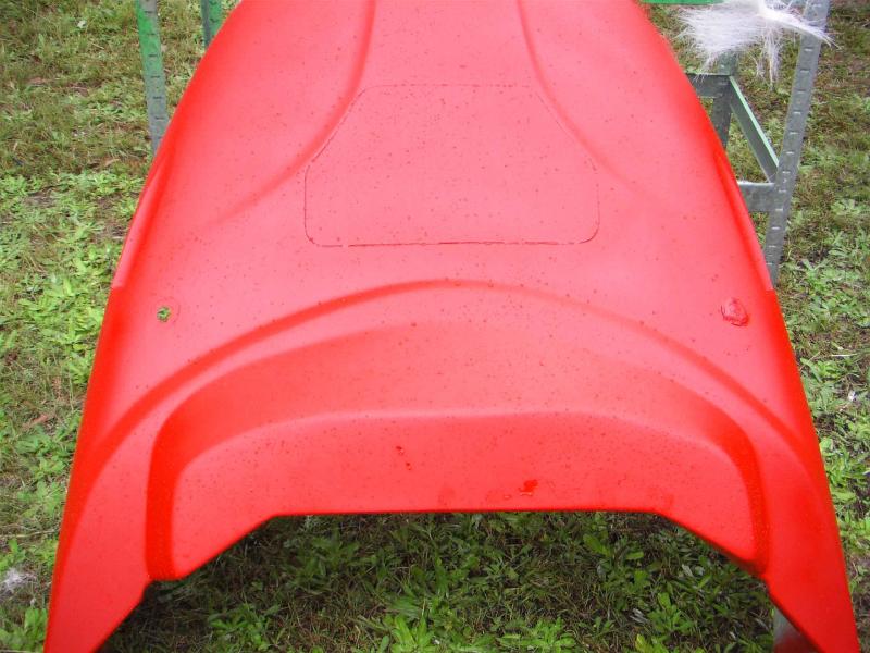

The next image is a vertical view of the pod showing how much the instrument panel moulding has been extended. This will take either the ventilator outlets on the Mk3 or give addition instrument/avionics space in the Mk2 pod.
[ATTACH]5987.vB[/ATTACH]

The new bracket is now in and went in very easily with just a little light line drilling to true it exactly. We hit target with no geometry changes to the aircraft other than the reduced A of I – the T300 primary structure went back together as normal.

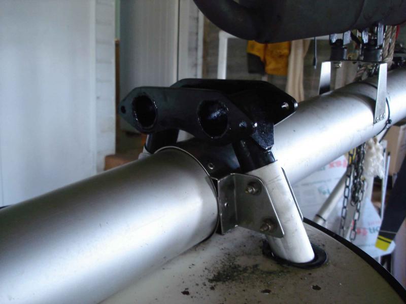

The first one shows the bracket now fully installed.
[ATTACH]6011.vB[/ATTACH]

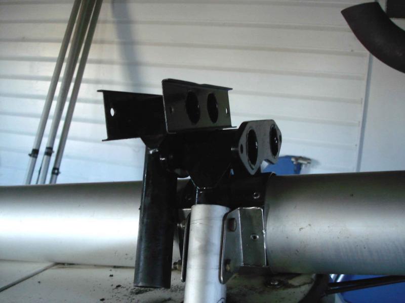

The second has the original bracket parked behind the new one at its normal height. You can see clearly how much height reduction we have managed to achieve.
[ATTACH]6010.vB[/ATTACH]

In one of your earlier posts you mentioned that the re-engineered A of I bracket lowered the leading edge by some 38 mm out of a potential 56mm travel. Is there a Mk 2 bracket in process (or planned) which will go the full monty? If so, what projected availability? If not, how are you going on pricing /delivery of Mk 1?

The only thing I am reasonably sure of is that there is probably not going to be a Mk2 bracket. The main problem is the lower the bracket faces go then the wider becomes the top of the splay. We are running out of room and cannot widen the bracket without impacting on wing span and hence overall geometry.
