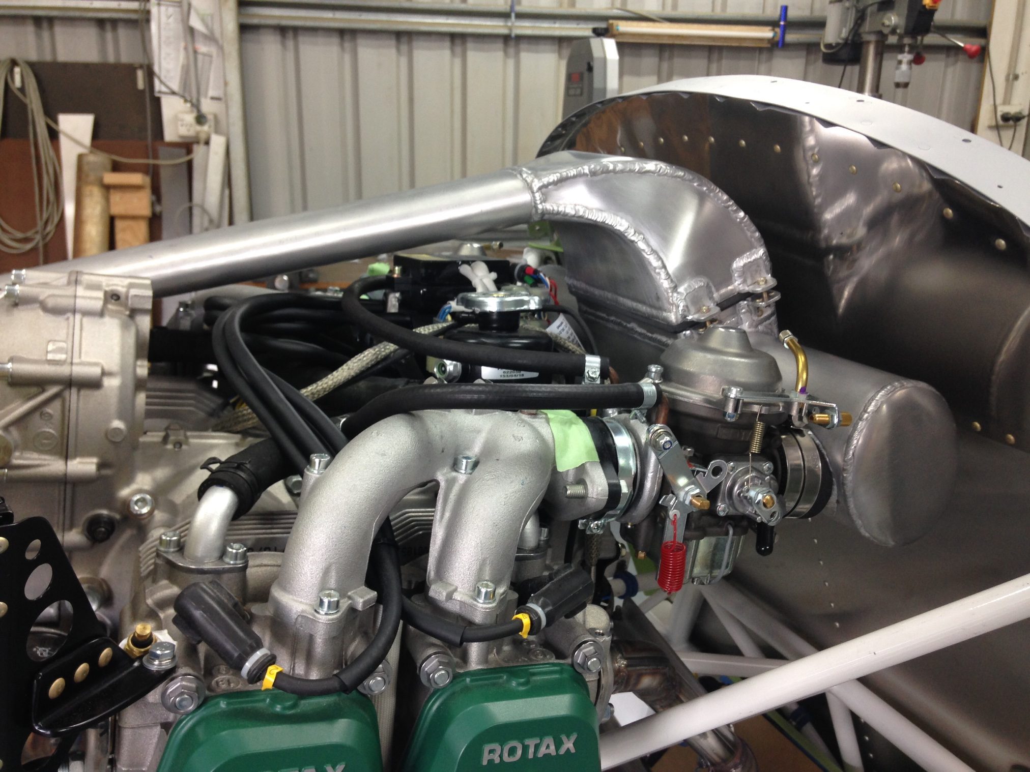

skippydiesel Posted 22 hours ago Posted 22 hours ago I need thin walled, heat resistant, light weight, flexible, about 30 mm (1.5") ID, ducting I have wire reinforced SCAT tubing. The wire is in the way of what I want to do. I have removed the wire but it leaves the "fabric" damaged - it does the job "at a pinch". Would much prefer something similar to SCAT, without the wire. Anyone know of such a product and where I can get it from???? All constructive suggestions welcome.😈

skippydiesel Posted 2 hours ago Author Posted 2 hours ago 11 hours ago, onetrack said: Skippy - What level of "heat resistance" are you actually seeking? (precise temperature range). I fail to understand how you think you can acquire "thin, flexible, heat-resistant" ducting, without it having some kind of internal support. You either have thin ducting supported internally by wire or PVC ribbing, or you have thicker wall, unsupported ducting. A thin wall is not going to support itself, that's why layflat hose lays flat. Ha ha! The hose/duct need not be self "supported" because the gap between the carby & airbox is only about 10mm. Due to the short distance, the wire ribbing of the SCAT gets in the way & restricts some of the relative movement that needs to happen. Temperature Range - From ambient Australian east coast winter, say a rare 0C, to summer, under cowl , post engine shut down 80C. In operation the undercowl temperature is a consistent +10C above ambient. The duct will be supplying outside air, from the air box to the carby(s), so there is the potential for -C (?) temperatures at altitude.😈 1
