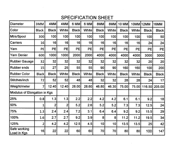

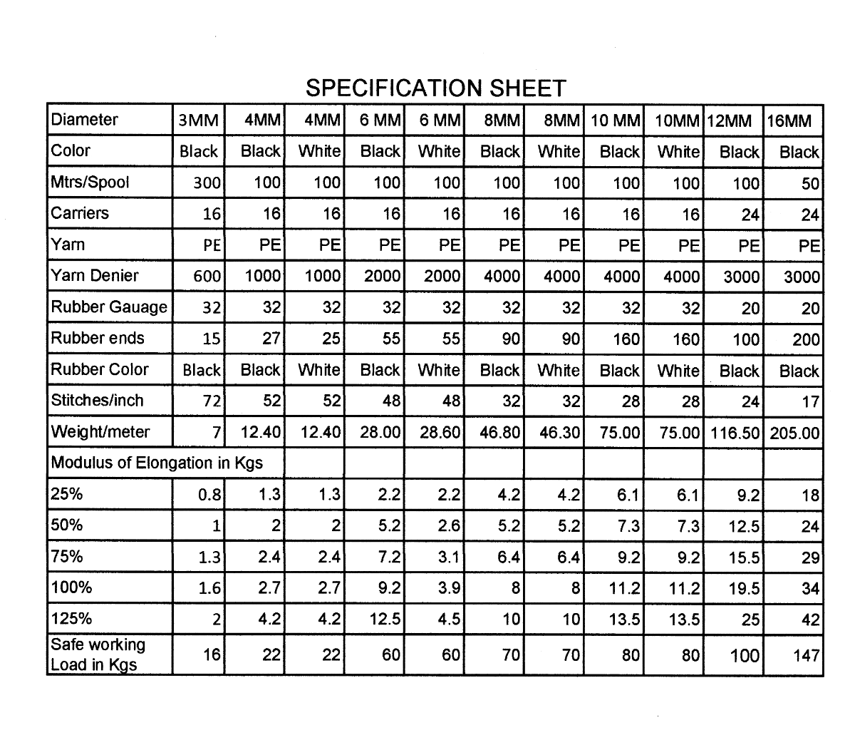

skippydiesel Posted 18 hours ago Posted 18 hours ago I am trying to design a bungee cord, one way trim system for aileron & rudder. The cord will need to be: Strong enough to maintain desired adjustment Weak enough to be easily overcome by pilot inputs ie not impede normal use of stick/peddles Durable - consistent elasticity over time Prefer two diffrent colours, so as to easily ID the two separate systems Able to be used with directional pulleys eg aileron direction of pull, will be away from pilot input direction I could do with some help; Selecting likly cord - guessing 8-10 mm Source of reliable product Finding lightweight pulleys suitable for cord diameter Marine hardware stores would seem to be a likly supplier however pulleys (single) come in a bewildering array of shapes, sizes & cost - max rope size seems to be 5mm - online perusal leads to confusion in the aged mind. 😈
