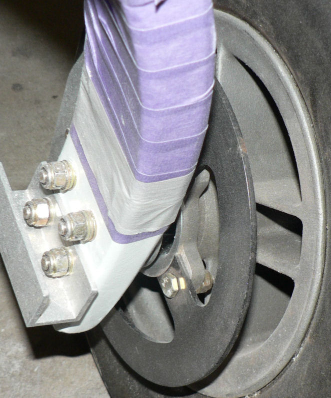

An interesting shot. I would like to know what model and serial number Jabiru that wheel came off. I know that my wheels look qute different and the axels have been modified with a larger radius fillet at the root which is probably the point of failure in your photo. Also the axel is tapered from the fillet back to where the bearings are mounted. That should result in a substantial reduction in the stress concentration in the area of the fillet.
See my photo below which does not show the axel but the considerably different wheel. It is from Jabiru kit J160 serial number 14 despatched in Dec 2004. See attached pic. The brake calipers are not attached at this stage.
Regards Ross
