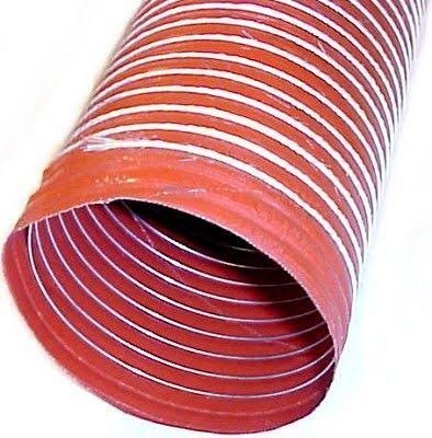

SCAT duct is the one to for induction systems. It has the wire inside exposed. It is used on certified aircraft, cessna beech etc.

SCAT is (usually) good depending on exact type. SCEET is bad. That's the one that has a lining in it to reduce turbulence, however, this lining can come adrift when used in negative pressure situations, such as induction tubing. Some SCAT hoses can also have the outer lining deteriorate between the wire helix and ingest that too, so it pays to keep an eye on it if its' used as part of your induction system.
