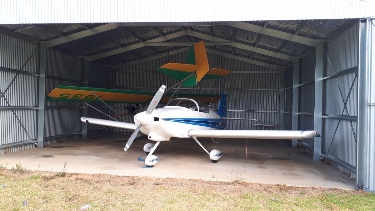

Thruster88 Posted March 28, 2022 Posted March 28, 2022 I had a Thruster single from 85 to 90 and then got a T500 which I still have. Recently bought another T85 single. There is definitely more friction in the cable system compared to the push rods in the t300,500. The ailerons are also deeper cord on the single but less effective than the t300,500. It is just the nature of the aircraft. When the aircraft is flying there would be more tension on the inner cable increasing any friction. The ailerons in an RV are truly amazing however I still enjoy flying the thruster just as much. 2
