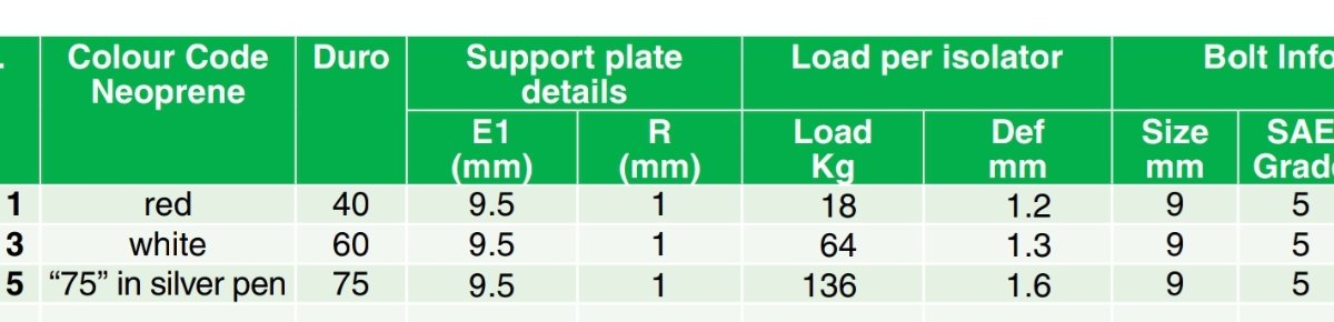

glenT300 Posted May 24, 2021 Author Posted May 24, 2021 So contacted Mackay Rubber and they have something similar but in soft, medium or hard. Which would you all recommend? I was leaning toward the medium. They have a weight capability chart but not sure whether I need to allow for engine torque?
Thruster88 Posted May 24, 2021 Posted May 24, 2021 I would go the medium. Propeller flange torque on a 582 is around 210nm or 2kg on a 1 metre long stick.
glenT300 Posted May 24, 2021 Author Posted May 24, 2021 Awesome. Thanks for that. I appreciate the conformation. Medium it is!
