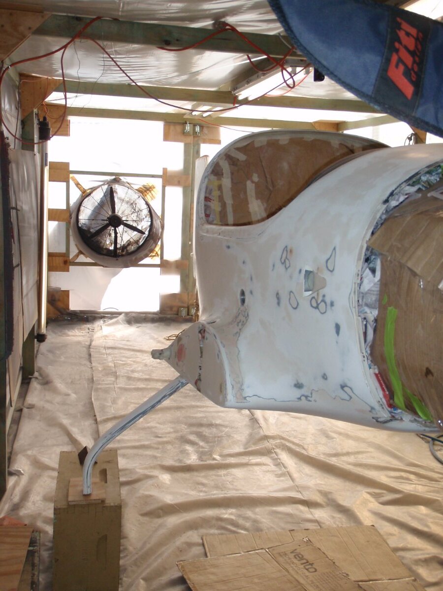

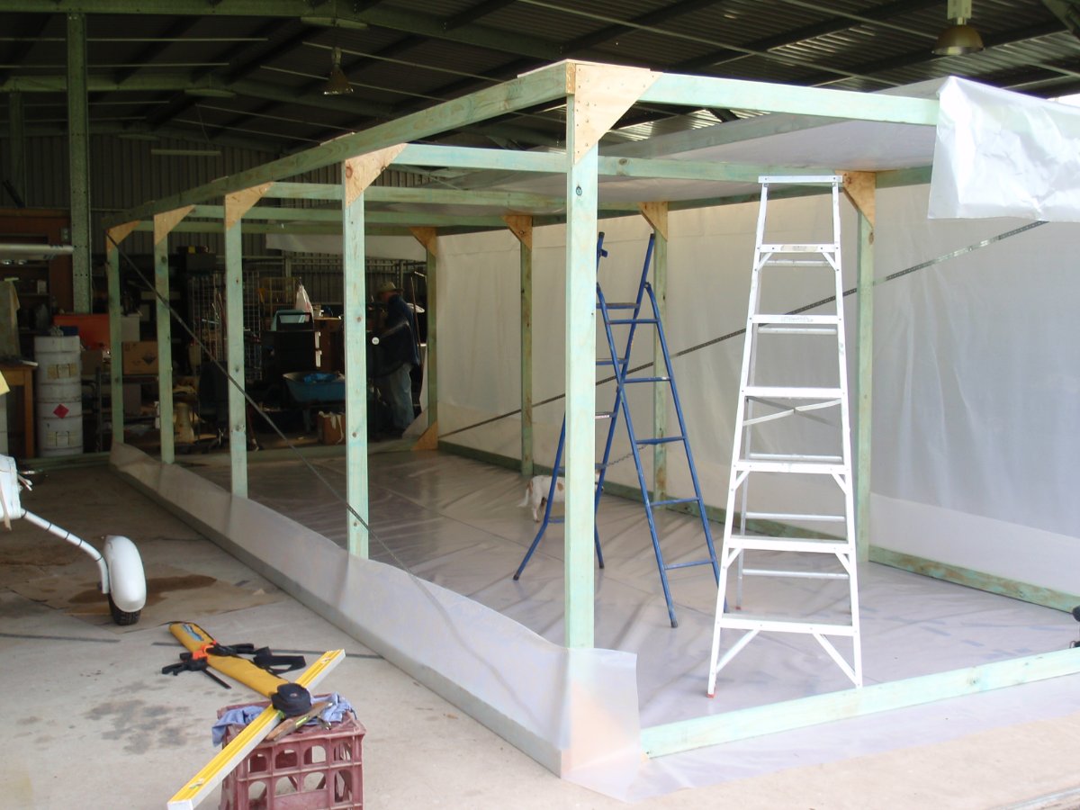

  • I chose to build a temporary spray/work booth so that I could minimise dust/insects in, dust and spray drift out. The dimensions are those that will  accommodate the largest section of the aircraft PLUS room for me to move around (from doubtful memory 8 x 3 x 2 m was a bit on the squeezy side but worked) double doors at one end, one of which accommodate a cheap industrial pedestal fan pointing out (shown)and the other end had a large section of air conditioning filter material  (looking other way, blue material). As many preloved fluro lights as you can get hold off  and you may need a revers cycle window rattler.
  • Should you be interested,P8080250.thumb.JPG.98f9ccb46371e31b96d869de28bfed7b.JPGP2050128.thumb.JPG.22aa92eeec1d44b324f2974c475a98b6.JPG have lots of photos

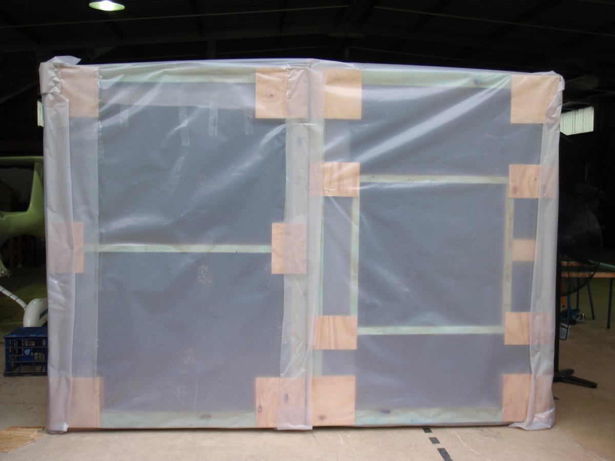

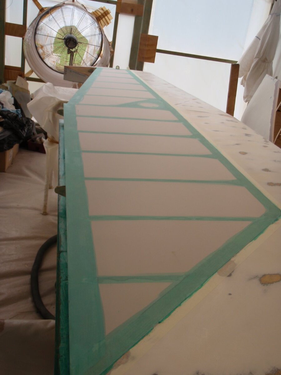

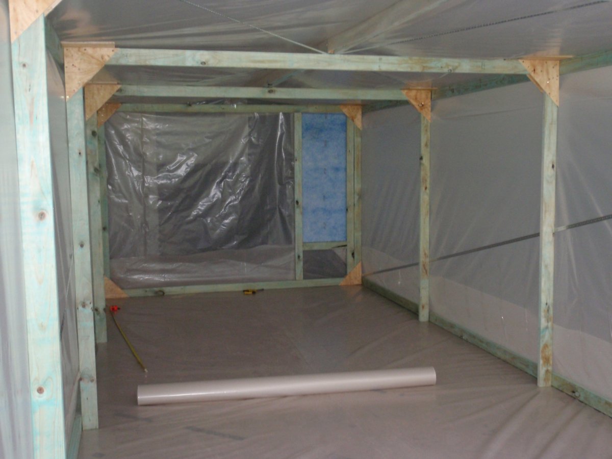

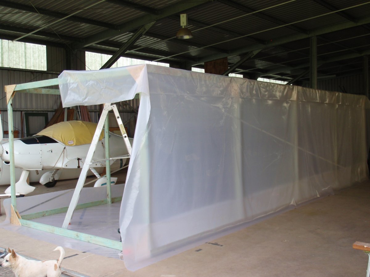

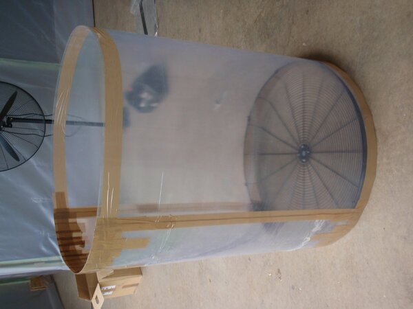

Some better photos of spray/work booth  - I feel it was critical to my good result.
Note:
Plastic (builders plastic) cover include floor, which was slightly flooded for top coat spraying
Air conditioning material , blue panel, can be seen - this provided clean, dust /insect free air

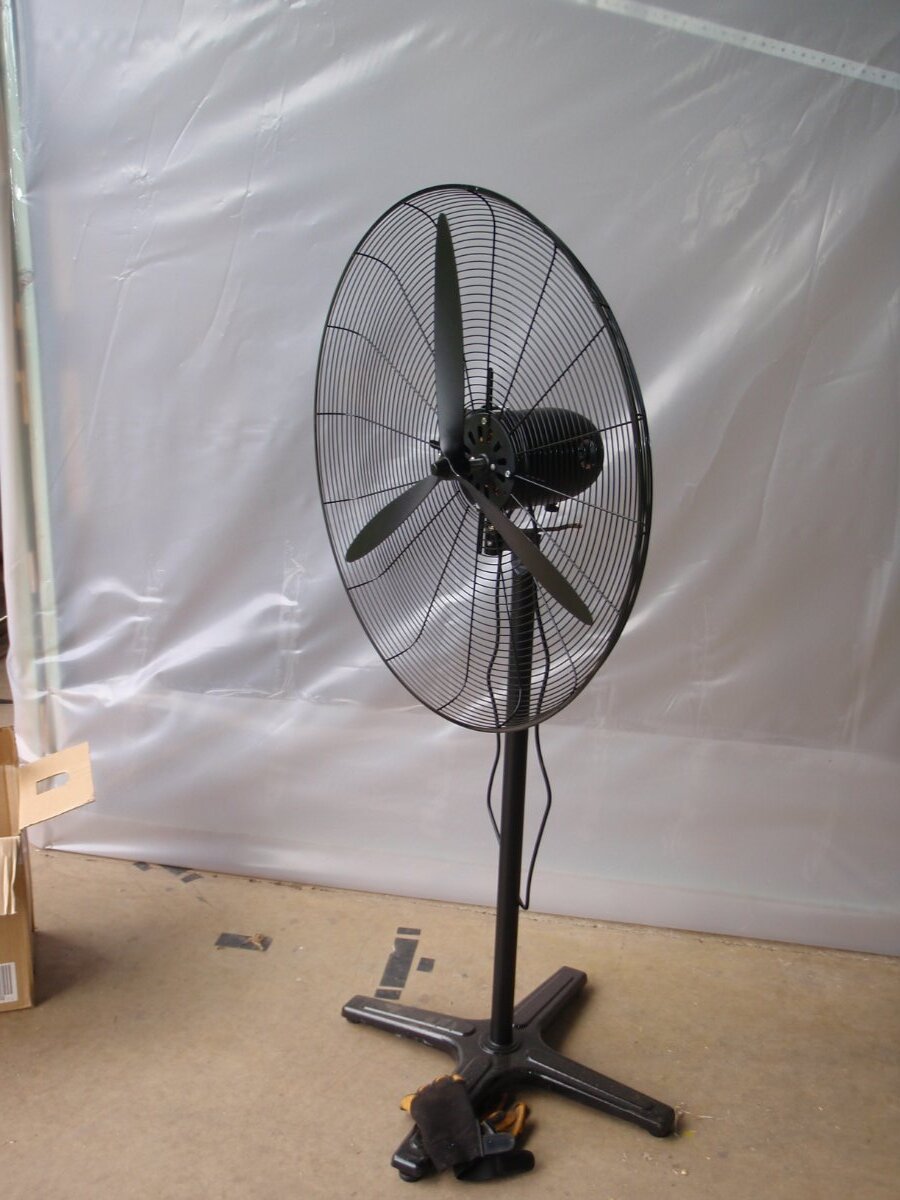

Double doors one end to facilitate large component entry/exit - cheap industrial pedestal fan went in right side (see inner  frame) & used a home made stiff plastic duct & packing tape
All wood  re used for other home projects

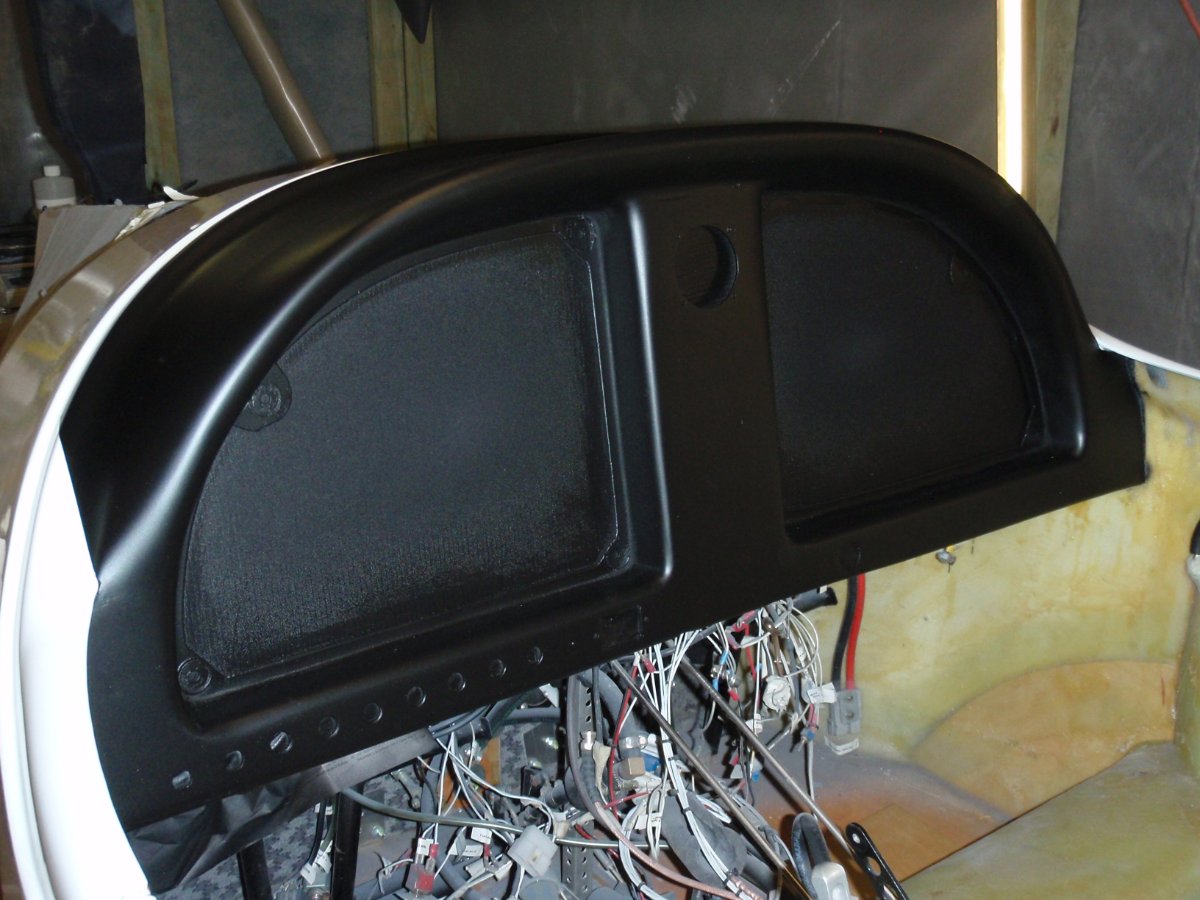

SS have quite a good colour range however as an ametaur, I stuck with one of the whites (Arctic?) and also used a matt black on the instrument panel.

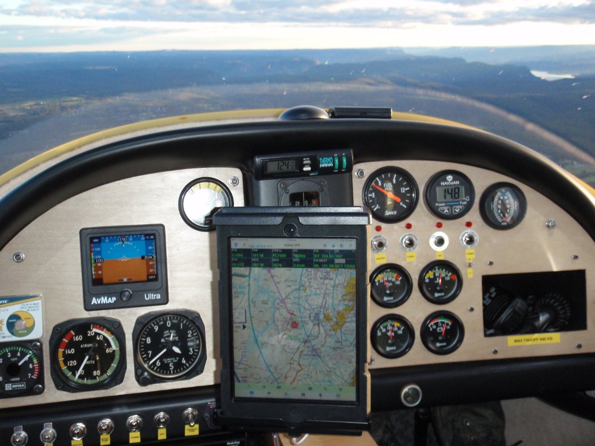

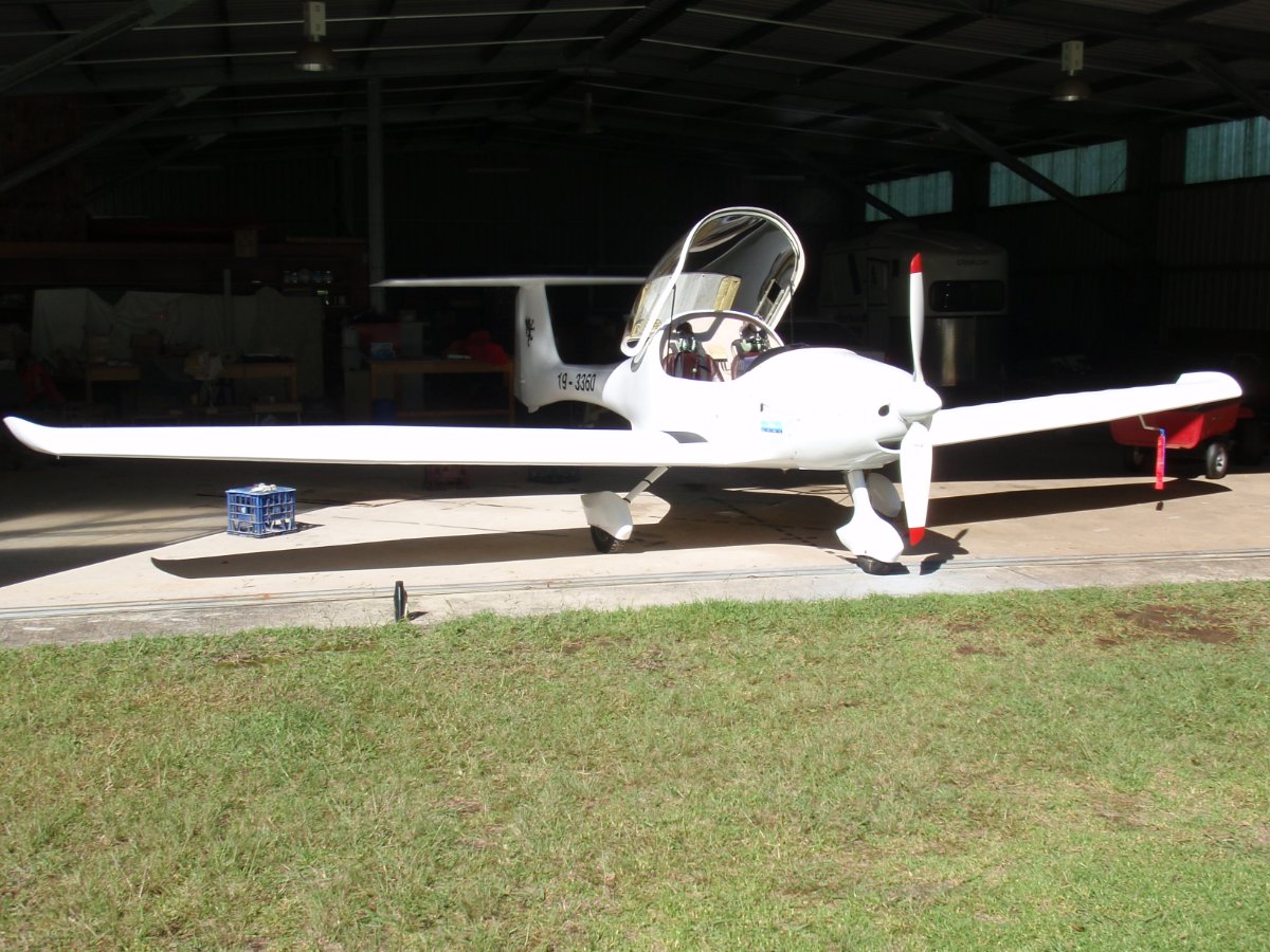

  • Refurbishment DONE!

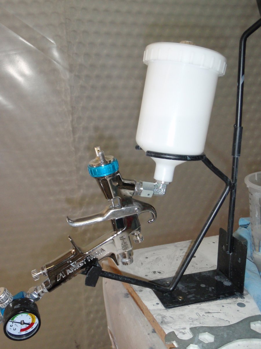

  • Gun modified with hydraulic fitting to facilitate painting under fuselage - I had no way of rotating the fuselage. Did come up with a rotating system for wings.
  • Panel painted
  • Panel in flight

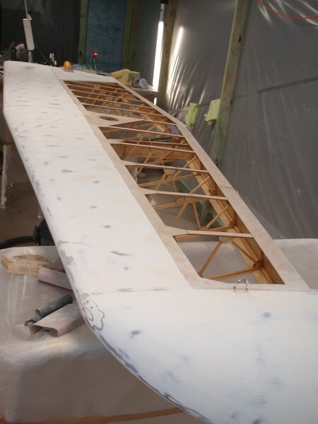

I briefly "looked" at Oratex - cant remember all the details but in the end it just did not suit my aircraft. The Zephyr wing has a ply wood skin from spare - around leading edge and back to spare, see photo of underside right wing. The fabric is glued, shrunk/tightened over the rear /trailing side top & bottom - Oratex, without painting to match plywood skin would look just weird and would defeat the benefit of the product - no need to paint..
P2050128.thumb.JPG.22aa92eeec1d44b324f2974c475a98b6.JPGP2160145.thumb.JPG.2d4ed15c1472eff10af957b7d5fdd990.JPG
