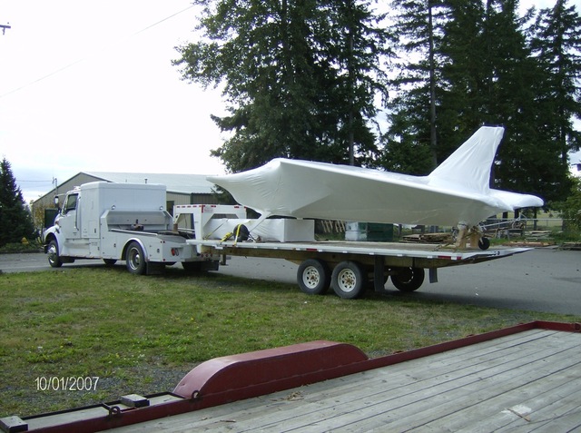

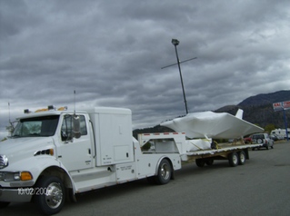

Came across this method that is used for transporting boats by road. As you can see it works quite will for this Glassair that was moved by road across Canada. the material is an unstable polymer similar to tedlar it comes in six foot roles taped together then shrunk with a heat gun. Not only good protection from the elements but a deterent for curious types
