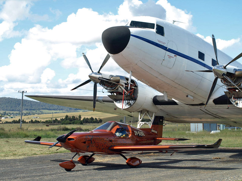

[Soon A C150 may be the same as a DC3. you can pick them up for a song but your 100 hourlies will kick the crap out of you..] LOOKY HERE!!!!! the DC3/C47s are around 60yrs OLD and are still flying with VERY little corrosion on our two at HARS.They where made in a hurry during the war years but they where primed with zinc chromate and it has made all the difference. Cheers T87
Like this one.
[ATTACH]4911.vB[/ATTACH]
She arrived from South Africa some time ago and has been sitting around at Goulburn in the elements for ages. Now she's getting a little engine work and will soon be winging her way to Bankstown for the next stage of her life.
Great to see.
