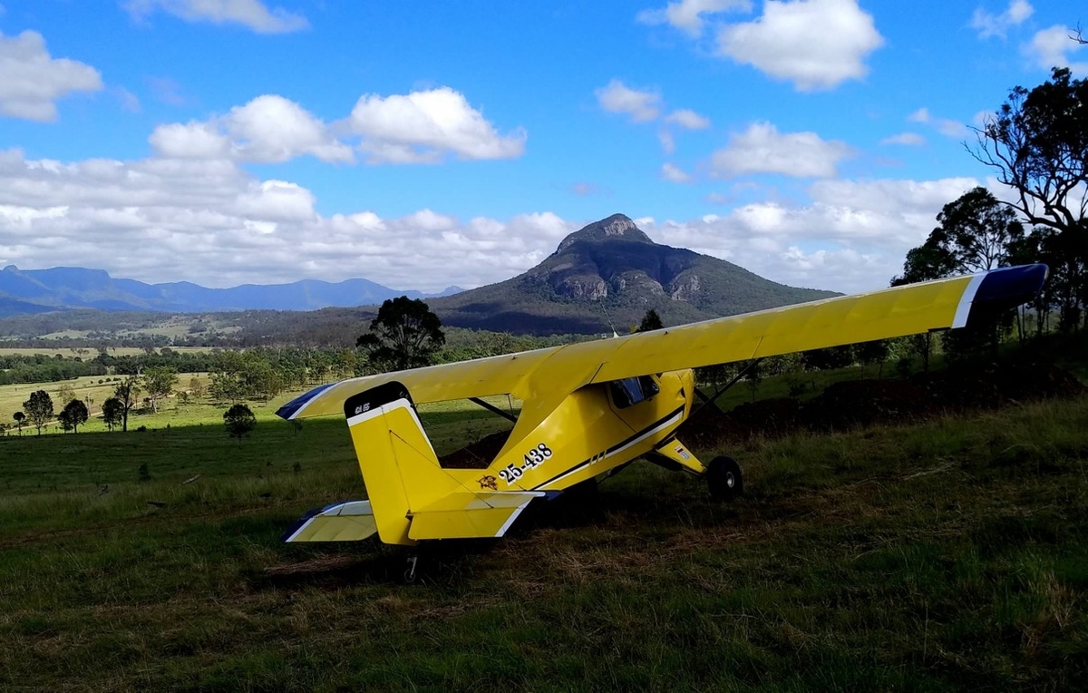

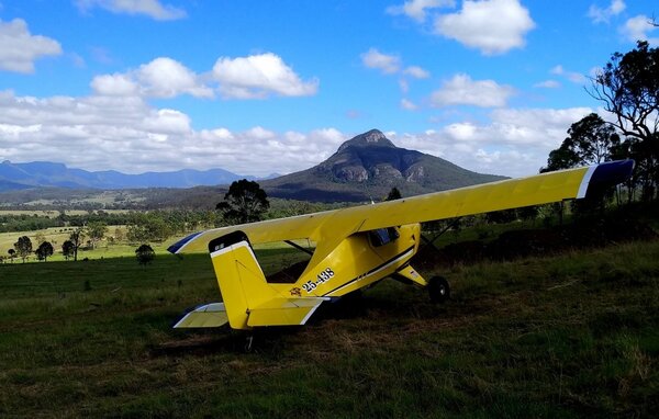

danny_galaga Posted January 22, 2019 Author Posted January 22, 2019 I probably wasn’t clear. The rego painted on the side of his airplane was something like 19-438 when I asked why it was only three digits he said it began (or ended, can’t remember now) with a zero so it didn’t have to be painted on. My question is- if his rego was 19-0438 is it the case you can paint the zero on if you desired? Also, which is it that you would only need 3 digits? 0438, or 4380? If the latter then I don’t have to worry because the number I’m hoping to get ends with a zero, not begins with a zero
ev17ifly2 Posted January 22, 2019 Posted January 22, 2019 I think this guy might be having a lend of you. Section 5.1, 10.2 in the RA tech manual states that the 2 digit prefix, hyphen then the 4 digit rego must be displayed
danny_galaga Posted January 22, 2019 Author Posted January 22, 2019 This is the plane. Nick named ‘Tweety’
ev17ifly2 Posted January 22, 2019 Posted January 22, 2019 25 prefix, early ultralight. Probably old rego or has an exemption, either way long before I started flying.
kasper Posted January 22, 2019 Posted January 22, 2019 Until tech manual 4 the leading 0 was not required to be displayed so 25-0125 could be 25-125 and in addition before tech 4 the 10- did not need to be displayed so 10-0125 could be 125 on the airframe. all of this changed with tech 4 with no leading 0 exemptions and a requirement for 10- display. BUT all aircraft on the register at the date of tech 4 got grandfathered rights to display but you could choose to comply if you wanted. And if if you were one of the one airframes registered in 95-10 after the removal of display requirements in the ops manual but before they corrected the errors in tech 4 on display you have no obligation to display ANY rego marking on the airframe and that right was grandfathered. So so if you see a little yellow trike flying around without markings displayed just listen for the radio if I am using it because I’m legit no rego display and I choose not to voluntarily comply. ? 1
