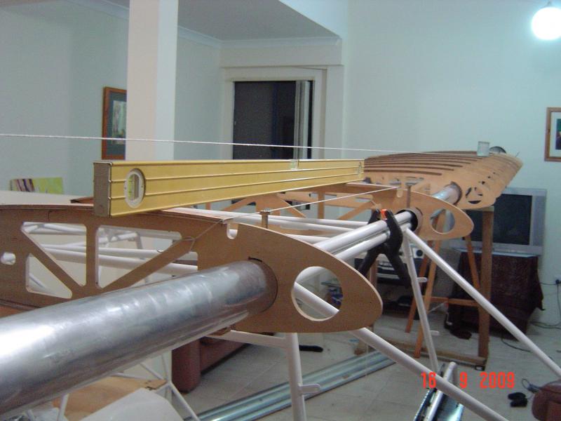

[ATTACH]8672.vB[/ATTACH]guys I was just wondering what your thoughts are about the dihedral,,,, I have set my wings up on props and are just about to drill the wing mount holes ,,,so far I have set it up at 1 , 1.5 , 1.75 and 2 degrees ,,, 2 degrees looks like a heck of a lot however , ,, what would be the lowest setting would anyone know so the flap levers (placed underneath) will clear the fuse? to get the angle I have string lined the wings at 10 foot and taken measurements from another string line from the root ribs,,, any thoughts on this method or is there a better way? Btw yes the plane is in my house ,,,need to drill these holes so I can put it back in the shed but the shed ain't quite big enough too do this important bit and I could never leave my baby out in the cold with no shelter for all this time hehe. in this photo the wings are set at 1.5
Hi Brett,
Can't help you as my pup made "upside down" 2 deg with the flap levers on top....
Regards
SWEDE
