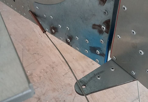

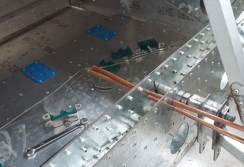

bexrbetter Posted July 15, 2017 Author Posted July 15, 2017 I have had joy with the rudder setup. Early on I wondered about the cable routing and what I was going to use, pulleys, guides, outer casings etc and where they would be mounted. A few days ago I was staring at it all and it suddenly hit me, I might just be able to run a straight line up the middle of the plane, and booger me, I can, yee ha! With nothing more than a few bits of guide tubes to guide them safely through the central wing spar casing and the fuse up the rear, the cables will run almost a straight line from pedals to rudder with only slight disturbance. Here I am using some copper tubing because I had some laying around (always the best reason!) in case you were wondering, I will find some appropriate nylon casing later on, not very critical because as I said, the cable is running almost a straight line. You can actually site the middle of the front copper tubes looking through the rear copper tubes. 9

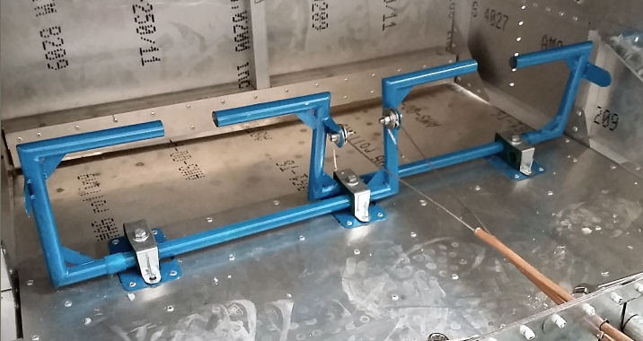

bexrbetter Posted July 17, 2017 Author Posted July 17, 2017 It works! Works damn well too. One finger operation due to cables being basically straight from pedals to rudder and very little friction. Please note the cables are just attached by a couple of flat washers squeezing them for the moment, that of course IS NOT the final fixture setup. 7
Bruce Tuncks Posted July 17, 2017 Posted July 17, 2017 A fixed rudder trim could be added at any time, for example if you wanted feet-off at cruise . But I doubt that it would be necessary because the loading on your feet would not be very much at all. Looking good Bex. 1 1
Marty_d Posted July 17, 2017 Posted July 17, 2017 It works! Works damn well too. One finger operation due to cables being basically straight from pedals to rudder and very little friction. Please note the cables are just attached by a couple of flat washers squeezing them for the moment, that of course IS NOT the final fixture setup. [ATTACH=full]51184[/ATTACH] What are the tabs for on the outer pedals? Was it just to give you options if you decided to route the cables on the outside? I know the 701 is like that - cables run from the outside back to the rudder, pushrods on the inside run forward to the nose leg.
fly_tornado Posted July 17, 2017 Posted July 17, 2017 A fixed rudder trim could be added at any time, for example if you wanted feet-off at cruise . But I doubt that it would be necessary because the loading on your feet would not be very much at all.Looking good Bex. looks nicer if its integrated into the rudder
onetrack Posted July 18, 2017 Posted July 18, 2017 Just a slight diversion from the elegant cable setup - why the amount of work and crude appearance of the pedals, in cutting sections at 45 degrees, that are then welded at 90 degrees and gussetted? Why wouldn't you just form the pedals from one section of tubing, bent with a pipe bender - thus eliminating cutting, welding and gussetting, and ending up with a smooth, professional-looking pedal shape? Is the tubing not amenable to bending? Not criticising, just asking.

bexrbetter Posted July 18, 2017 Author Posted July 18, 2017 smooth, professional-looking pedal . Ouch! Because it's the first set and not final. ... and I don't have a bender at this moment. What are the tabs for on the outer pedals? . Just a foot stop, lets you flop your foot naturally to the side. 3 1

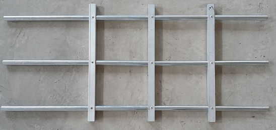

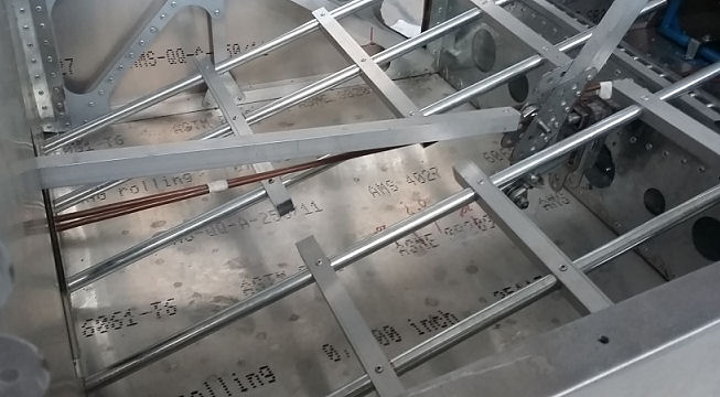

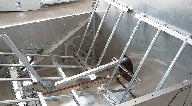

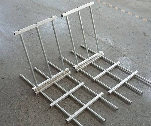

bexrbetter Posted July 18, 2017 Author Posted July 18, 2017 As some realise, everything ties together. Before I can set final pedal and stick positions, I have to understand where a person's body will be positioned, so now it's seat time. Today I worked out some simple base frames, steel round tube through aluminium square tube and a couple of rivets. more work to do yet to fit them into the cabin securely yet easily removed in a single action, and then off to a local trimmers to see what they can do for bases and cushions etc. Don't see too much into these pictures at the moment, there is a plan! 3
bexrbetter Posted July 19, 2017 Author Posted July 19, 2017 More work on the seats today with folding backrest, included the LA (Large American) test of standing on them and jumping up and down violently ... 3
onetrack Posted July 19, 2017 Posted July 19, 2017 I was hoping that there'd be a woven bamboo chair option, seeing as you're aiming at affordable aviation. Those seats look very expensive. 1 1

flyvulcan Posted July 19, 2017 Posted July 19, 2017 More work on the seats today with folding backrest, included the LA (Large American) test of standing on them and jumping up and down violently ... The LA test may not be good enough (I don't know what loads this test imposes). Perhaps as a more measured test, consider sandbagging each seat with 900lbs representing a 150lb upper body at a 6g load factor (4g limit with 50% safety factor) and see how the frames get on. Looking good (the aircraft that is)! 1 1
bexrbetter Posted July 19, 2017 Author Posted July 19, 2017 The LA test may not be good enough (I don't know what loads this test imposes). From a meter is 3.5g. 1.5 meters is 6g, aproximate figures. The "LA" comment was funnier. As I like my ankles, I will not be using me for the final test after I select the appropriate seat base material.
Bruce Tuncks Posted July 19, 2017 Posted July 19, 2017 I don't think the average glider seat would pass the LA test. One time this glider I was launching kept losing its tow-ring when the load from the tug came on. But when the pilot got out, no fault could be found. Yep, the weight of the pilot was distorting the seat down so that it interfered with the release mechanism.This took longer to figure out than it does to tell the story now.
