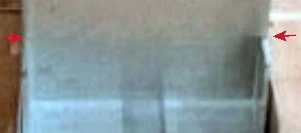

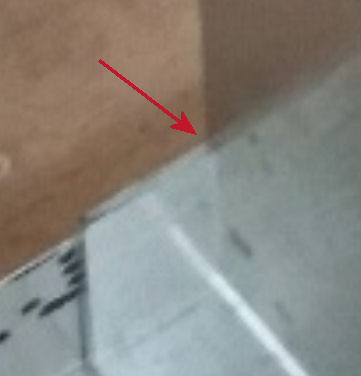

bexrbetter Posted March 11, 2017 Author Posted March 11, 2017 Each rib could have a small notch cnc'd into its leading edge which using a taut fishing line Just a thought for you but I have a sneaking suspicion that you probably already have this potential (minor) issue resolved. Each rib has a shoulder cnc'd into it that keys it to the spars, I do like the fishing line idea as a secondary check though, thanks. If not, a potential solution could be to have a separate rib and flange with each flange being bent to 90 degrees and pre-drilled only on the rib face but not on the spar face. The spar face could be back-drilled through the spar mounting holes after clamping the flange to the spar in its required location. As Fonzie would say, "Correcto mondo". It was always the plan and had already been executed on previous wing examples, probably shown in this thread somewhere. I'd go look for it myself, but it would be depressing to see how much time has passed since ... 3

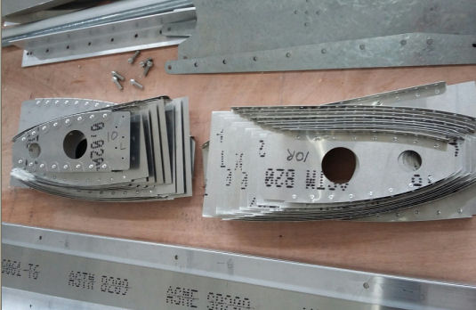

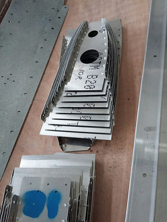

Marty_d Posted March 13, 2017 Posted March 13, 2017 Fantastic work Bex. I'm very intrigued by that method of making ribs. How would the weight compare to an equivalent with non-riveted flanges? From an engineering viewpoint view would your solution be any weaker than a bent flange? One of the things I like about your concept is that the exact rib size can just be CNC'd out, which makes it very easy for tapered wings. To make my ribs I had to first make wooden forms with provision for relief valleys, clamp and bash the hell out of it to bend the flange over, then fiddle about with each one for ages afterward to take out any warps. And that was just for ribs the same size as the wing is constant chord. Can't imagine fabricating several different size moulds for tapered wing, much less the elliptical shape if I ever end up doing a Spitfire. Your method on the other hand takes out the work and also doesn't warp. You mentioned in a previous reply to Kasper that you'd done flanges at non-square angle to account for wing taper - how'd that work? Just a gentle curve in those flange strips?
bexrbetter Posted March 13, 2017 Author Posted March 13, 2017 I'm very intrigued by that method of making ribs. How would the weight compare to an equivalent with non-riveted flanges? The same eventually when I optimise it later, plus the rivets. Weight is weight, sure, but the rivet weight is miniscule. I don't spend a lot of time on optimisation currently in case I change the part designs so I expect this actual craft's result to be about 10%~15% heavier than what it could be. From an engineering viewpoint view would your solution be any weaker than a bent flange? It's stronger - but also irrelevant, ever heard of, or anyone ever mention a fear of rib failure? Doesn't happen. One of the things I like about your concept is that the exact rib size can just be CNC'd out, which makes it very easy for tapered wings. To make my ribs I had to first make wooden forms with provision for relief valleys, clamp and bash the hell out of it to bend the flange over, then fiddle about with each one for ages afterward to take out any warps. And that was just for ribs the same size as the wing is constant chord. Can't imagine fabricating several different size moulds for tapered wing, much less the elliptical shape if I ever end up doing a Spitfire. Your method on the other hand takes out the work and also doesn't warp. Geez, You summed it up near perfect. 1 hour for the laser (including travel), then about 4 hours to clean then rivet both wing sets, including me hand drilling and de'bur all the holes. Or if you like, a long day or weekend to have a full set of tapered wing ribs done (this is just the D box ribs, remember the other side of the spar needs doing as well). QUOTE="Marty_d, post: 604806, member: 7951"] You mentioned in a previous reply to Kasper that you'd done flanges at non-square angle to account for wing taper - how'd that work? Just a gentle curve in those flange strips? Yes, about 93+ degrees, mileage might vary. There's more trickery to it though, need to be careful to understand that the inner radius of the flange is that, a radius, and that the squared edge of the rib doesn't like to match up, all cured by a simple little trick when assembling them that actually kills 3 birds with one stone. I'm uncertain if to match hole them or not, as it's so simple to do and impresses the powers to be for the 51% rule of actual fabrication work undertaken and learnt skillz for your Repairman's Certificate. ....... You should build your Spit through me, I'd do it at material cost + short labour, and then you would have a dirt cheap plane and I would have a marketable item with development costs partially paid for by you. 5
