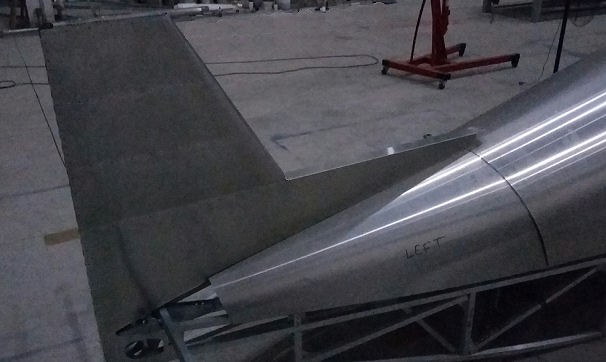

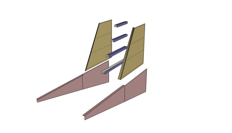

bexrbetter Posted November 7, 2016 Author Posted November 7, 2016 So need to get serious about the rudder and dorsal fin now. I have looked at various methods but most of the methods used to take a vertical surface from a horizontal surface don't really grab me, so I have made a vertical surface to begin with simplify and put fastener loads in shear rather than pull. I have simply split the rear section of the turtle deck, added a spine, which adds a lot of strength anyway, and will take my fin/ruder vertically from the sides of the spine, built a basic mockup of it today and works well, looks something like this 3
kasper Posted November 7, 2016 Posted November 7, 2016 Simple design but consider the fact that without a fin root fillet and/or a lot of fill you are creating a water gathering channel along both sides of the fin base - corrosion control in this area might be an issue 1
Marty_d Posted November 7, 2016 Posted November 7, 2016 Neat solution. Simple design but consider the fact that without a fin root fillet and/or a lot of fill you are creating a water gathering channel along both sides of the fin base - corrosion control in this area might be an issue It should be fairly tight - wouldn't a narrow fillet of silicone solve that? 1
kasper Posted November 8, 2016 Posted November 8, 2016 Neat solution. It should be fairly tight - wouldn't a narrow fillet of silicone solve that? Yep it would ... but without it its a seam with a fold line that will allow water to sit in the seam ... airframes sitting outside for long periods tend to have issues with corrosion on these type of seam. 1

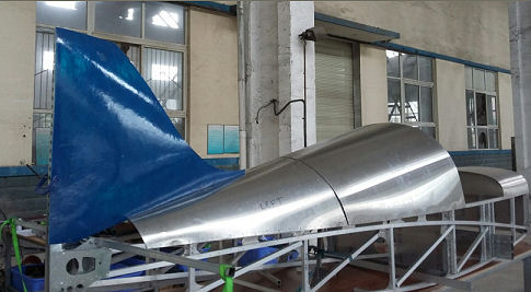

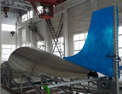

bexrbetter Posted November 8, 2016 Author Posted November 8, 2016 Correct. Simple 3D's don't show all detail. There are weatherstrips of various profiles that will do the job, or sealants as mentioned. So starting mapping it all out today, testing rudder shape with an old bit of blue fiberglass, should get a result in a few days time. You can quite clearly see the spline here and the gaps are because it's only got a couple of rivets holding it all together, as is the entire turtledeck also only held on by a few rivets .... 7
kasper Posted November 8, 2016 Posted November 8, 2016 Correct.Simple 3D's don't show all detail. There are weatherstrips of various profiles that will do the job, or sealants as mentioned. So starting mapping it all out today, testing rudder shape with an old bit of blue fiberglass, should get a result in a few days time. You can quite clearly see the spline here and the gaps are because it's only got a couple of rivets holding it all together, as is the entire turtledeck also only held on by a few rivets .... [ATTACH=full]46766[/ATTACH] [ATTACH=full]46767[/ATTACH] [ATTACH=full]46768[/ATTACH] Wow!! you really like directional stability don't you? That's a HEAP of side area behind the CofG to keep it dart like ... but consider that the IMO huge fin will need a really strong spar to take side loads you might consider reducing the fin area a bit to allow lighter spar/fin primary structure ... weight that far back is really hard to deal with and on a first build you NEVER get the damn CofG where you want/expect it ... and long battery cables to deal with a CofG unexpected outcome are both unattractive and add quite a lot of weight if current drop is not to be an issue.
bexrbetter Posted November 9, 2016 Author Posted November 9, 2016 Wow!! you really like directional stability don't you? More to do with the angle of the pictures, the stab area is safely large'ish, but not huge. Looking for a nice, soft to fly cruiser, not a Lancair. 2

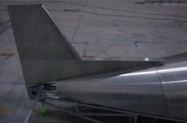

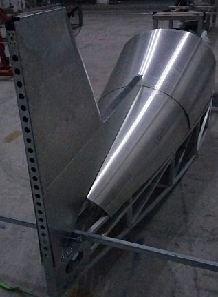

bexrbetter Posted November 21, 2016 Author Posted November 21, 2016 So there's all these little things being done that will suddenly all come together over the next couple of weeks I hope, and that will go from looking like I'm doing sweet nothing at the moment, to suddenly advancing forward in great steps. I did a dummy run with the tail design today after many, too many, iterations trying to find a simpler, cheaper way. Came down to, for the moment at least, a pretty simple, almost 2 dimensional in feel, aluminium design that's stupidly easy to make, and due to some importance in alignment, even has "matched assembly holes". First run ever had it assembled in less than an hour with mistakes and adjustments (pre cut and bent parts). The tail is sitting 50mm~2" too high as it needs to be slipped in down through the rear/rear tutledeck yet (see post #541 and #545 above). 7
