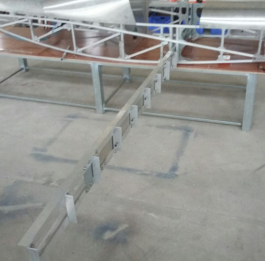

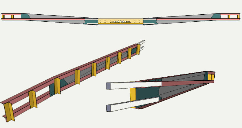

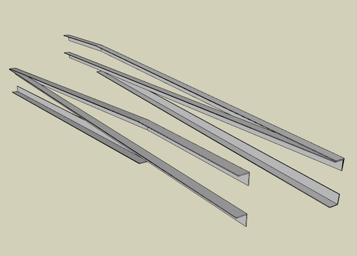

bexrbetter Posted October 13, 2016 Author Posted October 13, 2016 The gullwingwing designs are almost finished after many minor structural iterations to make sure they can be easily replicated and repaired at home. I would have had one done today had I had electricity, there's a building being constructed nearby and the local area power gets shut down occasionally for them to install stuff. The primary structure is of aluminium angle and the assemblies are bolted together, very strong, not super light but not terribly heavy either, but importantly, cheap to build using common materials and replicable techniques. 3

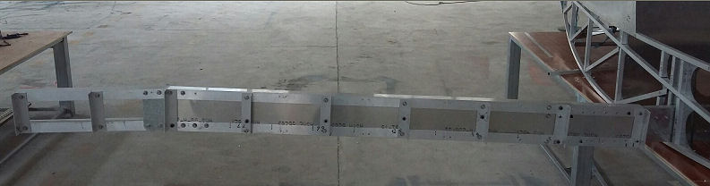

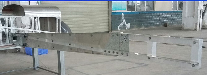

bexrbetter Posted October 14, 2016 Author Posted October 14, 2016 ... and turning it into reality, although a bit to go yet, rivets would be nice, tomorrow maybe ..... 6

Marty_d Posted October 15, 2016 Posted October 15, 2016 ... and turning it into reality, although a bit to go yet, rivets would be nice, tomorrow maybe ..... [ATTACH=full]46268[/ATTACH] [ATTACH=full]46269[/ATTACH] [ATTACH=full]46270[/ATTACH] On the final version is the spar web solid riveted to the extrusions?

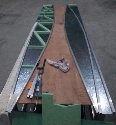

bexrbetter Posted October 28, 2016 Author Posted October 28, 2016 So ... I popped into my fiberglass guy who I have been using for the past 10 years, little backwoods town out in the sticks, to do my wing rib sets from the basic patterns I whipped up - well computer designed, then laser cut and tacked some flanges around them .. The Foreman there is a great guy and we get along well, but they were a bit limited to basic polyester products, but seems in the last 18 months some changes have taken place and not only do epoxies now, but also carbon fiber. There was a build method for my plane that I wanted to do early on but deferred because I was limited (locally) to polyester. But now that I can do epoxies, I started immediately today to make a pattern to try out my experiment of using a very bare bones aluminium longeron frame, sandwiched by a structural inner fiberglass sheet and, of course, finishing outer fiberglass sheet. Think of it as a "skin and bones" approach. Will take about a week to get it together, so stay tuned .... 3

bexrbetter Posted October 29, 2016 Author Posted October 29, 2016 You and me, we have something in common : can't quite get one thing finished before I think up another "brilliant" idea, and off we go again My wife tells me about it all the time It changes very little of the basic foundation I have now but does get rid of most of the little connecting bracing tubes that do take a chunk of time to measure, fabricate and install. It also increases accuracy as it's self jigging, and always from the same mold. I did mention I had already considered it but it was the sourced material available, ie. polyester, that stopped me from preceding at the time, in other words it's not actually "another idea". Please understand this isn't a single build which would have been finished long ago, this is an item for production that needs investigation to get the best combination of cost, ease of construction, transportable without damage, sit in a bloke's shed corner for months suffering knocks and bruise, etc, - many things to consider. 4
bexrbetter Posted October 31, 2016 Author Posted October 31, 2016 So I whipped up a couple of dummy sides and starting laying some foam strips to form the fiberglass inner structural shape I desire .. 1
