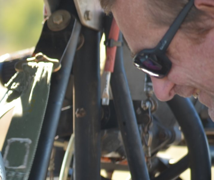

This is the bellcrank on an Austflight Drifter. You can just see the pushrod running vertically to the aileron horn which is at the inboard end of the full span aileron.
Talking to Lockwoods may be your best bet.
