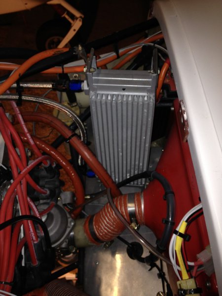

I'm not a fan of the oil line connectors used in Jab installations. I did mine using AN6 fittings and braided Teflon lines. These won't fail in a hurry.
For those interested my oil cooler installation and changes to air management has resulted in very good (low) CHT's. Just done the 75 hour service and there has been no 'head recession'. No movement in head bolts and tappet clearances stable.
