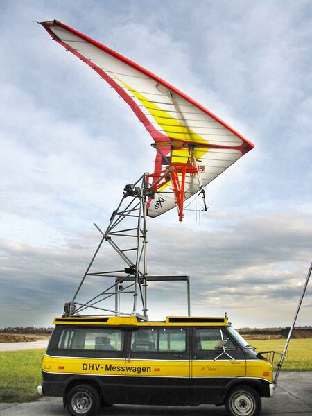

The pitch test rig in Germany is an amzng expensive piece of equipment. This vehicle is fitted out with several computors and has a massive steel support arm above which a wing is mounted... and can be hydraulically moved in the pitching axis whilst driven at nominated speeds - forward & in backward flight attitude positions!
This method of flexwing aerodynamic pitch testing allows the crew to position the wing beyond normal flight pitch attitudes. Confirmation of the wings lift characteristics is substantiated by video footage & lift coefficient tags which confirm the correct CG position, operation of the reflex trailing edge bridles and the leading edge round/twist performance of the airframe. The computor software is able to replicate by mathimatical algorithm the aerodynamic performance of the wing under test and by digital printout the wing either passes or fails the acceptable NAA Design Requirements for flexwings.
Therefore...the cost is enormous to have a wing tested & certificated under the DULV rig.. the manufacturers of Europe build great flexwings and they are expensive.. But the security and safety is more important to me, when you fly a wing that is pitch approved ..especially if the air is big, rough and unpredictable!! A DULV pitch tested wing has a defined accurate sense in all flight attitudes.

Not sure if my attachment file is goin to happen..? ... you should be able to view an Air Creation iXESS 15 mounted on the German DULV Flexwing Pitch Vehicle in 2002.
Chris:yin_yan:
