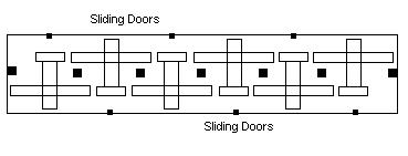

Admin Posted September 25, 2007 Posted September 25, 2007 I saw what I think is the best utilisation of hangar space that you could get down at Tyabb recently. They have a hangar that has doors on both sides and pillars running down the middle of the hangar. This way the aircraft go in nose to tail and with doors on both sides means you don't need to move an aircraft to get any one of them out - see attached layout. Anyone have any comments on this design and also any suggestions on who would be the best people to get a hangar kit made in this layout - best price etc
eastmeg2 Posted September 26, 2007 Posted September 26, 2007 No good for Trikes with those pillars in the middle.
Admin Posted September 26, 2007 Author Posted September 26, 2007 Eastmeg - what's the general width of a trike wing? Also, perhaps you don't need as many pillars down the middle - it would all come down to cost in terms of cost per metre of span. Just looking at it roughly it would say be about 36m x 10m = 360sqm to comfortably fit 6 aircraft with each one having their own sliding hangar door - how does that equate to a normal hangar of about 360sqm - how many aircraft could you fit into that size normal hangar - just curious if this layout is more economical in terms of space. Although, with this layout you would need access from both sides but then if you put these types of hangars parallel to each other it would be even more economical in space with a taxiway between the hangars. The added advantage is that you can always "addon" extra modules to the end as the need increases. Just rambling thoughts

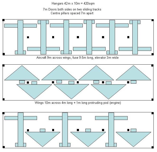

Admin Posted September 26, 2007 Author Posted September 26, 2007 Attached is a design drawn up to scale for reasonably sized aircraft
Guest browng Posted September 26, 2007 Posted September 26, 2007 Attached is a design drawn up to scale for reasonably sized aircraft If you alternated the trikes nose to tail it looks like you would have less wasted space, and maybe get an extra one in?

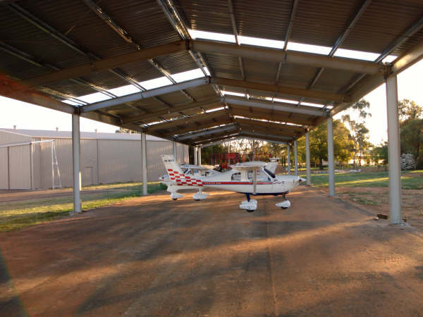

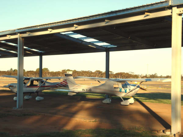

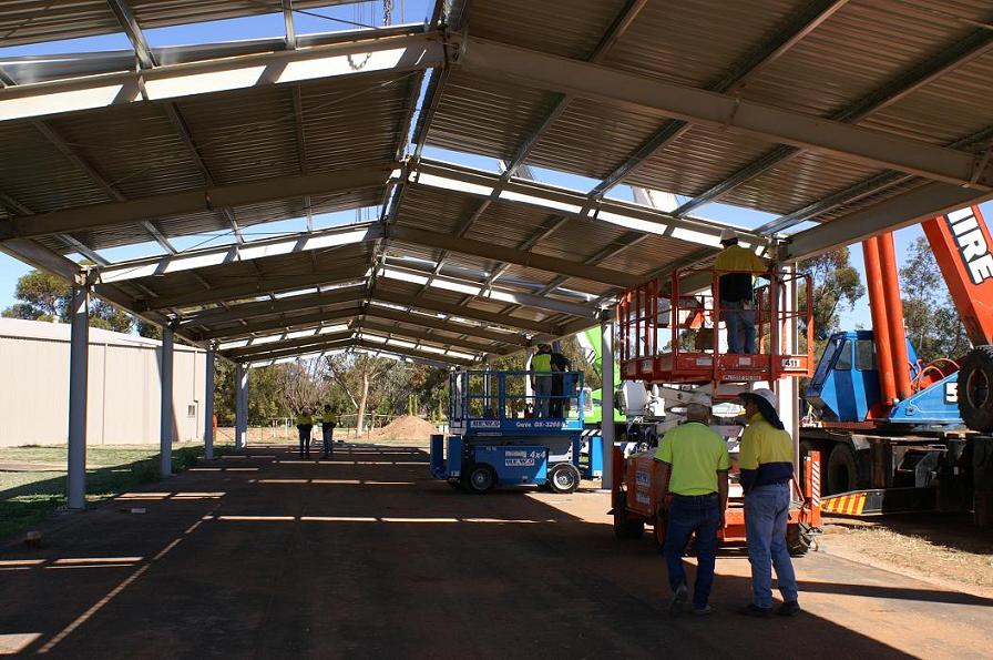

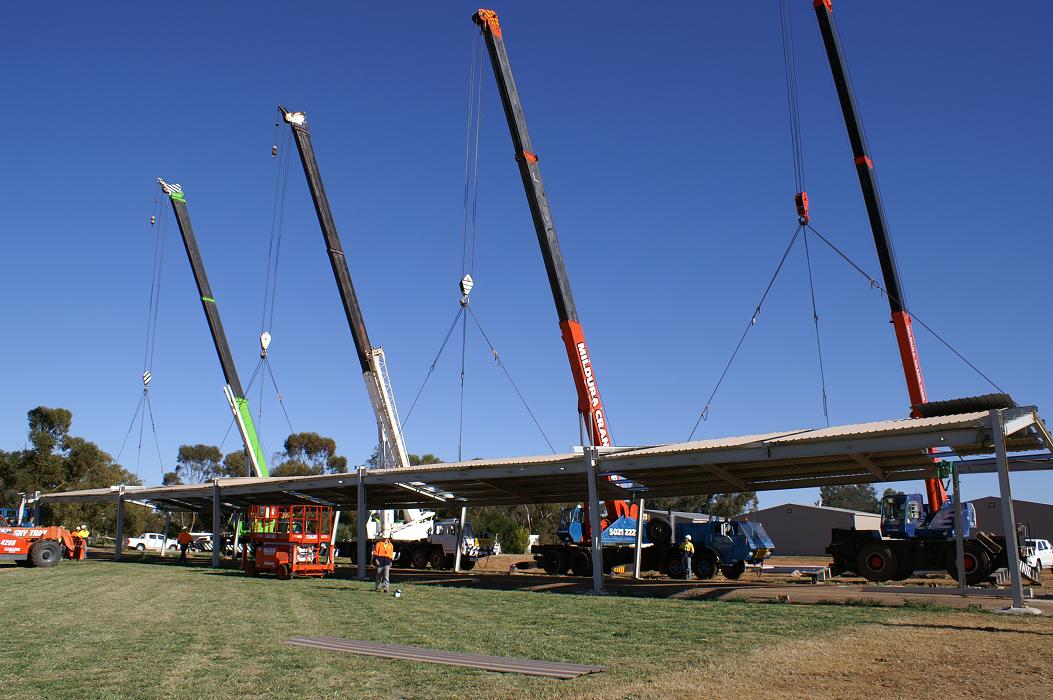

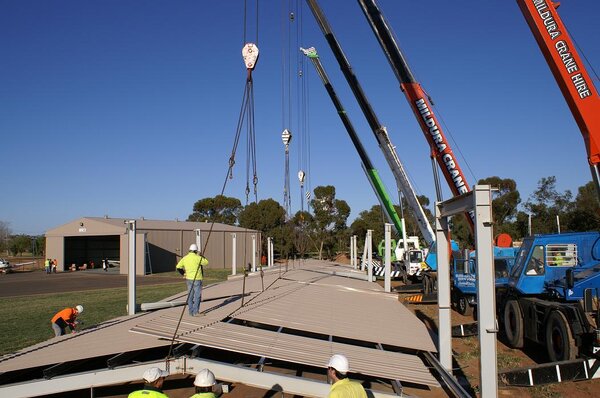

Geoff Posted September 26, 2007 Posted September 26, 2007 Hanger I though I might put a few pic,s of a new Hanger in Mildura it’s a bit different The post’s in the bays are off set so the plane’s go in the same as Ian’s first Drawing. Holds 10 aircraft with room to spare. This hanger has been built and put up buy volunteers of the Mildura Sport Aviation Club.

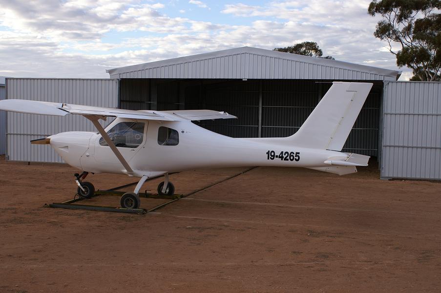

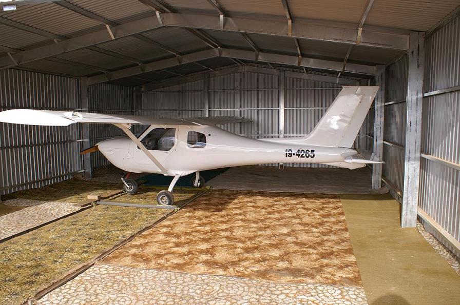

Geoff Posted September 26, 2007 Posted September 26, 2007 Hanger And this is how I did my own Cost $5000 all up;););)

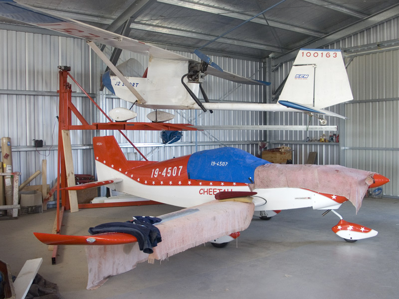

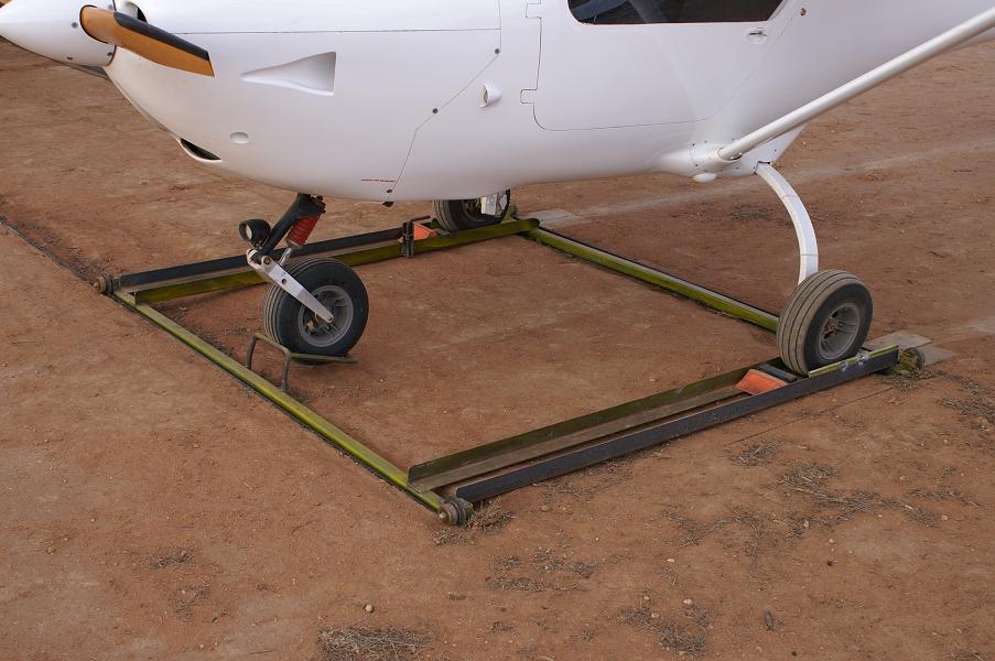

slartibartfast Posted October 29, 2007 Posted October 29, 2007 Garry has finished the prototype plane stacker. It seems like a great way to utilize that spare space above your plane. He thinks a block and tackle with chain would be better than electric. Easy enough to do. This one has the tail-dragger extension fitted. [ATTACH]4171.vB[/ATTACH]
