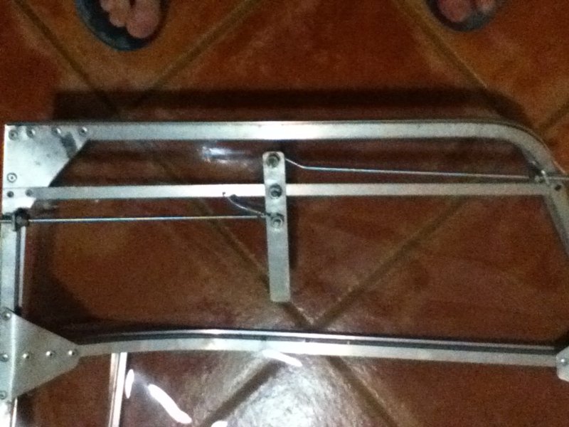

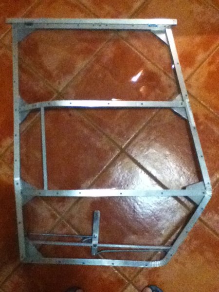

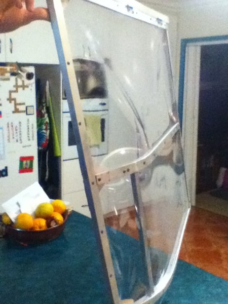

Have been working on doors for the T500. Frames were made by The Baron. I've covered with clear PVC and attached with riveted angle and flat.
Latch is spring loaded in the locked position.
