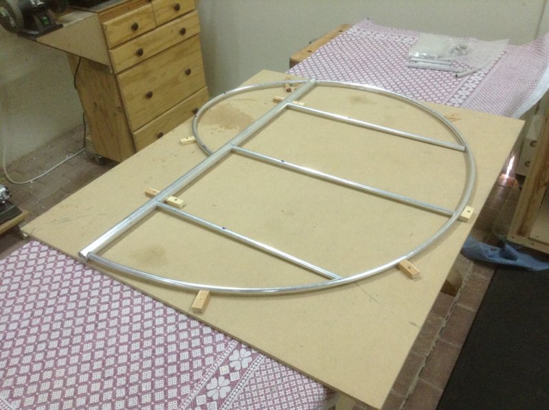

I've just started a 75% Fokker Dr1 with a fellow enthusiast (ex-RAAF test pilot and multiple builder). The plans are pretty basic but adequate so far (we've only got the empennage "kit"). If you look at his YouTube videos that show his construction techniques, you may cringe a little. His techniques are not always in accordance with common practices. Also, his plans are not "exact". Dimensions can be "close enough" rather than exact.
We are also doing some modifications to the construction along the way that we feel will provide a more sound structure. In places, he has pop rivets in tension, rather than shear so the pop rivets are just waiting to be pulled out... etc.
Here's our rudder after a few hours (Robert Baslee only takes around one hour to do what we did in 3 hours, but we were somewhat pedantic about our holes, alignment, deburring, radiusing ends etc..
Anyway, construction is very easy and straightforward, indeed, is quite enjoyable, especially when there are two of you on the job.

I've just started a 75% Fokker Dr1 with a fellow enthusiast (ex-RAAF test pilot and multiple builder). The plans are pretty basic but adequate so far (we've only got the empennage "kit"). If you look at his YouTube videos that show his construction techniques, you may cringe a little. His techniques are not always in accordance with common practices. Also, his plans are not "exact". Dimensions can be "close enough" rather than exact.We are also doing some modifications to the construction along the way that we feel will provide a more sound structure. In places, he has pop rivets in tension, rather than shear so the pop rivets are just waiting to be pulled out... etc.
[ATTACH=full]31787[/ATTACH]
Unfortunately, unless you are passing through the Middle East, you won't be able to view our project...

We are building from one of Baslee's "kits". The kit simply consists of aluminium tubing cut to approximate length. Each tube is identified with a sticker which is referred to in the plans. The aluminium sheet gussets are cut to shape and the hinges are included. So the "kit" is quite complete, but at first glance will appear to be a pile of raw materials.
An example of the "approximate" ethos is with the shape of the rudder bow. Baslee gives a rough sketch and says close enough is ok, it doesn't have to be an exact shape. In this sense, it makes things a little easier for you as the builder. Also, the ribs that you can see on my rudder above can be moved up or down from their planned location with no detriment to the structure, so he says that there's no need to measure to the .1mm to position the ribs.
As a first time builder with low or no construction experience, you will pick up the skills very quickly to be able to build one of Baslee's kits. It is measuring, marking, sawing, filing, drilling, deburring, bending, assembling, checking for fit, etc.. You will find the construction technique easy after you have built the rudder to start with.
The advice I would give would be to spend a day or two with someone who is building one of these aircraft and lend a hand. It will give you some experience and confidence to tackle your own kit.
