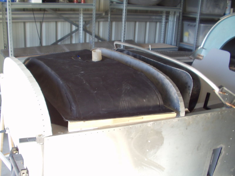

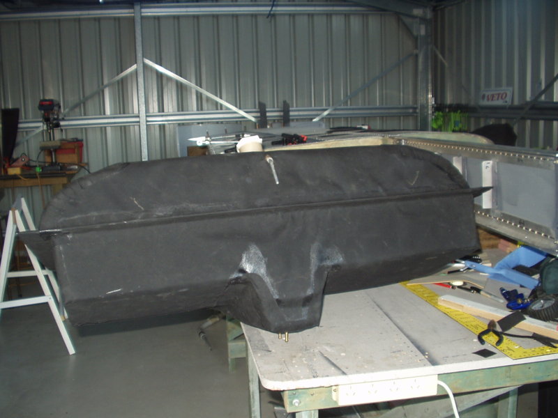

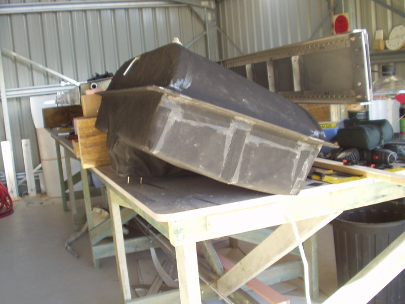

I cut the hypalon so it would wrap around in one piece and the main
seam is at the back. The sides are cut to fit and glued to the tank. All seams then had an additional piece glued on top. The Hypalon is glued to the tank at the outlets and fuel gauge sender.
The glue is not forgiving once the 2 pieces touch and cannot be separated so you end up with a few wrinkles.
Here are some pics.
