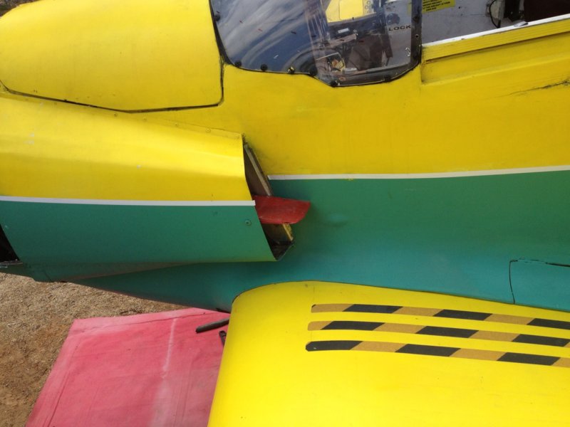

Garry Morgan Posted November 25, 2014 Posted November 25, 2014 I have been using jab motors now for 10 years and I don't have any conplants nor have i had any failers. I didn't follow the installation manual as i feel it will make your motor run hot. we use our own set up and the motors run very cool. For me they are the best motor around and you can afford the parts if needed. All motors have there own problems, 1 2 2
bexrbetter Posted November 25, 2014 Posted November 25, 2014 I have been using jab motors now for 10 years and I don't have any conplaints nor have i had any failures. I didn't follow the installation manual as I feel it will make your motor run hot. So "no complaints" except for the complaint, got it. Maybe you could share what your "anti-motor run hot" procedure is please? I know one guy who extracts the engine bay air from directly behind the Jab engine rather than a torturous exit path in an aim to help cooling for example. 1
Old Koreelah Posted November 25, 2014 Posted November 25, 2014 ...I know one guy who extracts the engine bay air from directly behind the Jab engine rather than a torturous exit path in an aim to help cooling for example. It's easy with a low-wing; exit in the low-pressure area above the wing LE.
bexrbetter Posted November 25, 2014 Posted November 25, 2014 It's easy with a low-wing; exit in the low-pressure area above the wing LE. Was a high wing but similar idea.
Garry Morgan Posted November 25, 2014 Posted November 25, 2014 Most of the problems are they just running to hot, I have used my own set up for the last 10 years. I looked at the instal manual and put it in the bin. If you follow the manual your motor will run hot .You have to get the air running smoothly through the system. The piece of fibreglass sitting in front of the cylinder blocking the air from getting to the bottom of the cylinder is just one of the problems, this will brake the air and cause turbulence, this will slow the air flow. We make our own front piece of duct and ramp the air into the duct. the smother the air flow the more air you will get over the motor.We put the oil cooler at the bottom of the fire wall. You still need a 2-3"hole at the top of the sump, this makes 20 deg. difference. The oil cooler robes air that could be used to go over the cylinder heads . now you have lots of air going much faster, lots more cooling. The carb air intack we use our own cobra head with a air straightener to even up the cylinder temperature, and you can move the rear of the straightneer to change left and right bank of cyl temp. also lowering the bottom of the cowl makes more suction. so there you have it its not hard. Bingle book on fire wall forward is a good book on how to do this also. no one using our set up has had an engine problem so far . 9 5 2
geoffreywh Posted November 26, 2014 Posted November 26, 2014 all the 24 - reg types will look at that installation with envy.................. 1
bexrbetter Posted November 26, 2014 Posted November 26, 2014 Most of the problems are they just running to hot,.......... Thanks for taking the time Garry.
